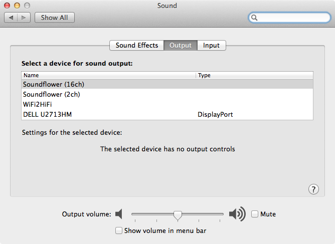

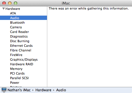

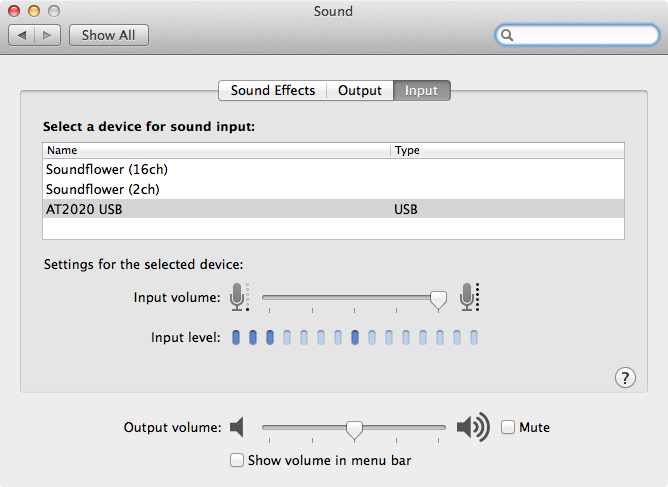

So this is nuts. The other day I was watching a movie. It is important to note that the volume was only about ⅓ the max volume. Suddenly my iMac (2011) made a loud (louder than the volume was set) sound that was like a giant rubber band being plucked. A few catastrophic thing happened immediately after this event: the internal speakers stopped working, the internal mic stopping working, and the headphone port stopping working. When I visit System Preferences > Sound, I have NO options for the internal speakers or mic. I have tried at least 371 suggested procedures that I found online. None of them worked. I'm hoping someone can help me based on my rather unique situation (I haven't found anyone online with an identical problem).
I disconnected everything and got the same result. I restarted my computer also with everything disconnected and still got the same result.
Does this sound like hardware failure to you?
It's software that lets you record audio being played from the system. I used it to record audio while I recorded the Xcode simulator. That was a long time ago, so I'm no longer familiar with it, but it has been on my mac for a very long time and never caused a problem.
If you have a hardware diagnostics boot disk, you could try that. Or get the machine to Apple and they can try that.
If the third party stuff was connected via USB, then maybe one or more USB ports are fried.
There is only a slim chance that it's software; this could be tested by booting from a different, known good drive.
Well, everything connected via USB is working fine. I'm beginning to believe this is not software... sadly as I think that would be the easiest fix.
I'll see what I can do to inspect hardware some more. I was inside my iMac yesterday, but couldn't do anything worthwhile. Unless someone provides the winning information within the next few days, I'll probably haul this iMac to a Genius Bar.
