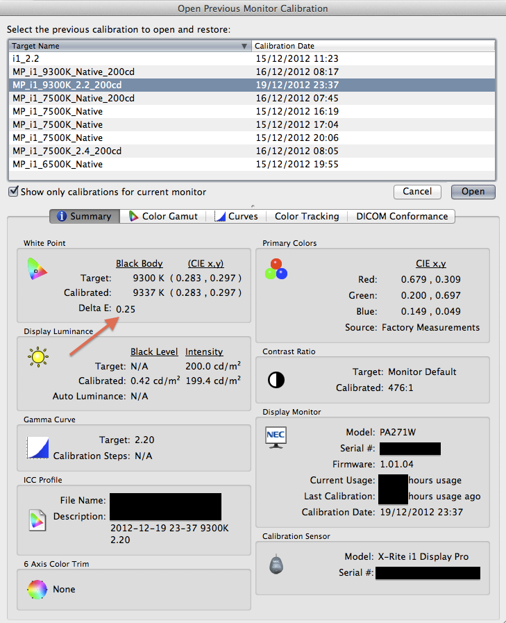

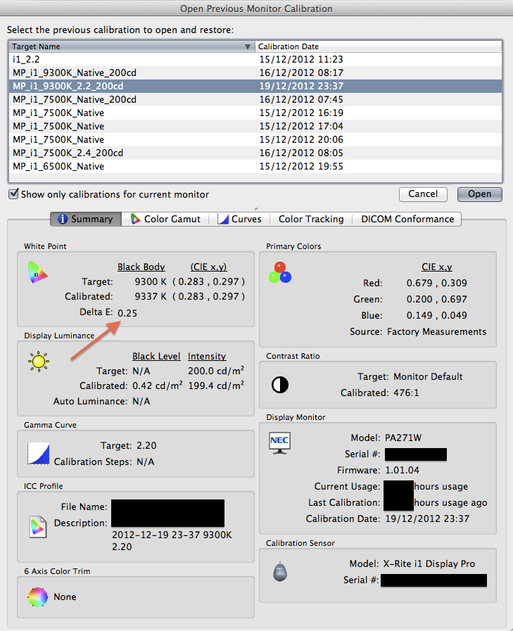

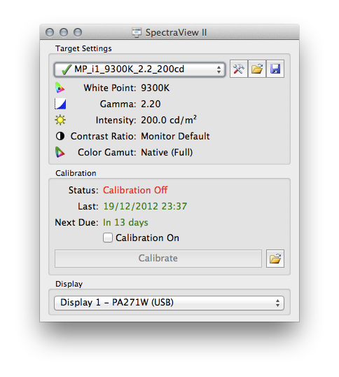

For whatever reason, NEC don't sell their SV bundled version here in France. So I have the regular (PA271W-BK) monitor, coupled with the US software version (SpectraView II) and the X-rite EyeOne Display Pro calibrator (which I had to buy separately).

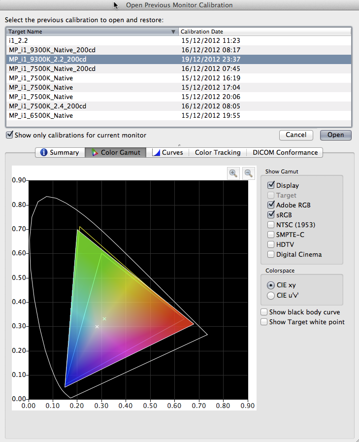

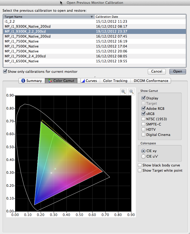

This calibrator plus the US version software gave me extremely pleasing results, with a Delta E mean value as low as 0.25 and a very large gamut coverage (see first two images - in the second picture, the two empty triangles figure AdobeRGB and sRGB color spaces respectively). Delta E is a measure of color accuracy: between 5 and 3 - very good; between 3 and 1 : excellent; any value under 1: exceptional (see the fourth image).

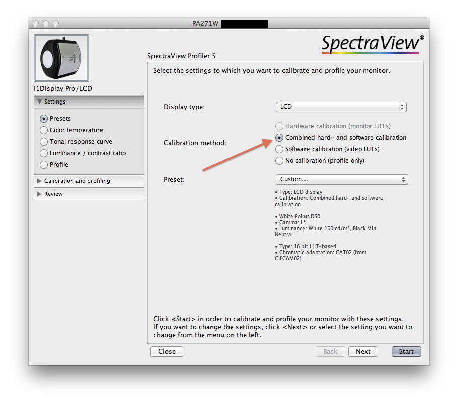

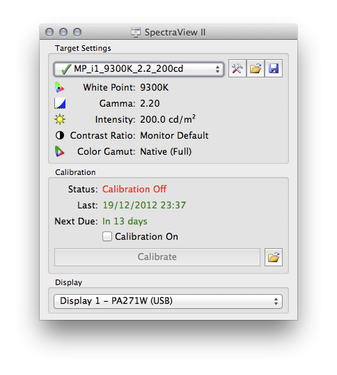

The regular version monitor which I have still can be calibrated at hardware level, but not totally - and that, be it either with US or European software version (the former is called SpectraView II and the latter, SpectraView Profiler).
Why not totally? Because the bundled SV version display firmware allows total communication at hardware level between the computer and the display, which the regular version (non-SV) display firmware is not capable of. Yes, the regular version of the monitor does have a different firmware. In which extent is it still supporting calibration at hardware level? Only NEC knows. But definitely it does it in a certain extent.
I have tried the demo version of the European software (SpectraView Profiler), and I am quite positive: same final calibration quality in my configuration (see third image). So I finally stuck with the US version.
As a final word given here on the basis of being involved in the worst case scenario (the most heteroclite hardware+software combination): I'd say that whichever version of the display one might have (SV or regular), calibrated with a decent calibrator by means of whatever latest NEC software version, one obtain very high level final results with this monitor.
