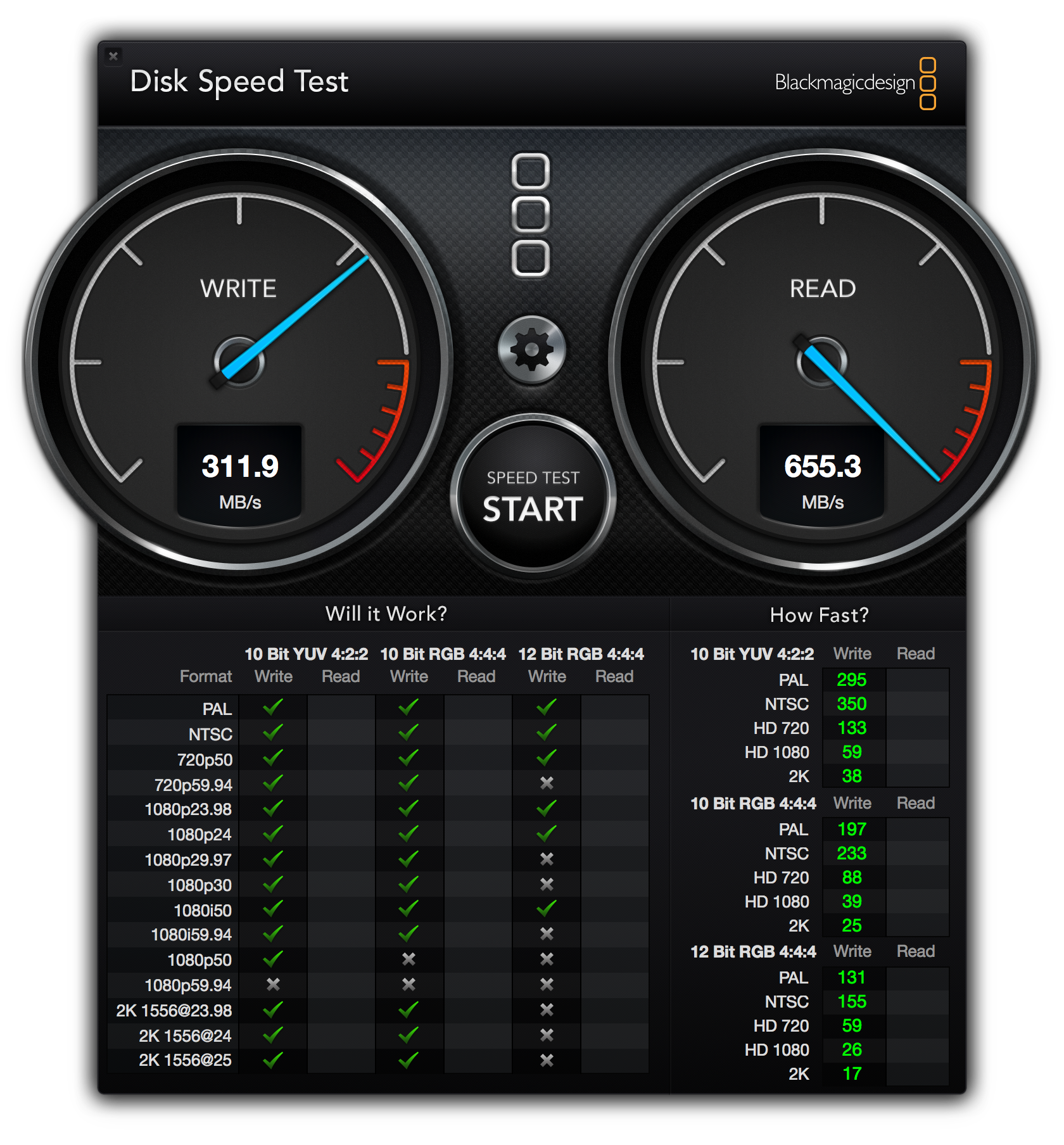

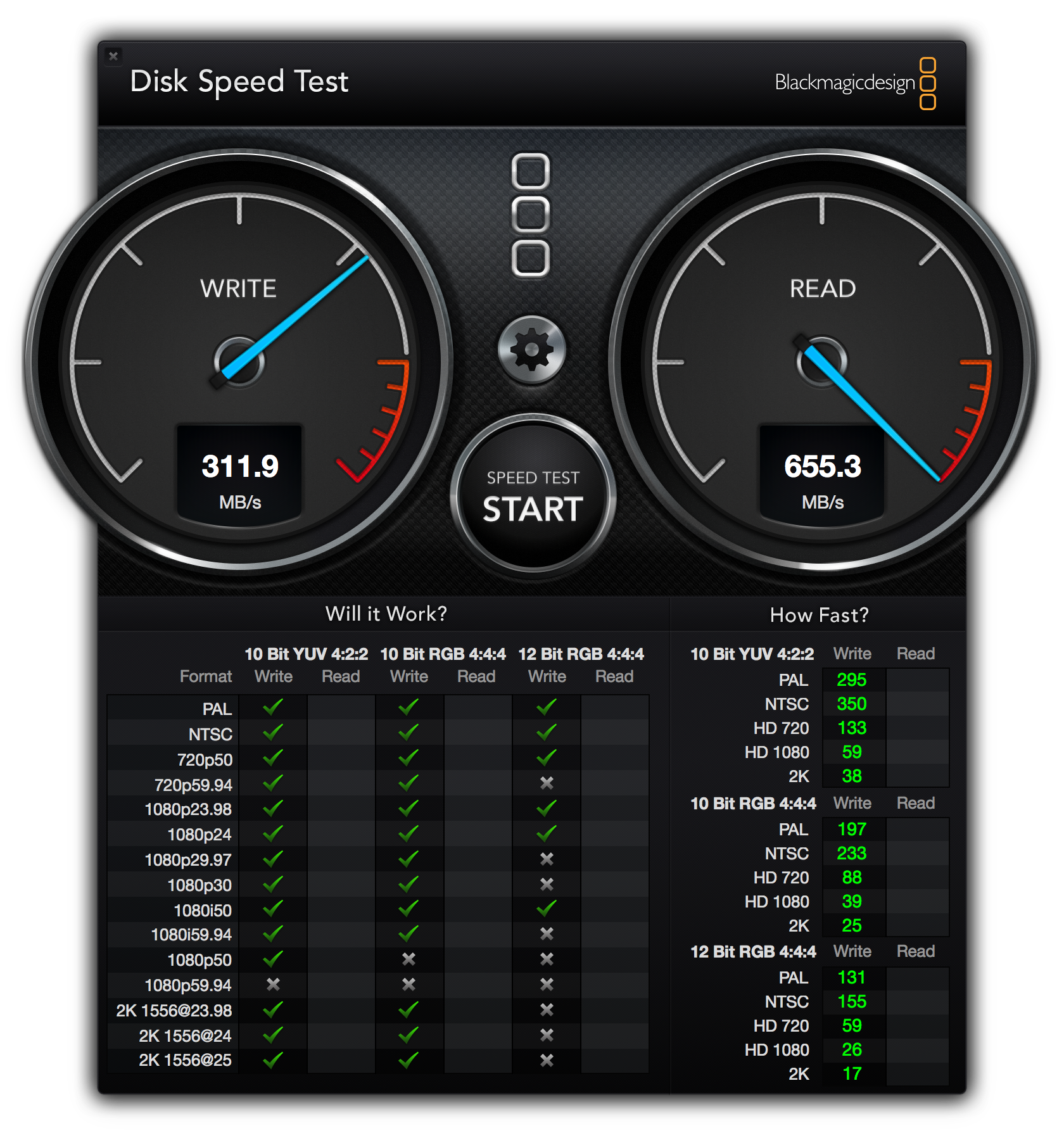

On my top-spec 2013 iMac with about 50% full 3TB FD, BlackMagic 2.2 gives about 300 MB/sec write, 650 MB/sec read. However it is quite variable.
