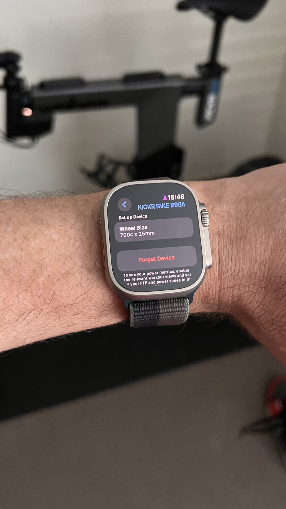

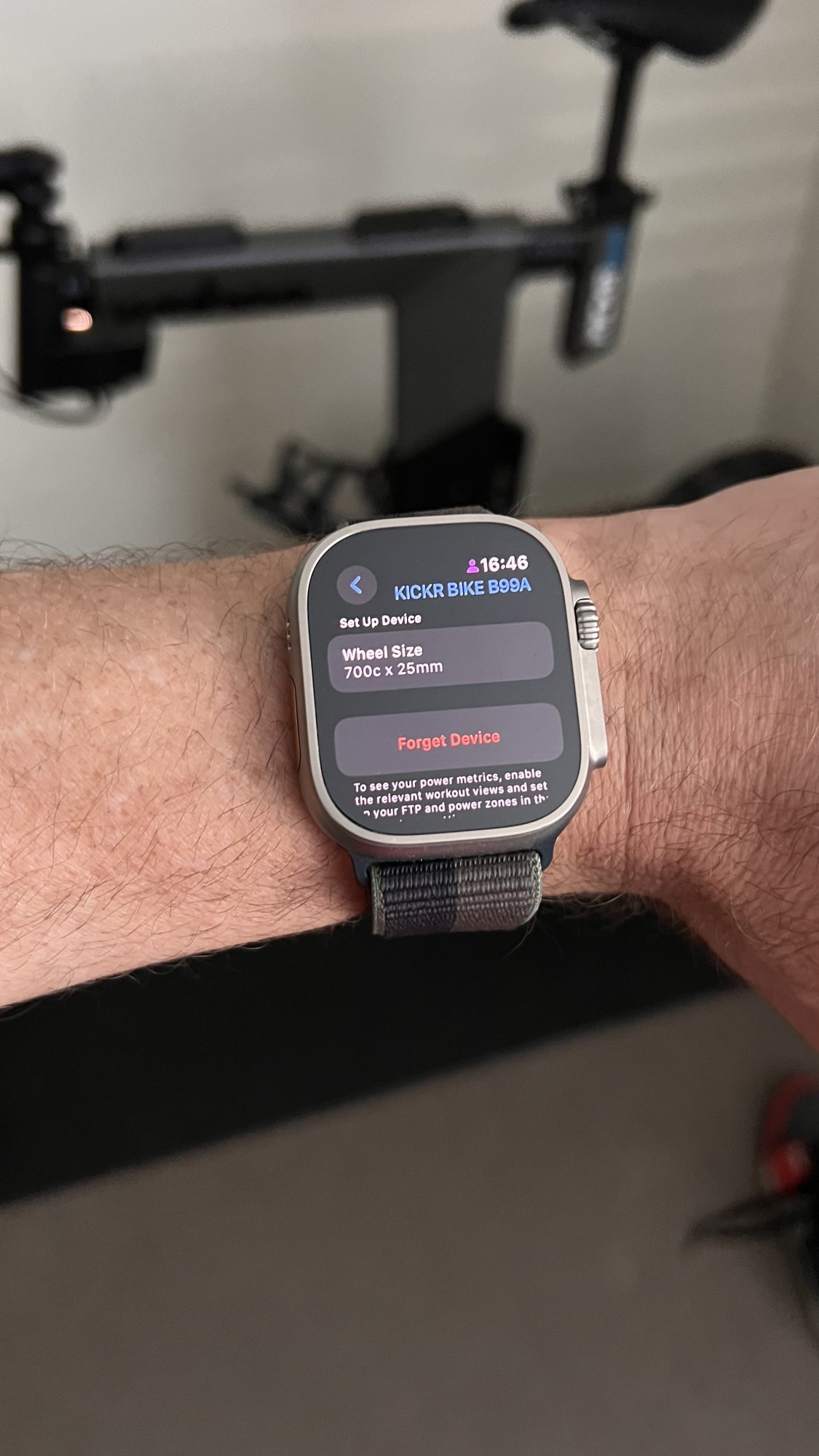

Wheel size should be in the Bluetooth settings; click the blue "i" information symbol next to the paired device:
I had tried that and was not seeing any options. I tried again and it looks like the sensor needs to be actively connected not just paired to see the settings. So I was now able to set it. Though they are still missing a ton of tire widths. Nothing tween 2.25 and 2.5. Many MTB tires are 2.35 and 2.4. Whatever. Close enough. Or I will just use work outdoors. Thanks.

You can either set the tire width and diameter or enter the circumference in mm.
On your wheel using chalk mark a line on the tire and onto the ground. Do a full rotation and mark on the ground again. Measure the distance. Enter the circumference
