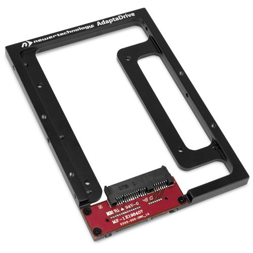

I put a SSD inside my 2017 27" iMac and it was relatively easy. I followed the steps on this site, and purchased (from the same site) a kit to install the SSD. I'd also recommend you upgrade the RAM, both make my 2010 iMac almost as fast (loading times) as my new 2019 fusion drive iMac.

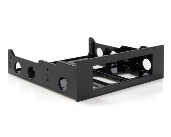

Would this work?

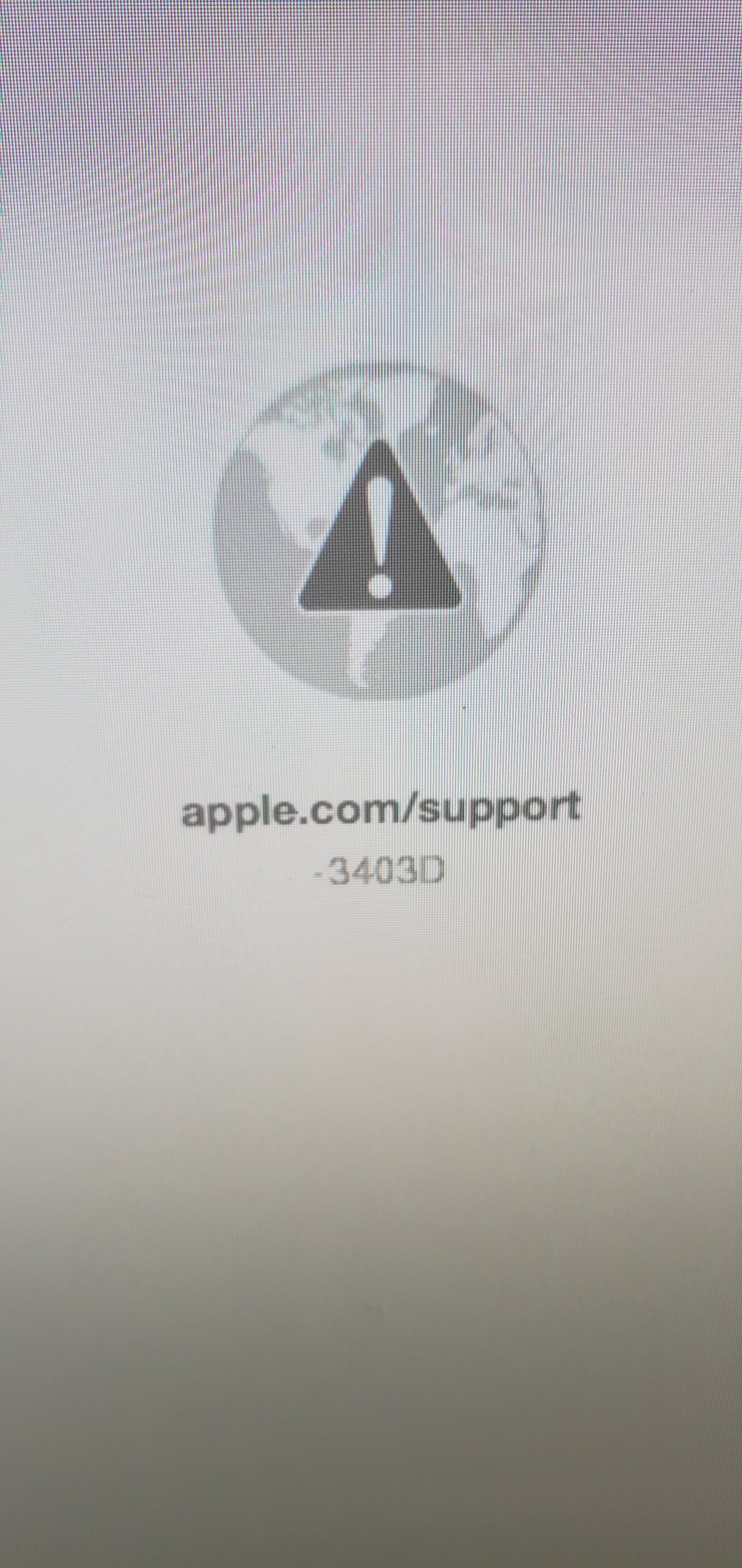

The imac loads up I login and then immediately turns it self off.

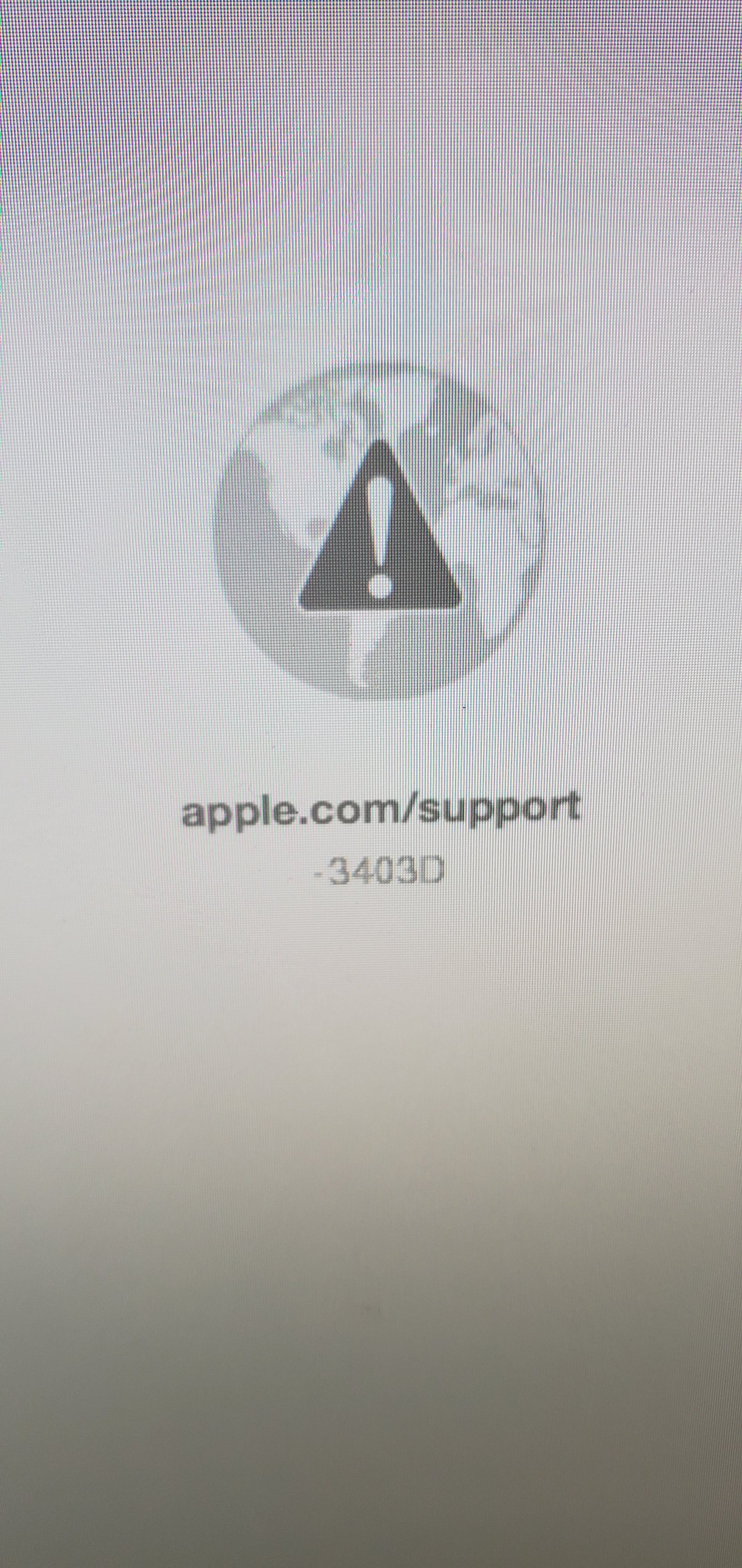

Tried apple recovery and I am getting this error.

You probably don't have an internet connection. Go to the top right of the screen and select a wifi network.
To answer your original question, just replace the internal drive with a SSD, it is really easy on the particular model and then add additional RAM. With the screenshot you posted, you didn't give any valuable information that could help you. What did you do prior to this problem happening? Has this always happened? Help us help you.

Would this work?
Not the one you want. Use this instead.
https://www.amazon.com/Fenlink-Internal-Hard-Drive-Converter/dp/B01ELRRKW8/ref=sr_1_4?crid=2WDJE95RSRP2I&keywords=3.5+to+2.5+adapter+hard+drive&qid=1565683584&s=gateway&sprefix=3.5+to+2.5,aps,248&sr=8-4

This is the style adapter you want. Brand does not matter as long as it's similar to this. $10–$15
