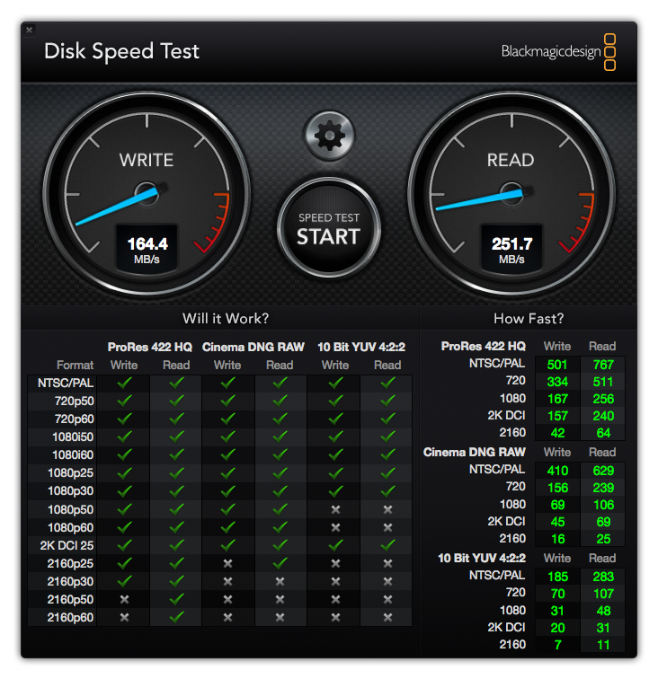

LOL I just did a speed test on my internally mounted 240 GB Kingston SSD in my 2010 MBP, 6GB RAM and a 2.53 GHz Intel Core i5. This is terrible LOL! I was considering removing it from the MBP and using it in the enclosure for the iMac in question.
Are these speeds due to the old hardware the drive it mounted to?
It might be worth going to System Profiler and checking what your negotiated SATA link speeds are to the SSD.
heres what system info says.....
Vendor: Intel
Product: 5 Series Chipset
Link Speed: 3 Gigabit
Negotiated Link Speed: 3 Gigabit
Physical Interconnect: SATA
Description: AHCI Version 1.30 Supported
KINGSTON SUV400S37240G:
Capacity: 240.06 GB (240,057,409,536 bytes)
Model: KINGSTON SUV400S37240G
Revision: 0C3FD6SD
Native Command Queuing: Yes
Queue Depth: 32
Removable Media: No
Detachable Drive: No
BSD Name: disk0
Medium Type: Solid State
TRIM Support: No
Partition Map Type: GPT (GUID Partition Table)
S.M.A.R.T. status: Verified
oh well.
I actually think I'm gonna go ahead and internally mount the SSD. Ive been watching the videos and they actually don't seem too bad. Bought the resealing adhesive kit for $9.99.
The write speed looks a bit low even for SATA II, but the read speed isn't all that far off. You might possibly try booting from the recovery partition and doing a filesystem verify/repair on the internal SSD.

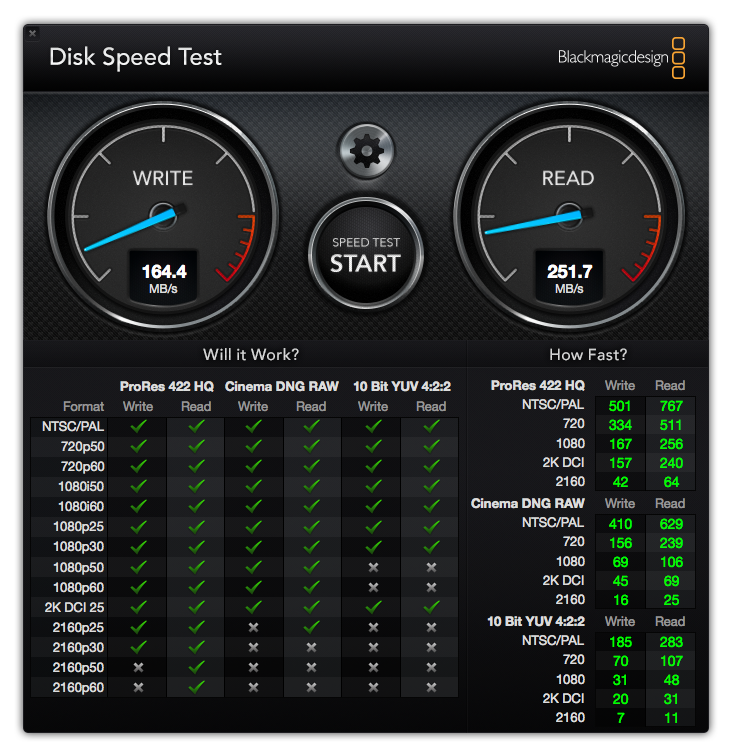

I have this SSD:
Samsung SSD 750 EVO 500GB
I have this USB 3.0 enclosure:
Inateck 2.5 Inch USB 3.0 Hard Drive Disk Enclosure/ Case for 9.5mm 7mm 2.5 Inch SATA I/II/III/HDD/SSD, Support UASP and Optimized For SSD, Tool-Free
and it runs faster than a new version of anything by Microsoft needing to be patched:
You can also max out the SATA 3 performance bottleneck (is that even right lol?) of your drive if you go for a thunderbolt enclosure instead, but those cost more money. Personally I think these speeds are great with the Inateck!
