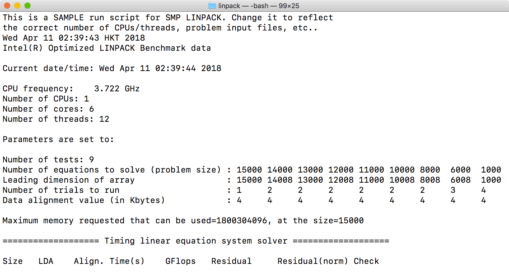

Use Linpack

That looks like the software sampled the low power state right at that moment. This software should capture the clock right at that moment.
Every single time you run Linpack report the same low speed?
If the software can’t capture the high clock speed. You may run something (e.g. YES command in terminal) to stress one thread and then run Linpack again.
P.S. once the CPU clock is reported, you can abort the test and start again.
