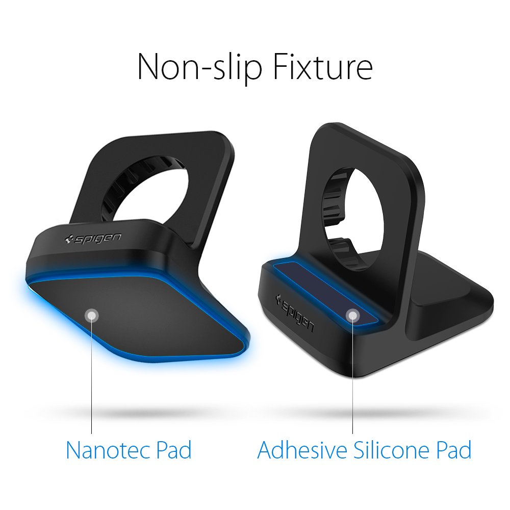

Do you have the silicon pad attached? This is meant for 38mm watches. It tends to work fine with 42mm, but I noticed I had issued with my new SS S4 44mm. I removed the rubber sticker and it works perfectly fine.
