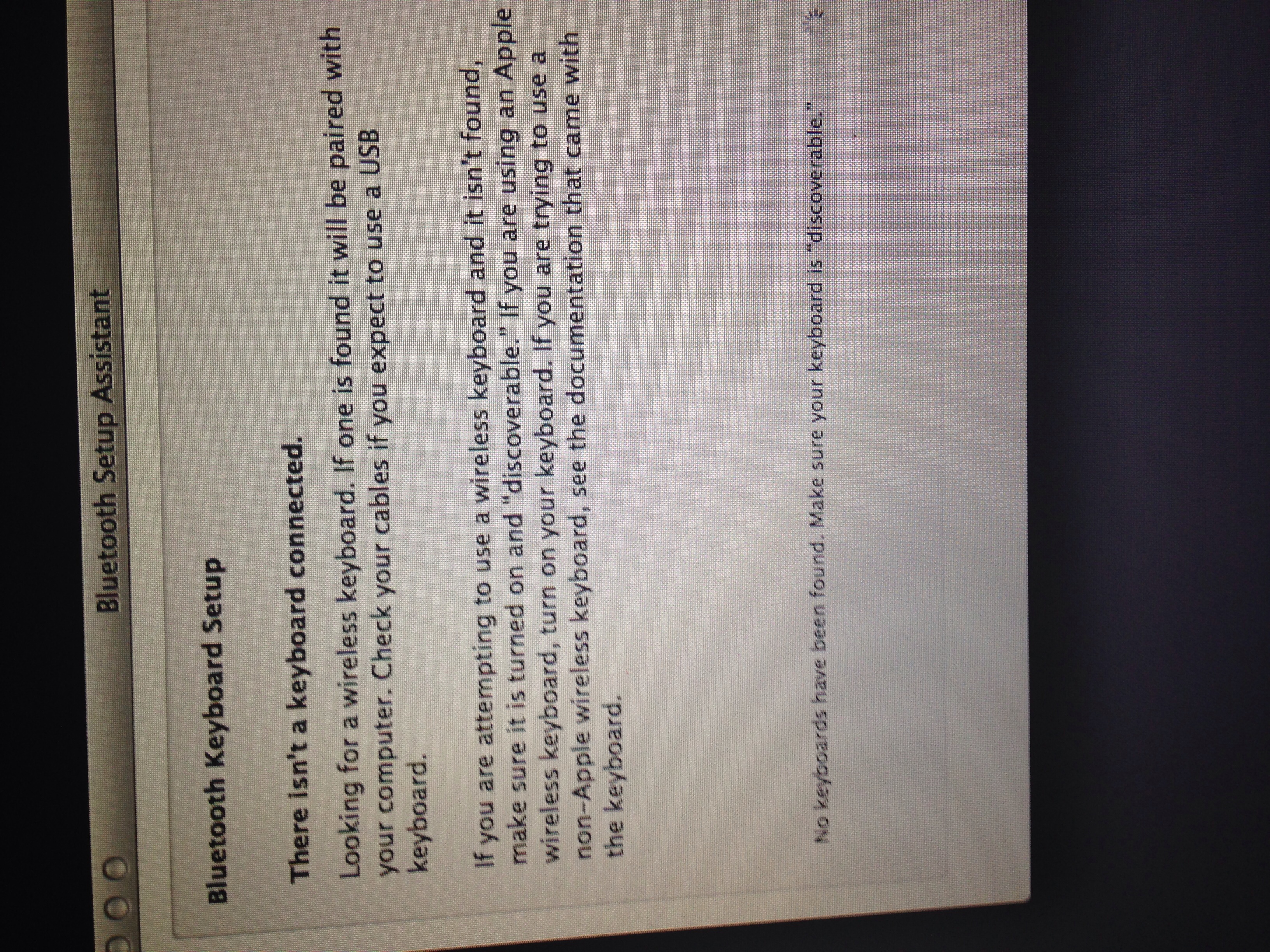

Greetings,
I have a 13' MBA, last night while I was streaming video on it I spilled literally two drops of wine on the edge of the track pad and under the space bar, which I quickly cleaned up and kept streaming my video like normal. By the end of the clip however I couldn't use the esc key to minimize the screen, nor apple q command. The mouse and trackpad didn't work either. I finally powered down by pressing and holding power for 4 seconds. The next day I was able to power on and off with the power key and go to the normal log in screen. There I get the message that no keyboard is detected and if I have a Bluetooth or USB keyboard to make sure it's on discoverable. From there I can only press and hold power to power down as there is no function. Question is, how badly have I damaged my computer? If I pulled the SSD could I pull data from it? Since it powers normally is it a simple fix. I own the tools to open it, but won't be able to do it for 10 days as I am traveling abroad. Please advice anyone?!

Looks like the liquid shorted something out and your best option is perhaps get a usb keyboard for the time being.
I think the issue is that you kept using it after spilling the liquid which then caused the problem. Powering it off and drying it out is generally the best approach.
Your SSD is almost certainly not affected. If a USB keyboard works, then I'd boot it up and backup your data to be safe. Something probably shorted in there by running the machine. It only takes a drop of liquid on the board while electricity is going through it to short the board in that spot.

On the bottom side of the trackpad is a pcb board that holds both USB controllers for the track pad and keyboard. It would be at the very top of the track pad and yes indeed a few drops if they fell onto the ribbon cable could take out one or the other as the water would run right into the cable connector using that cable as a guide sort of speaking
If not under warranty, you could always open it up and replace the trackpad, ebay $50 +/-
Be sure to purchase the right 13" year model as the keyboard layouts have changed from year to year, if you get the wrong one, many of your top functions keys will not match the actions as the keyboard key assignment logic IS stored on that pcb attached to the trackpad.
I wager simply replacing the trackpad will take care of the problem. 😉
You could open in up and try to reseat the ribbon cables. You will find two attached directly to the trackpad and the attached pcb and there is one other very narrow ribbon that goes to the logicboard.
you will also need a 000 Philips screwdriver and a T6 for the click travel adjustment screw.
