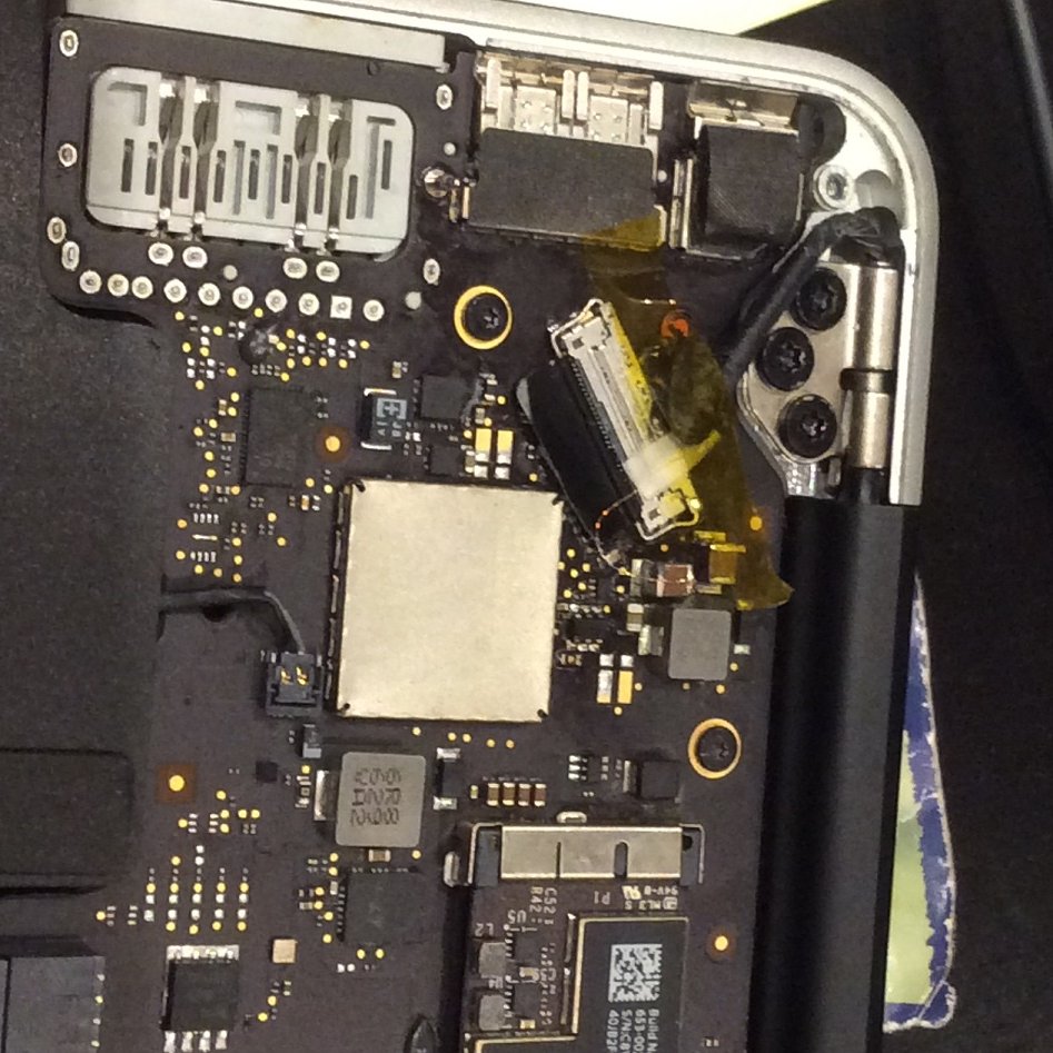

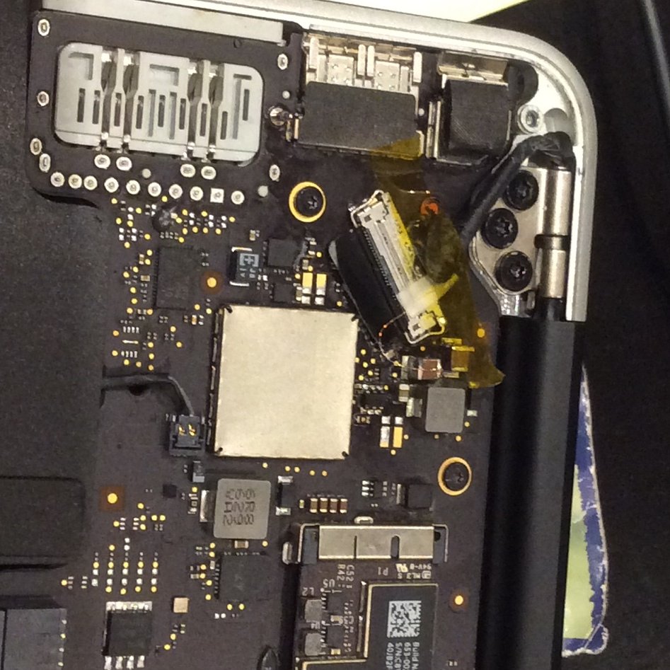

I bought a very cheap, mint looking, liquid damaged early 2015 Macbook Air. It was the lvds cable and motherboard connector that were damaged, along with some other blown fuses and capacitors on the logic board. Wasn't a cheap repair but worth it because the person that repaired it has repaired several computers for me in the past. The cost of repairs was less than a third of the cost of a new unit.

I attached a picture of the repair to my MBA's LVDS cable and connector. The picture shows only 1 tiny copper cable when there are, in fact, two tiny copper cables soldered between the connected to logic board.
There were some other capacitors and/or resistors replaced too.
