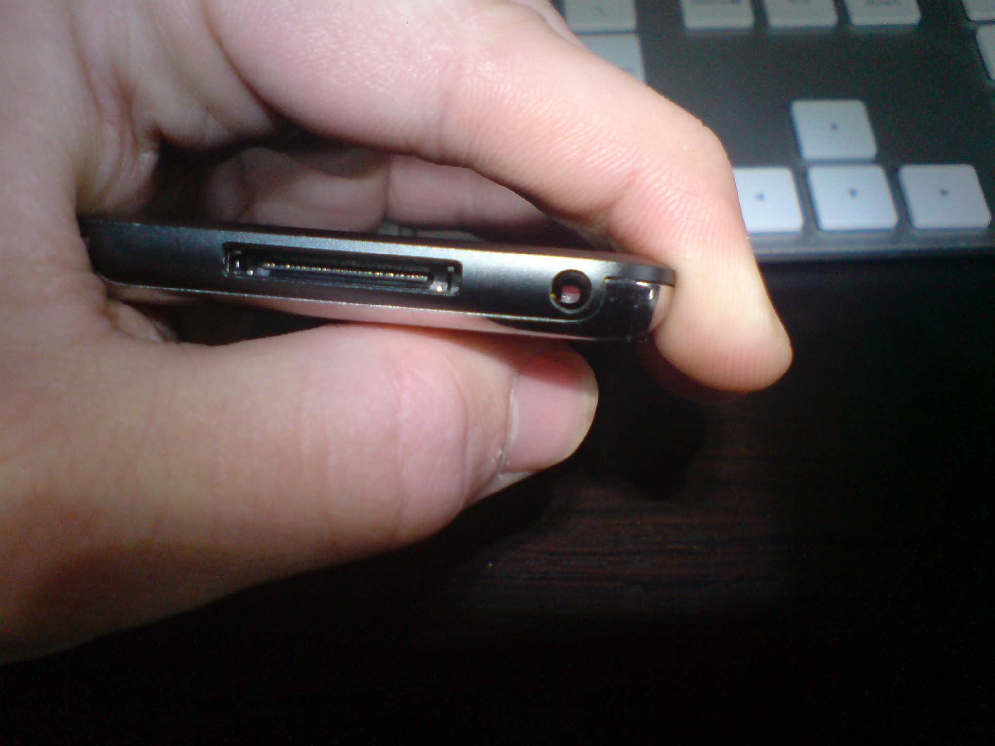

Wetness Indicator
Jasonbot is right. Here's a snap of my spoiled indicator. Maybe instead it means that my iPod is pregnant and will pop out a new one soon. Perhaps I won't have to plunk down another $400 to replace it 😀
