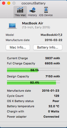

I have spilled MacBook Air 13 2015 with beer. I have disassembled it and cleaned it with cleaner and alcohol. There are no visible damages on boards.
It doesn't work without charger. However it sees battery. When it works with charger red light is on (not green).
Here is some info from About This Mac:
Battery Information:
Model Information:
Serial Number: C016053025YF90MBY
Manufacturer: DP
Device Name: bq20z451
Pack Lot Code: 0
PCB Lot Code: 0
Firmware Version: 511
Hardware Revision: 000a
Cell Revision: 1200
Charge Information:
Charge Remaining (mAh): 3837
Fully Charged: No
Charging: No
Full Charge Capacity (mAh): 6605
Health Information:
Cycle Count: 129
Condition: Replace Now
Battery Installed: Yes
Amperage (mA): 0
Voltage (mV): 7785
And some screenshots:
What could it be? Is it possible that charge management chip is damaged?
