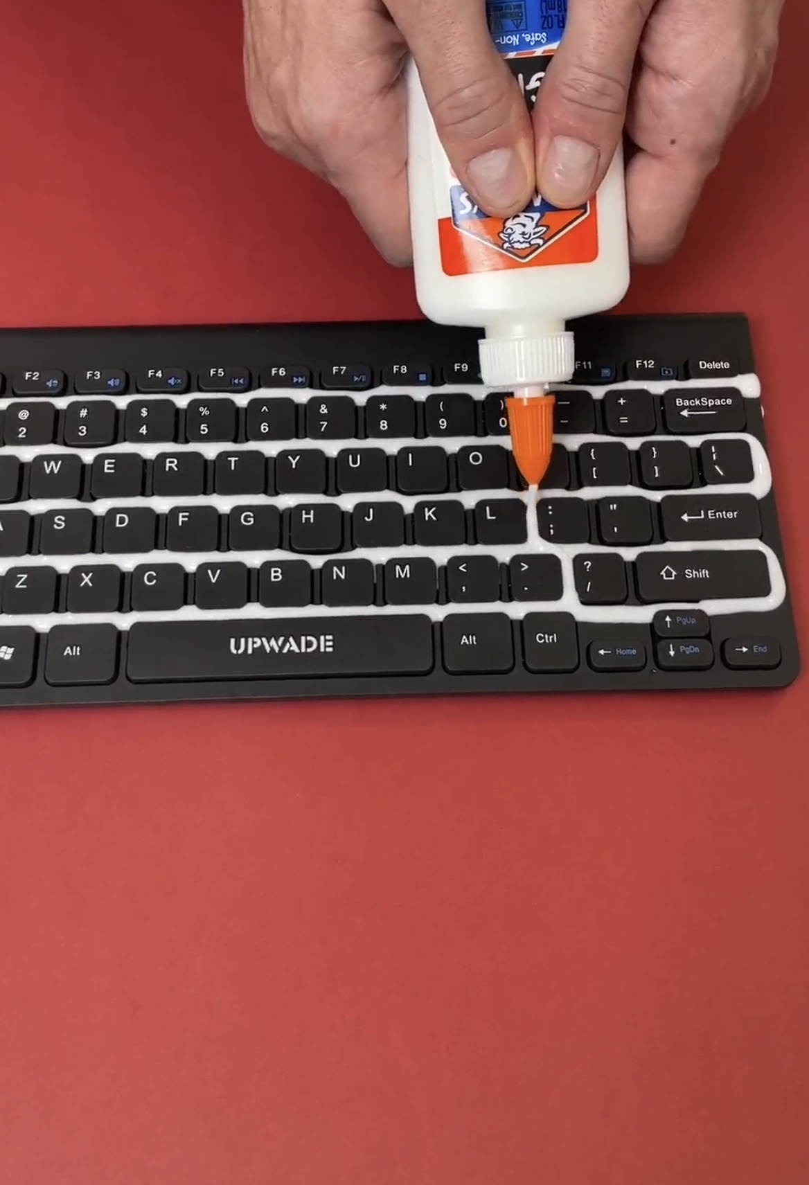

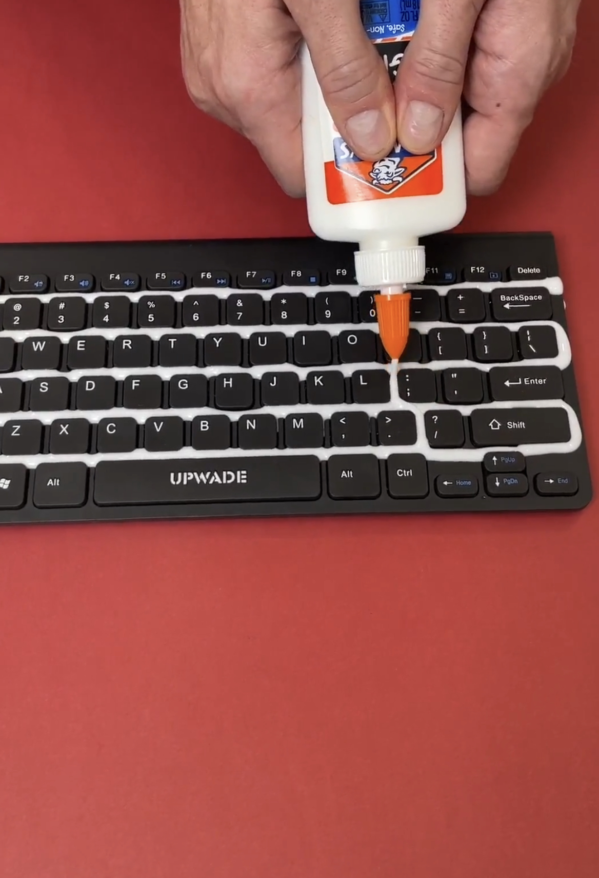

Could be worse, could be this guy who poured glue on his keyboard to stop crumbs going between the keys
  • Wow
Reactions: Apples n' Stone
