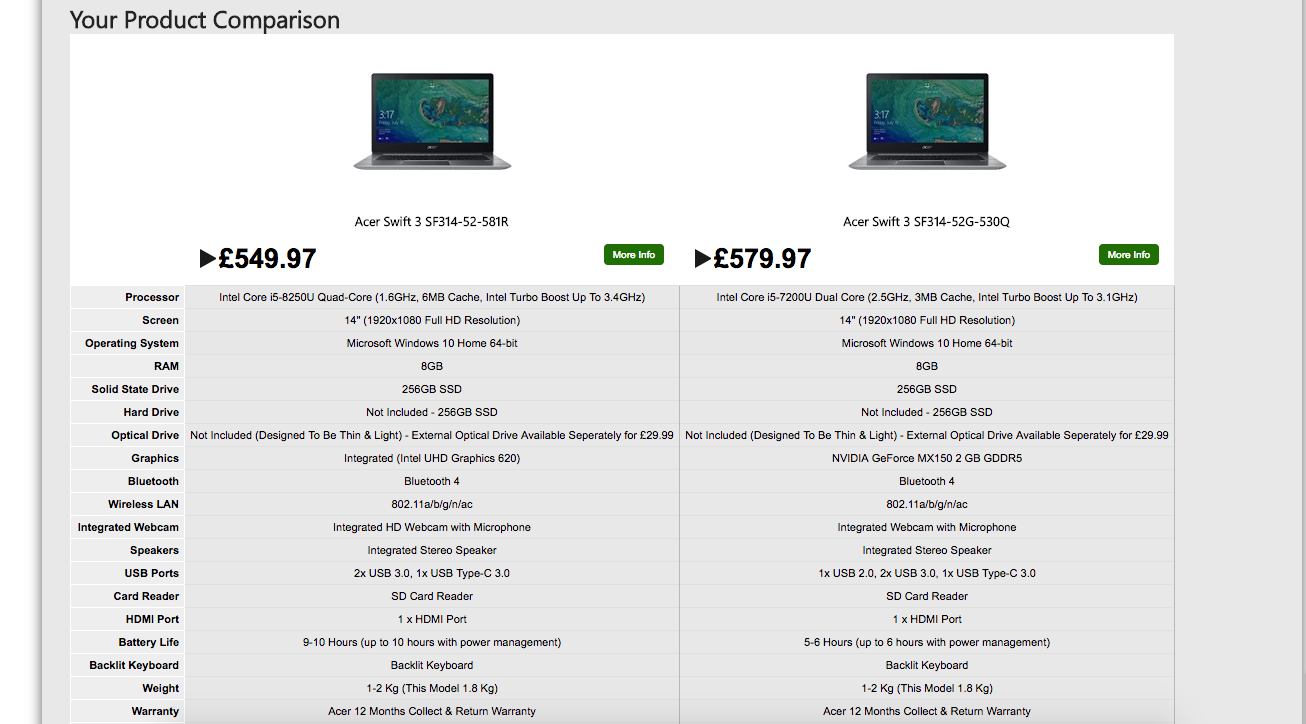

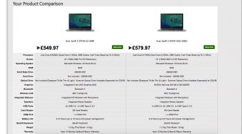

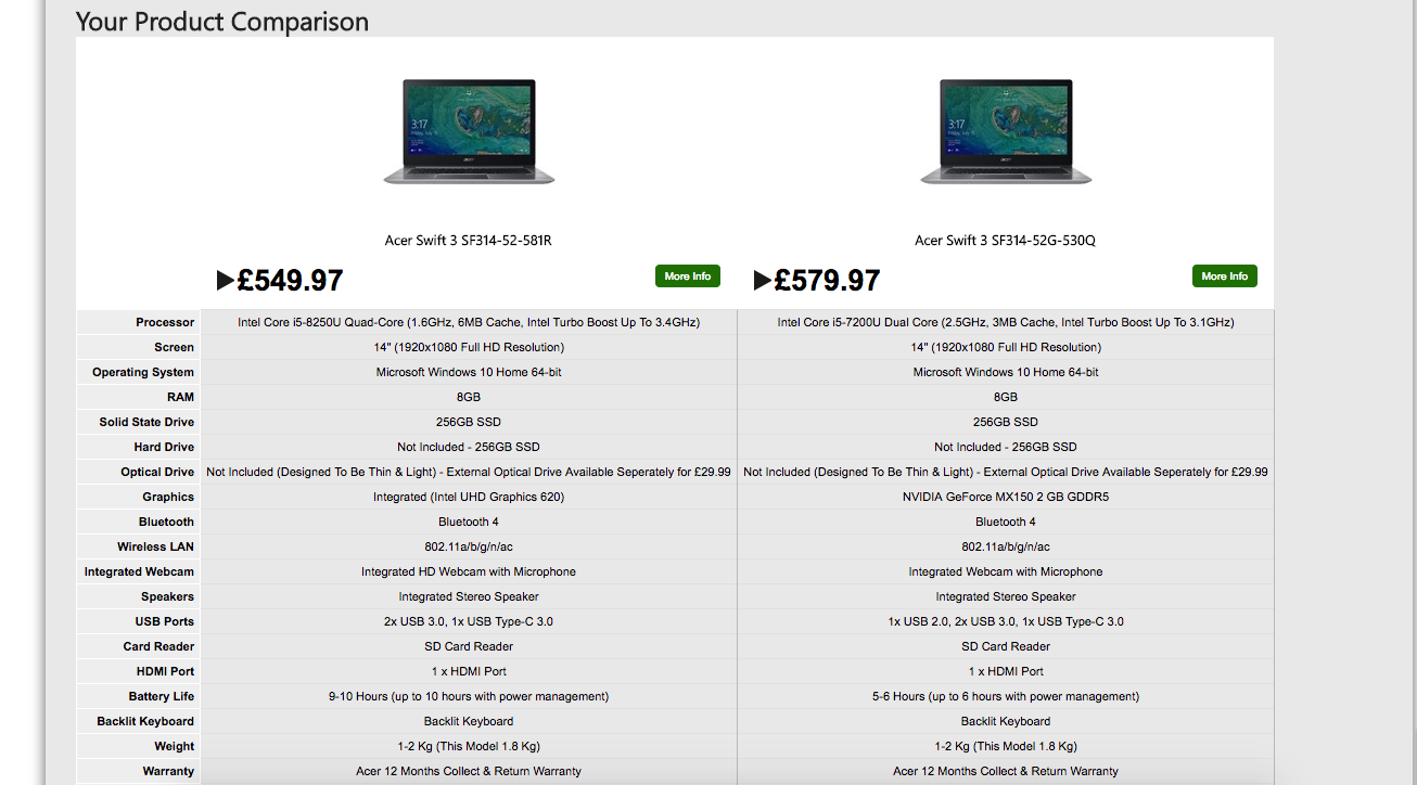

My sisters had Surface laptops/tablets or w.e you call them and they were absolutely terrible. I saw them at the store and I couldn't believe how expensive they are now, starting from around 800 GBP? I was looking at Lenovo, HP, and Dell mainly, and I narrowed down my choices to around 4 that I am trying to choose from. Anyone care to help? I know it's really, really on the wrong forum, though. 😀
These are the three choices if anyone's interested in helping out!
