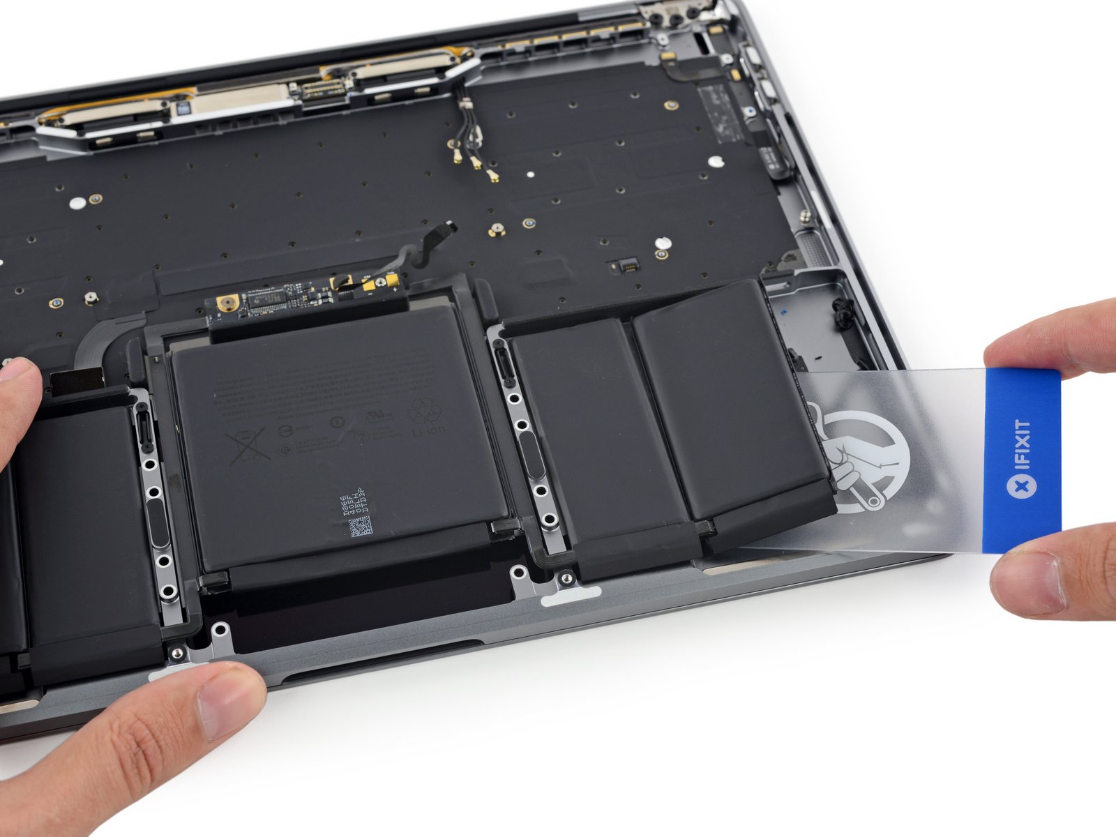

Do we know if the current models have any kind of plastic seal around the keyboard? The older models had the keyboard sealed off from the internals, so that moderate amounts of liquid would be unlikely to make it through to the logic board.
[doublepost=1544535211][/doublepost]Just checked ifixit. https://www.ifixit.com/Teardown/MacBook+Pro+15-Inch+Touch+Bar+2018+Teardown/111478
Does seem like the keyboard is sealed off from the logic board.

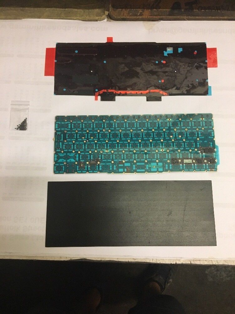

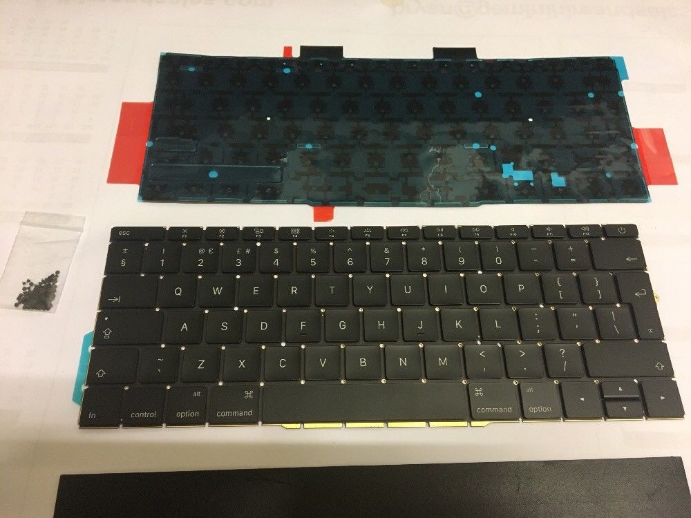

there is no seal, backlit sticker isn't much help
Is that for the backlight? Looks just like the black plastic seal on the older model. I think it would help with small spills.
black backlit sticker (above the battery), one of the cheapest solution, perfectly catching any food particles and bacteria
3yTiBkhmXMnDtEka.huge
from eBay non-TB model
other side
