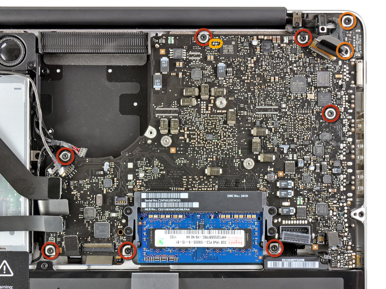

You can short two pins on the logic board to power on the unit. They are circled in orange.
