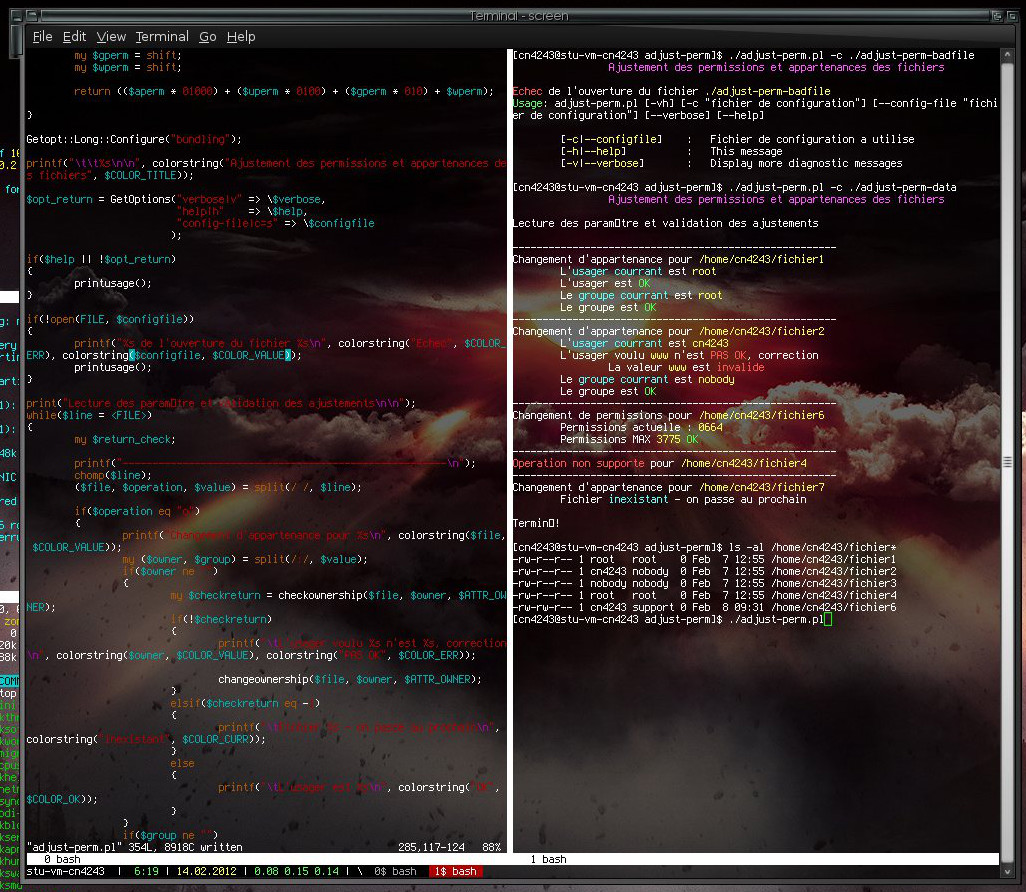

Just use GNU Screen. That's what it does.
CTRL-A S to split.
Here's what it looks like with the GIT version, vertical split patch (CTRL-A S horizontally splits, CTRL-A | vertically splits) :
