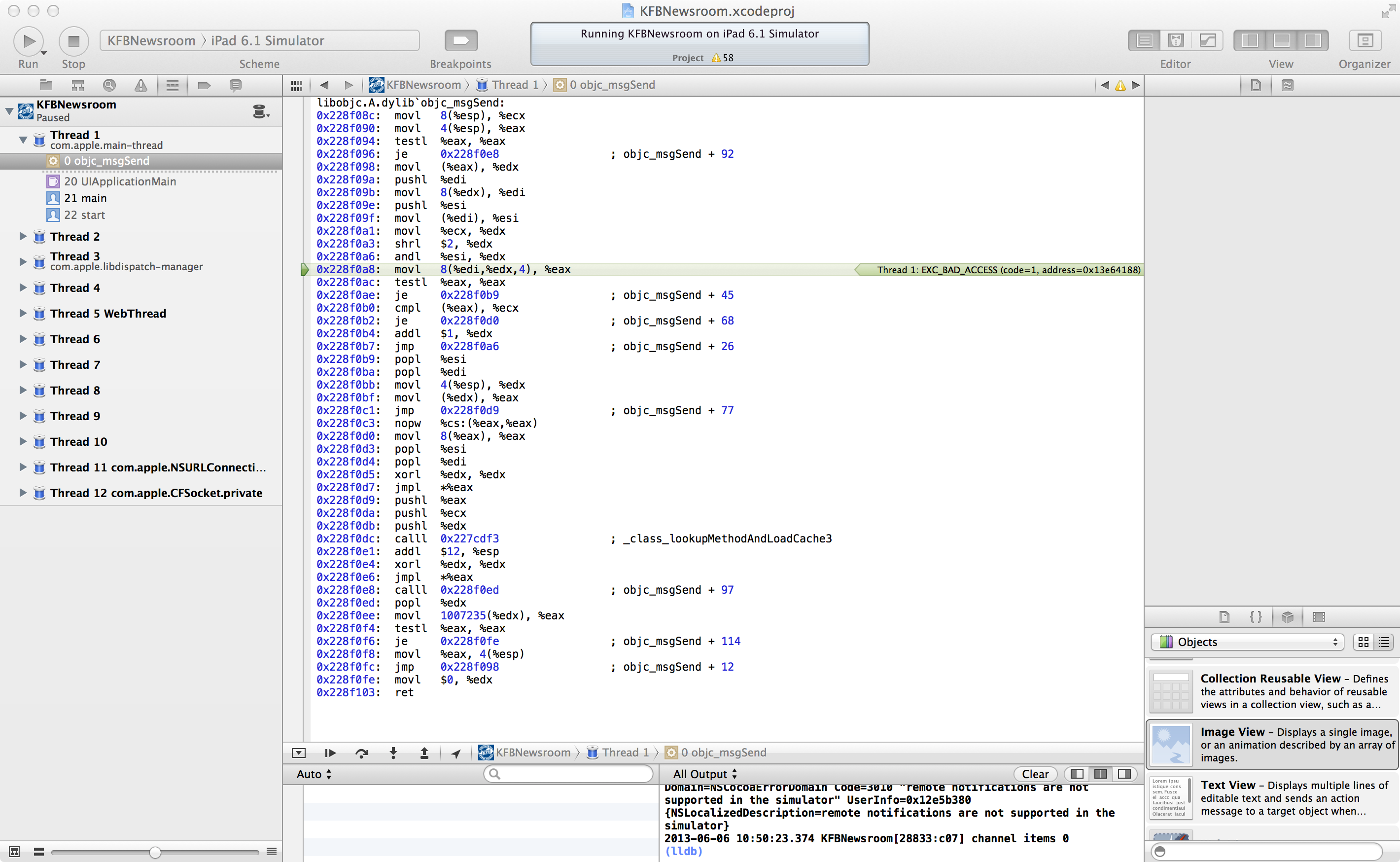

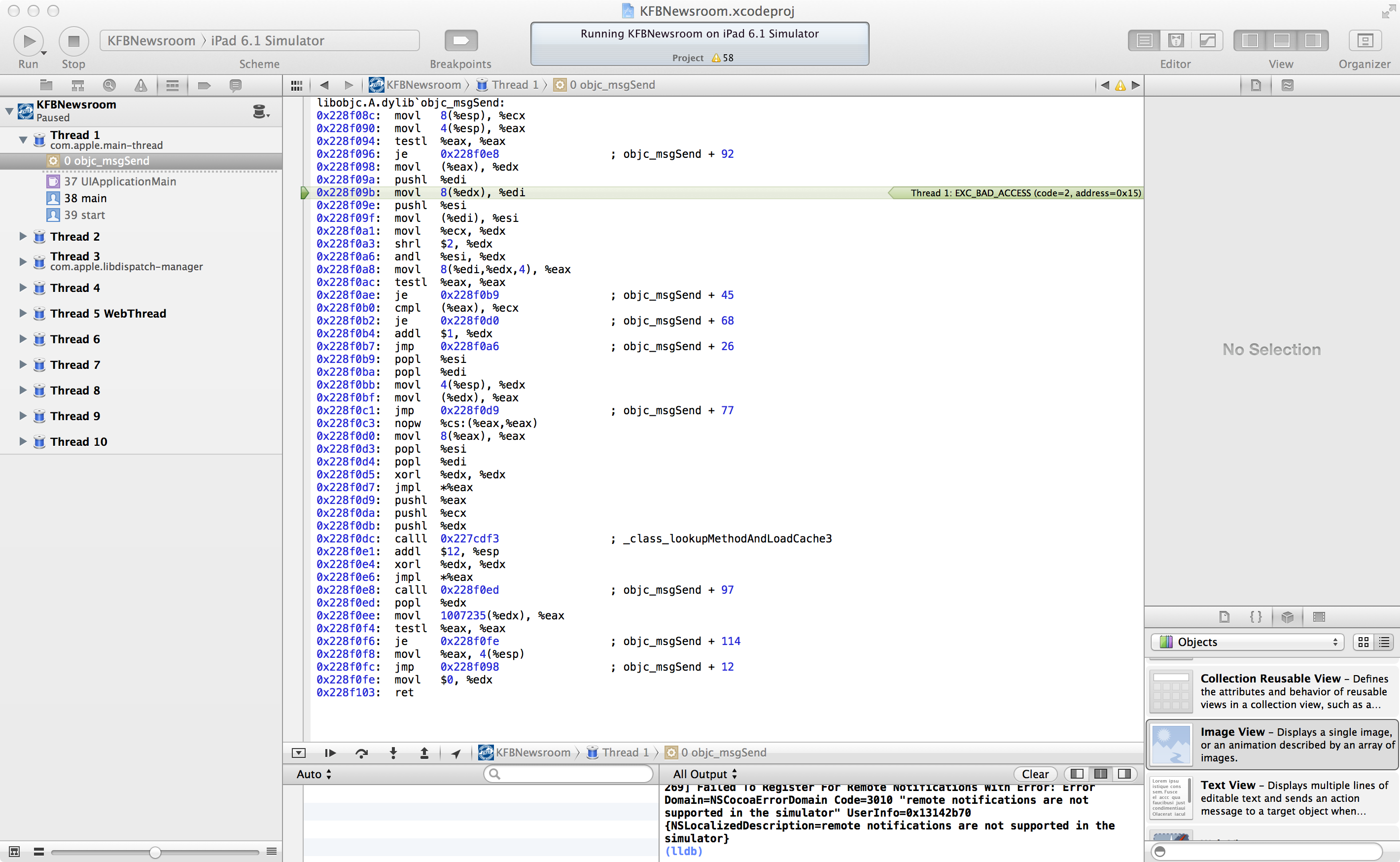

I am having various issues with the iPad version of my app. On iPad it uses a split view. The biggest problem is that it isn't running consistently. Sometimes when I run it, it works for the most part. Other times it does not. Sometimes it has a problem showing the master view when in portrait mode and crashes. Other times it will crash when selecting a row from the master view. Another problem is that when everything seems to be working at least half way correctly, I have to rotate the device in order for the master view to actually show its table view. I'm thinking all of my issues have something to do with how I've implemented it into my iPhone app to make it a universal app. I did all of the same stuff in a standalone iPad app to try it out and it works fine.
Here is a link to my project because there is far too much code to post here.
https://docs.google.com/file/d/0B-vCzSnQb_YzeHRrck1JLWNUMG8/edit?usp=sharing
There are other issues but these are the biggest ones.
Also, here are screenshots of when it crashes.
Any help is greatly appreciated.

It worked fine as a standalone iPad app. I took the code from that project and implemented it into my iPhone app to make a universal app. After some tweaking, such as differentiating between iPhone and iPad, it worked for the most part. The last thing I changed was with the navigation bar on the webviewcontroller I'm pushing as a detail view. It didn't work like I wanted so I changed it back and these issues kept happening.
I'm thinking it has something to do with it being a universal app and how I'm implementing the split view for iPad because, like I said before, this same code works just fine as just an iPad app in a separate project. Here is where I'm doing that in didFinishLaunchingWithOptions.
