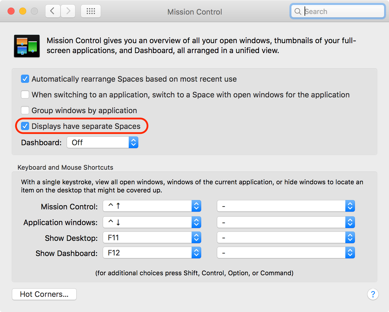

I found this from another forum, and it solved the problem for me. At first I thought it was hardware support issue (rMB 12"), but it wasn't.
If you can't get Split Screen to work (side by side full screen windows) in El Capitan, you'll need to enable "Displays have separate spaces", located in System Preferences > Mission Control. This will require you to log out and back in. Then, simply click and hold on the green "Full Screen" button and drag the window to another part of the screen. Voila!

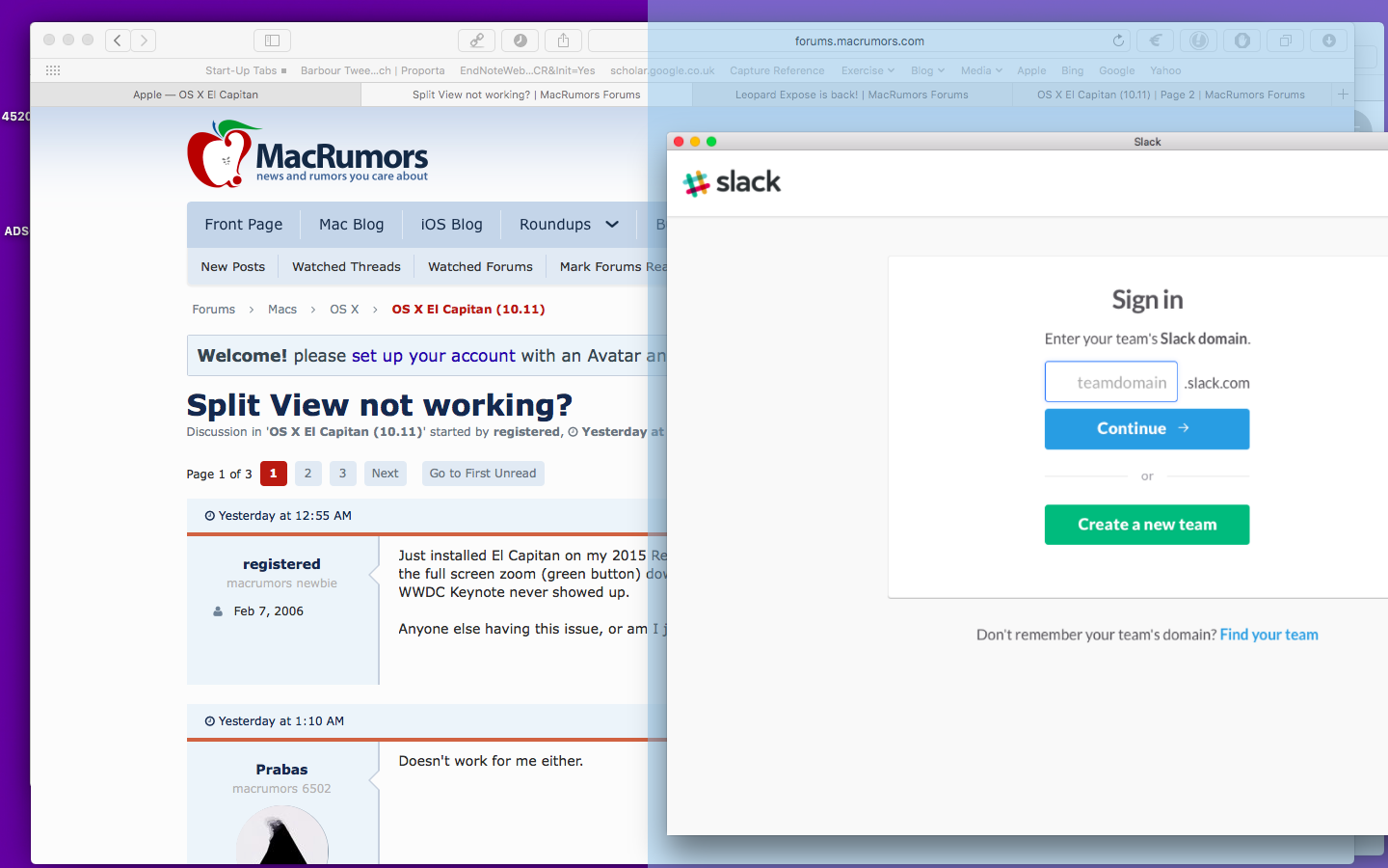

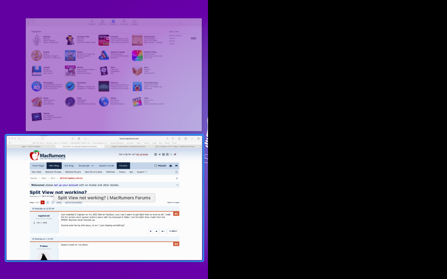

It's working for me but it's not particularly smooth.. When in split view the resizing option leaves one of the screens blank and is a very jittery process. Otherwise, looks like a really good feature. Screen Shot 2015-06-10 at 20.13.26.pngScreen Shot 2015-06-10 at 20.14.05.pngScreen Shot 2015-06-10 at 20.14.18.png

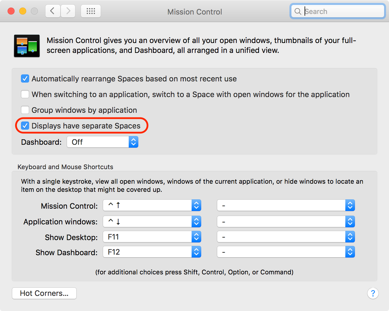

In System Preferences > Mission Control, tick the box for "Displays have separate Spaces," then log out and back in (or restart). Voila.

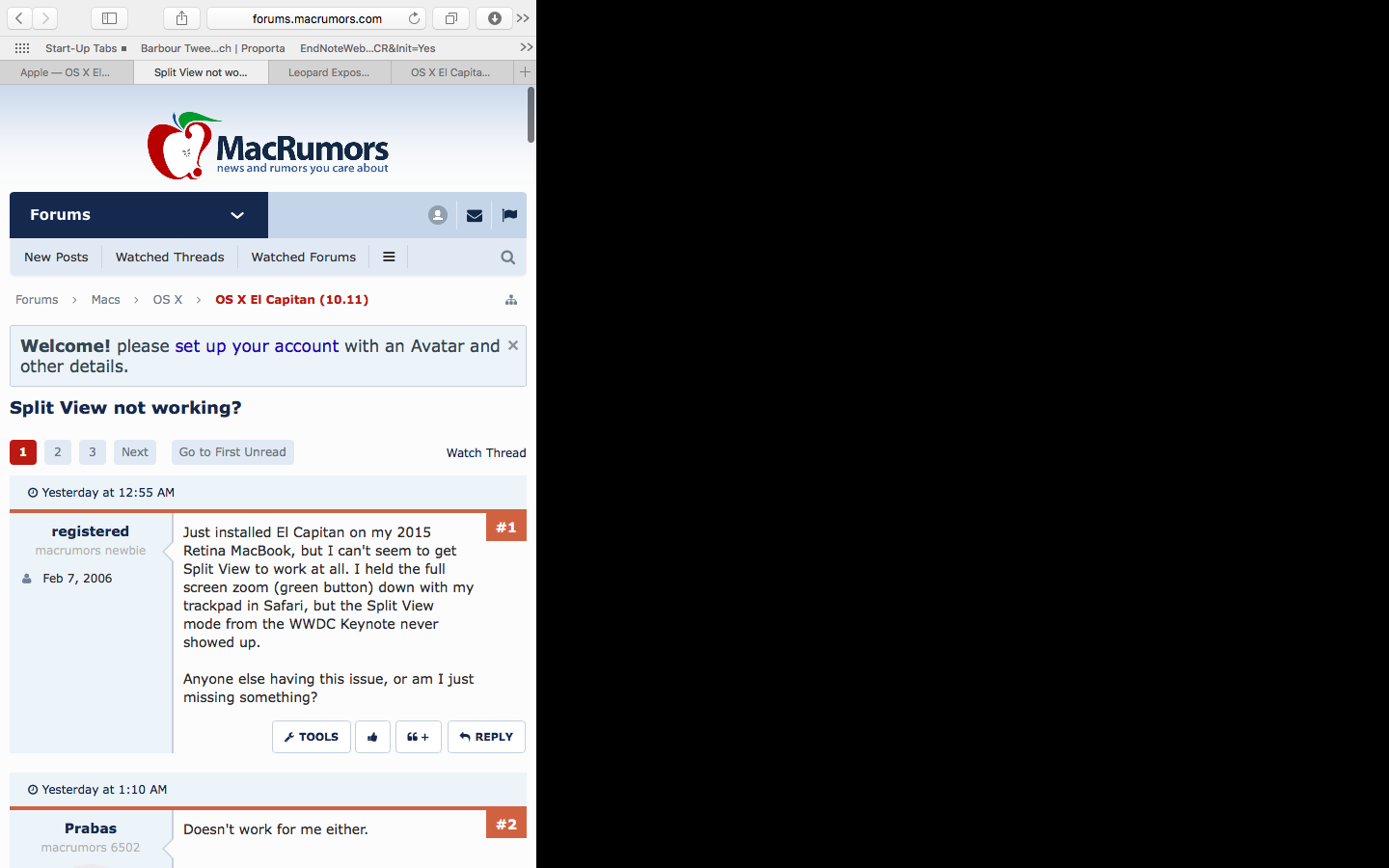

it is working fine for me on rmpb late 2013 without force touch. Here is the screenshot.
