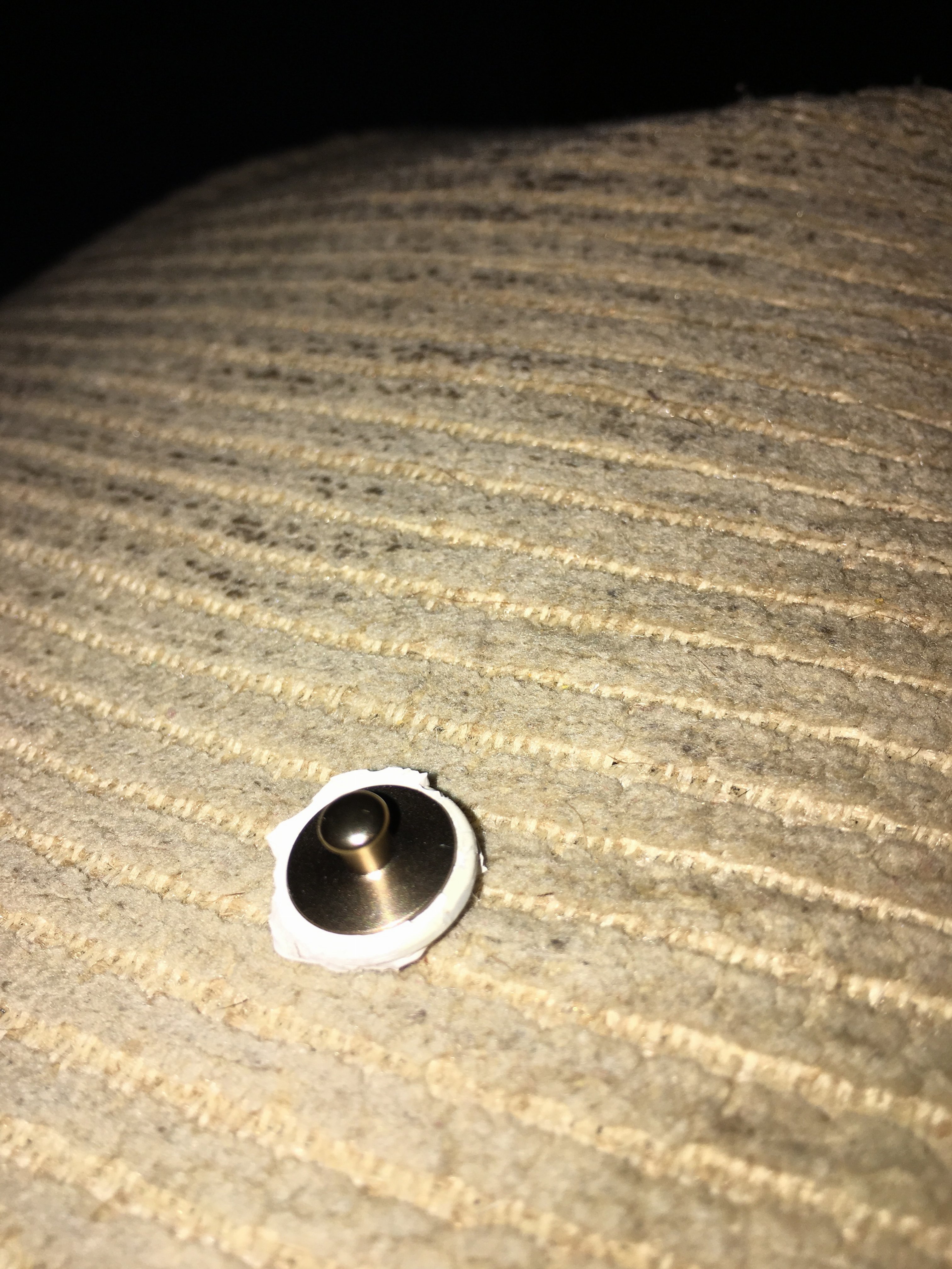

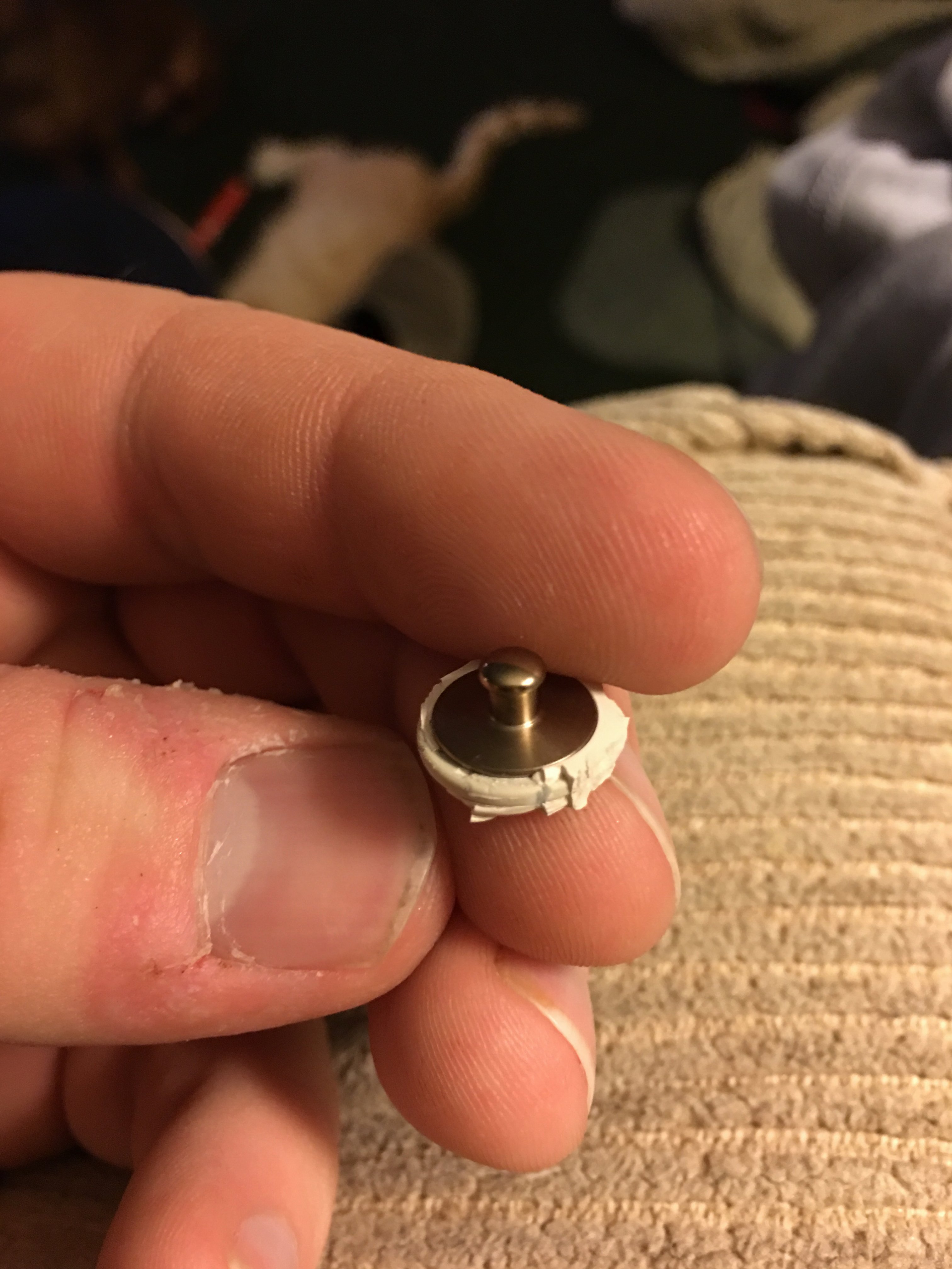

View attachment 587522 View attachment 587525 I'm trying it now, and it's not molded to the band, but there is a piece of hard plastic that is molded to the band which is inserted into the metal pin. I suspect that it is infact riveted around the plastic. I had a spare band so I bit the bullet and cut it, not going well. hope this helps.

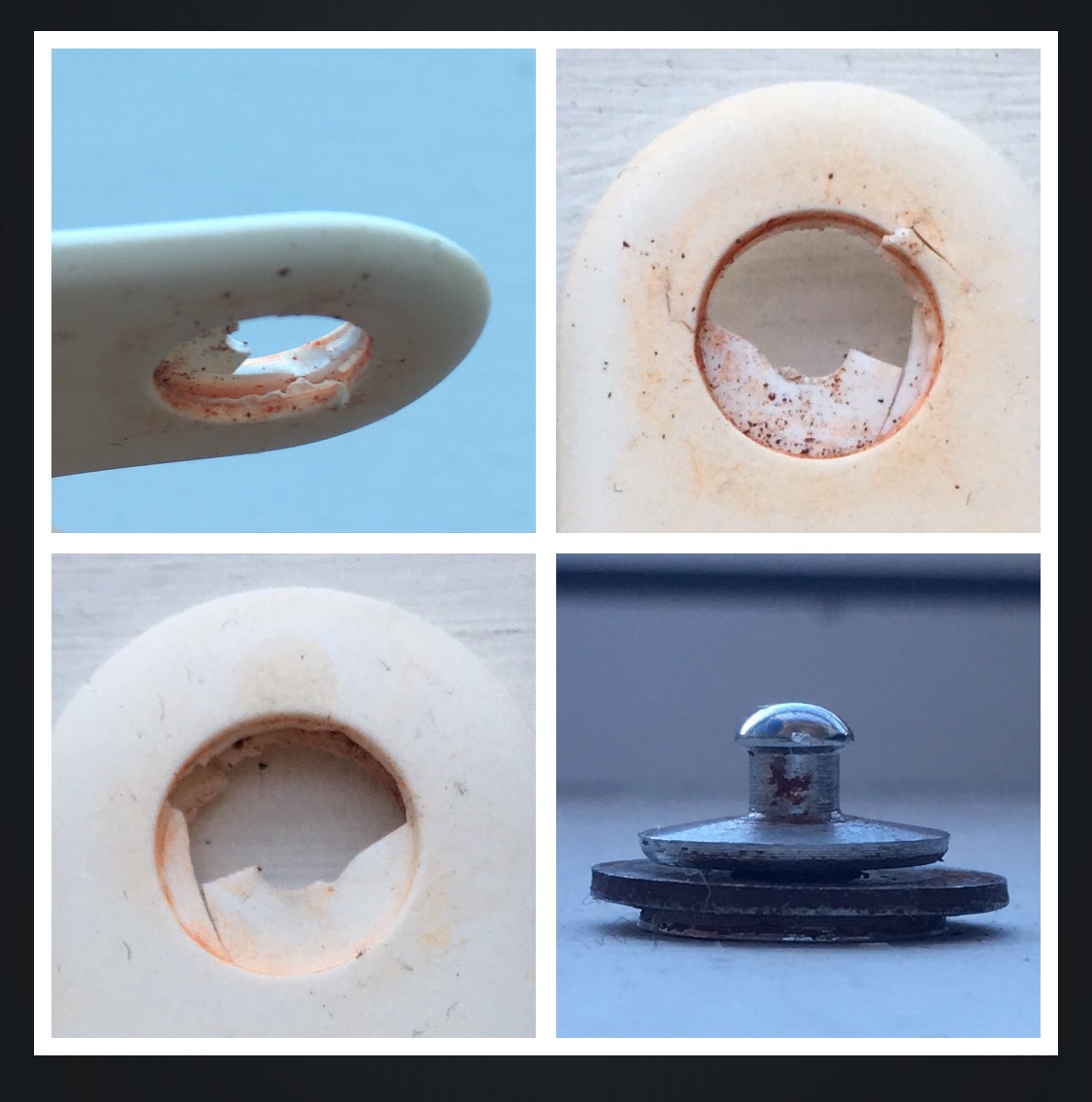

Interesting! I had a fake white band from Amazon ($10) that was getting discolored from sunscreen (or so I thought). I took it apart to see the pin closure, and it turns out that instead of a plastic washer between the two metal parts, there was a steel washer that was rusting. The basic way it attaches to the band (which I do think is mechanically identical to the original Apple watch band) is the band is created in three layers, like one of those swiss raspberry layer cookies. The top layer has a hole that abuts the edge of the pin flange. The middle layer goes all the way across but has a small hole in the middle for the screw post from the bottom layer to pass through to connect to the inside of the pin post on the top (like a Chicago Screw). The bottom layer overlaps the washer and abuts the edge of the stainless flat disk head. There is no way to take this pin out without destroying the band, as far as I can tell. This is so hard to describe without illustrations, so I've attached pics of my rusty band!125-98_swiss_raspberry_preserve-filled_cookies_250.jpg
