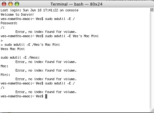

Code:
sudo mdutil -E /
will reindex your boot volume. Replace "/" with any other volume to reindex that.
Fukui said:
Did you click the eject button first?
Of-course I did. here is a screen shot of what i did and terminal and it did nothing!
