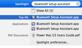

bluetooth set up assistant yields nothing for me.
bluetooth setup assistant gives me perfect results.

That's weird. i doesn't show up here either. and it's strange that spotlight would care whether it's written set up or setup. That's shoddy.
I'll try reindexing..
it isn't strange at all.
think about it. the applications name is SETUP assistant. for spotlight to also know that set up means the same thing would require yet another list of definitions to search. taking more time. taking more disk space. and imagine, there are millions of different things like this.
it's far more efficient and logical to have to find only the exact terms you type in, not to have it think for you. a computer is only as smart as the end user.

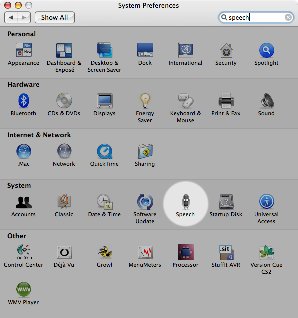

And is the search in System Prefs completely b0rked? Not even searching for Spotlight will highlight the icon...
You guys are having odd problems. It's working fine for me.

sys prefs search works fine for me too. maybe it shares components with Spotlight, if one's broken the other is too?
Must be it...😕 I did what rickvanr posted, and it's reindexing now. Maybe that'll fix it.
