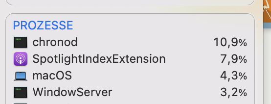

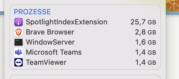

Spotlight wouldn't show my Apps anymore, so I started to reindex. Now it has been on it for more than three days and the fans are on, the CPU und RAM looks like this:

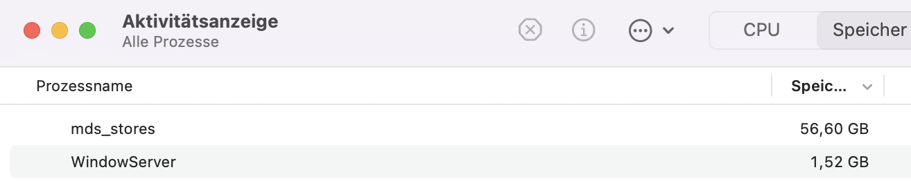

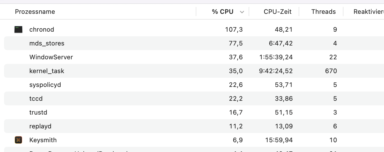

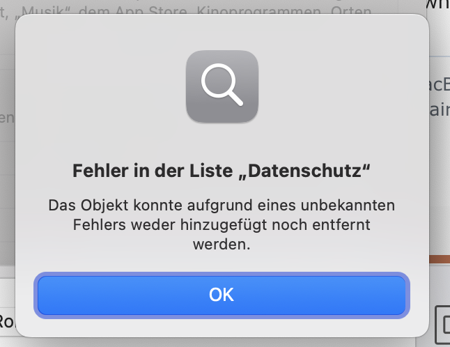

Try this. Disable spotlight by preventing it from Indexing Entire Drives. Search will return nothing. Then restart your Mac. Then remove the drive from the indexing prevention list. It will force the process

I tried this before using Terminal, but it wouldn’t allow me to add the main drive, for „an unknown reason“.
something is strange…

Use the UI from System Settings. I have had some success on Ventura when some indexing would drain the battery. Also try First Aid from Disk Utility on your Drives first
That is not normal, Spotlight should not use that much RAM. There is something wrong with spotlight and it is not indexing correctly.
I recommend you remove the .Spotlight-V100 folder from the root of the drive and then restart. Something is corrupt.
