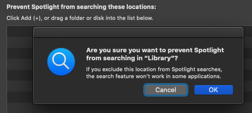

Hello all. This is a continuation of an issue brought up in this 10.15 thread (https://forums.macrumors.com/threads/update-to-10-15-5.2239185/?post=28521359#post-28521359) of mdworker.shared absolutely destroying the system.log with hundreds of the same err message per minute.
log-jpg.920930
Further down, user bogdanw seemingly found the culprit and how to take care of it (https://forums.macrumors.com/threads/update-to-10-15-5.2239185/?post=28522651#post-28522651)

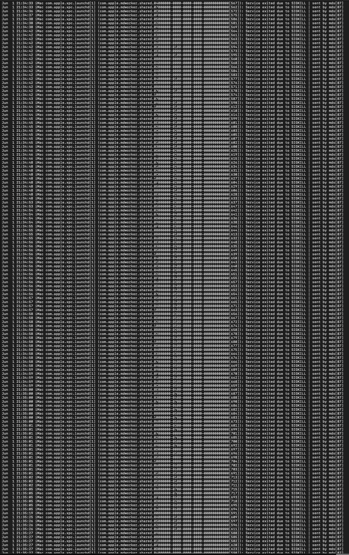

After reading your post, I opened the Console and found the same message repeated multiple times. As I have SIP disabled, I unloaded /System/Library/LaunchAgents/com.apple.mdworker.shared.plist, moved the plist in a backup folder and rebooted. The message is gone now. I have no idea what mdworker.shared is supposed to do, but Spotlight seems to be working just fine.
It seems according to the other people in the thread it worked for them as well, and initially it did work for me as well; my system log was completely gone of them and a very quiet system log. Unfortunately, it seems that it somehow messed up my Spotlight index now. There a bunch of stuff missing from my main drive (including applications) and random ones missing from my secondary one. I did try to do a Spotlight reindex by first putting them in the Spotlight > Privacy light so they wouldn't get indexed and then removed them to initiate a new reindex but that didn't work. I even tried using the terminal command that stopped indexing and reindexing, which didn't work. Note: I am running Mojave 10.14.X, but I can't see how the same issue present in both OSs would lead to different results when removing the file.
For those saying: "Well why not just leave the file there then", it obvious that sheer amount of console spam is not supposed to be happening normally. It happens even after a clean/fresh OS installed as documented by people who tried doing that in the other thread. It's constant extra work going on with the OS. When the file was removed my system.log is quiet as a mouse. I can go an entire day and there's barely anything in there without that file.
To everyone who's removed the mdworker.shared file from system, have you noticed that your searches aren't properly working anymore? Am I the only one experience these problems who have moved the file?
Reactions: jagooch
Well, Spotlight was no longer working anymore without the mdworker.shared file present, so I had to restore it and reboot. After an index Spotlight is functioning again, but this is also now back in full force:
Aug 2 04:15:58 GodzFire-MM com.apple.xpc.launchd[1] (com.apple.mdworker.shared.05000000-0000-0000-0000-000000000000[3087]): Service exited due to SIGKILL | sent by mds[66]
Aug 2 04:17:28 GodzFire-MM com.apple.xpc.launchd[1] (com.apple.mdworker.shared.08000000-0000-0000-0000-000000000000[3099]): Service exited due to SIGKILL | sent by mds[66]
Aug 2 04:17:28 GodzFire-MM com.apple.xpc.launchd[1] (com.apple.mdworker.shared.0F000000-0000-0000-0000-000000000000[3088]): Service exited due to SIGKILL | sent by mds[66]
Aug 2 04:17:28 GodzFire-MM com.apple.xpc.launchd[1] (com.apple.mdworker.shared.0A000000-0000-0000-0000-000000000000[3097]): Service exited due to SIGKILL | sent by mds[66]
Aug 2 04:18:38 GodzFire-MM syslogd[40]: ASL Sender Statistics
Aug 2 04:18:58 GodzFire-MM com.apple.xpc.launchd[1] (com.apple.mdworker.shared.03000000-0000-0000-0000-000000000000[3113]): Service exited due to SIGKILL | sent by mds[66]
Aug 2 04:19:12 GodzFire-MM com.apple.xpc.launchd[1] (com.apple.mdworker.shared.05000000-0000-0000-0000-000000000000[3098]): Service exited due to SIGKILL | sent by mds[66]
Aug 2 04:19:16 GodzFire-MM com.apple.xpc.launchd[1] (com.apple.mdworker.shared.02000000-0000-0000-0000-000000000000[3117]): Service exited due to SIGKILL | sent by mds[66]
Aug 2 04:19:16 GodzFire-MM com.apple.xpc.launchd[1] (com.apple.mdworker.shared.01000000-0000-0000-0000-000000000000[3114]): Service exited due to SIGKILL | sent by mds[66]
Aug 2 04:19:16 GodzFire-MM com.apple.xpc.launchd[1] (com.apple.mdworker.shared.0E000000-0000-0000-0000-000000000000[3116]): Service exited due to SIGKILL | sent by mds[66]
Aug 2 04:19:24 GodzFire-MM com.apple.xpc.launchd[1] (com.apple.mdworker.shared.10000000-0000-0000-0000-000000000000[3115]): Service exited due to SIGKILL | sent by mds[66]
Aug 2 04:19:38 GodzFire-MM com.apple.xpc.launchd[1] (com.apple.mdworker.shared.0F000000-0000-0000-0000-000000000000[3103]): Service exited due to SIGKILL | sent by mds[66]
Aug 2 04:23:09 GodzFire-MM com.apple.xpc.launchd[1] (com.apple.mdworker.shared.01000000-0000-0000-0000-000000000000[3124]): Service exited due to SIGKILL | sent by mds[66]
Aug 2 04:23:10 GodzFire-MM com.apple.xpc.launchd[1] (com.apple.mdworker.shared.03000000-0000-0000-0000-000000000000[3123]): Service exited due to SIGKILL | sent by mds[66]
Aug 2 04:23:10 GodzFire-MM com.apple.xpc.launchd[1] (com.apple.mdworker.shared.0B000000-0000-0000-0000-000000000000[3121]): Service exited due to SIGKILL | sent by mds[66]
Aug 2 04:23:10 GodzFire-MM com.apple.xpc.launchd[1] (com.apple.mdworker.shared.0C000000-0000-0000-0000-000000000000[3122]): Service exited due to SIGKILL | sent by mds[66]
Aug 2 04:23:10 GodzFire-MM com.apple.xpc.launchd[1] (com.apple.mdworker.shared.01000000-0000-0000-0000-000000000000[3127]): Service exited due to SIGKILL | sent by mds[66]
Aug 2 04:23:10 GodzFire-MM com.apple.xpc.launchd[1] (com.apple.mdworker.shared.0E000000-0000-0000-0000-000000000000[3126]): Service exited due to SIGKILL | sent by mds[66]
Aug 2 04:23:10 GodzFire-MM com.apple.xpc.launchd[1] (com.apple.mdworker.shared.02000000-0000-0000-0000-000000000000[3128]): Service exited due to SIGKILL | sent by mds[66]
Aug 2 04:23:10 GodzFire-MM com.apple.xpc.launchd[1] (com.apple.mdworker.shared.10000000-0000-0000-0000-000000000000[3125]): Service exited due to SIGKILL | sent by mds[66]
Aug 2 04:23:39 GodzFire-MM com.apple.xpc.launchd[1] (com.apple.mdworker.shared.08000000-0000-0000-0000-000000000000[3105]): Service exited due to SIGKILL | sent by mds[66]
Aug 2 04:24:21 GodzFire-MM com.apple.xpc.launchd[1] (com.apple.mdworker.shared.0F000000-0000-0000-0000-000000000000[3120]): Service exited due to SIGKILL | sent by mds[66]
Aug 2 04:24:43 GodzFire-MM com.apple.xpc.launchd[1] (com.apple.mdworker.shared.0A000000-0000-0000-0000-000000000000[3101]): Service exited due to SIGKILL | sent by mds[66]
Aug 2 04:24:43 GodzFire-MM com.apple.xpc.launchd[1] (com.apple.mdworker.shared.10000000-0000-0000-0000-000000000000[3162]): Service exited due to SIGKILL | sent by mds[66]
Aug 2 04:25:51 GodzFire-MM com.apple.xpc.launchd[1] (com.apple.mdworker.shared.08000000-0000-0000-0000-000000000000[3167]): Service exited due to SIGKILL | sent by mds[66]
Aug 2 04:25:54 GodzFire-MM com.apple.xpc.launchd[1] (com.apple.mdworker.shared.10000000-0000-0000-0000-000000000000[3168]): Service exited due to SIGKILL | sent by mds[66]
Aug 2 04:27:41 GodzFire-MM com.apple.xpc.launchd[1] (com.apple.mdworker.shared.05000000-0000-0000-0000-000000000000[3119]): Service exited due to SIGKILL | sent by mds[66]
Aug 2 04:27:41 GodzFire-MM com.apple.xpc.launchd[1] (com.apple.mdworker.shared.0F000000-0000-0000-0000-000000000000[3176]): Service exited due to SIGKILL | sent by mds[66]
Aug 2 04:27:41 GodzFire-MM com.apple.xpc.launchd[1] (com.apple.mdworker.shared.08000000-0000-0000-0000-000000000000[3174]): Service exited due to SIGKILL | sent by mds[66]
Aug 2 04:29:03 GodzFire-MM com.apple.xpc.launchd[1] (com.apple.mdworker.shared.03000000-0000-0000-0000-000000000000[3177]): Service exited due to SIGKILL | sent by mds[66]
Aug 2 04:29:03 GodzFire-MM syslogd[40]: ASL Sender Statistics
Aug 2 04:31:33 GodzFire-MM com.apple.xpc.launchd[1] (com.apple.mdworker.shared.10000000-0000-0000-0000-000000000000[3179]): Service exited due to SIGKILL | sent by mds[66]
Aug 2 04:32:12 GodzFire-MM com.apple.xpc.launchd[1] (com.apple.mdworker.shared.05000000-0000-0000-0000-000000000000[3188]): Service exited due to SIGKILL | sent by mds[66]
Aug 2 04:32:16 GodzFire-MM com.apple.xpc.launchd[1] (com.apple.mdworker.shared.10000000-0000-0000-0000-000000000000[3182]): Service exited due to SIGKILL | sent by mds[66]
Aug 2 04:32:16 GodzFire-MM com.apple.xpc.launchd[1] (com.apple.mdworker.shared.08000000-0000-0000-0000-000000000000[3189]): Service exited due to SIGKILL | sent by mds[66]
Aug 2 04:34:25 GodzFire-MM com.apple.xpc.launchd[1] (com.apple.mdworker.shared.05000000-0000-0000-0000-000000000000[3229]): Service exited due to SIGKILL | sent by mds[66]
Aug 2 04:35:04 GodzFire-MM com.apple.xpc.launchd[1] (com.apple.mdworker.shared.0A000000-0000-0000-0000-000000000000[3175]): Service exited due to SIGKILL | sent by mds[66]
Aug 2 04:35:58 GodzFire-MM com.apple.xpc.launchd[1] (com.apple.mdworker.shared.08000000-0000-0000-0000-000000000000[3230]): Service exited due to SIGKILL | sent by mds[66]
Aug 2 04:35:58 GodzFire-MM com.apple.xpc.launchd[1] (com.apple.mdworker.shared.0F000000-0000-0000-0000-000000000000[3181]): Service exited due to SIGKILL | sent by mds[66]
Aug 2 04:36:49 GodzFire-MM com.apple.xpc.launchd[1] (com.apple.mdworker.shared.0C000000-0000-0000-0000-000000000000[3237]): Service exited due to SIGKILL | sent by mds[66]
Aug 2 04:36:49 GodzFire-MM com.apple.xpc.launchd[1] (com.apple.mdworker.shared.01000000-0000-0000-0000-000000000000[3239]): Service exited due to SIGKILL | sent by mds[66]
Aug 2 04:36:49 GodzFire-MM com.apple.xpc.launchd[1] (com.apple.mdworker.shared.0B000000-0000-0000-0000-000000000000[3236]): Service exited due to SIGKILL | sent by mds[66]
Aug 2 04:36:49 GodzFire-MM com.apple.xpc.launchd[1] (com.apple.mdworker.shared.10000000-0000-0000-0000-000000000000[3234]): Service exited due to SIGKILL | sent by mds[66]
Aug 2 04:36:49 GodzFire-MM com.apple.xpc.launchd[1] (com.apple.mdworker.shared.02000000-0000-0000-0000-000000000000[3235]): Service exited due to SIGKILL | sent by mds[66]
Aug 2 04:36:49 GodzFire-MM com.apple.xpc.launchd[1] (com.apple.mdworker.shared.0E000000-0000-0000-0000-000000000000[3241]): Service exited due to SIGKILL | sent by mds[66]
Aug 2 04:37:08 GodzFire-MM com.apple.xpc.launchd[1] (com.apple.mdworker.shared.01000000-0000-0000-0000-000000000000[3240]): Service exited due to SIGKILL | sent by mds[66]
Aug 2 04:37:08 GodzFire-MM com.apple.xpc.launchd[1] (com.apple.mdworker.shared.03000000-0000-0000-0000-000000000000[3238]): Service exited due to SIGKILL | sent by mds[66]
Aug 2 04:38:40 GodzFire-MM com.apple.xpc.launchd[1] (com.apple.mdworker.shared.01000000-0000-0000-0000-000000000000[3247]): Service exited due to SIGKILL | sent by mds[66]
Aug 2 04:38:40 GodzFire-MM com.apple.xpc.launchd[1] (com.apple.mdworker.shared.0B000000-0000-0000-0000-000000000000[3248]): Service exited due to SIGKILL | sent by mds[66]
Aug 2 04:38:40 GodzFire-MM com.apple.xpc.launchd[1] (com.apple.mdworker.shared.01000000-0000-0000-0000-000000000000[3249]): Service exited due to SIGKILL | sent by mds[66]
Aug 2 04:38:40 GodzFire-MM com.apple.xpc.launchd[1] (com.apple.mdworker.shared.02000000-0000-0000-0000-000000000000[3250]): Service exited due to SIGKILL | sent by mds[66]
Aug 2 04:38:40 GodzFire-MM com.apple.xpc.launchd[1] (com.apple.mdworker.shared.10000000-0000-0000-0000-000000000000[3252]): Service exited due to SIGKILL | sent by mds[66]
Aug 2 04:38:40 GodzFire-MM com.apple.xpc.launchd[1] (com.apple.mdworker.shared.0E000000-0000-0000-0000-000000000000[3251]): Service exited due to SIGKILL | sent by mds[66]
Aug 2 04:38:47 GodzFire-MM com.apple.xpc.launchd[1] (com.apple.mdworker.shared.03000000-0000-0000-0000-000000000000[3246]): Service exited due to SIGKILL | sent by mds[66]
Aug 2 04:38:58 GodzFire-MM com.apple.xpc.launchd[1] (com.apple.mdworker.shared.03000000-0000-0000-0000-000000000000[3253]): Service exited due to SIGKILL | sent by mds[66]
Aug 2 04:39:11 GodzFire-MM syslogd[40]: ASL Sender Statistics
Aug 2 04:40:19 GodzFire-MM com.apple.xpc.launchd[1] (com.apple.mdworker.shared.10000000-0000-0000-0000-000000000000[3255]): Service exited due to SIGKILL | sent by mds[66]
Aug 2 04:40:42 GodzFire-MM timed[80]: settimeofday({0x5f268a1a,0x7e22c}) == 0
Aug 2 04:42:53 GodzFire-MM com.apple.xpc.launchd[1] (com.apple.mdworker.shared.10000000-0000-0000-0000-000000000000[3279]): Service exited due to SIGKILL | sent by mds[66]
Aug 2 04:43:51 GodzFire-MM com.apple.xpc.launchd[1] (com.apple.mdworker.shared.08000000-0000-0000-0000-000000000000[3244]): Service exited due to SIGKILL | sent by mds[66]
Aug 2 04:44:03 GodzFire-MM com.apple.xpc.launchd[1] (com.apple.mdworker.shared.0A000000-0000-0000-0000-000000000000[3233]): Service exited due to SIGKILL | sent by mds[66]
Aug 2 04:44:11 GodzFire-MM com.apple.xpc.launchd[1] (com.apple.mdworker.shared.10000000-0000-0000-0000-000000000000[3283]): Service exited due to SIGKILL | sent by mds[66]
Aug 2 04:44:12 GodzFire-MM com.apple.xpc.launchd[1] (com.apple.mdworker.shared.03000000-0000-0000-0000-000000000000[3284]): Service exited due to SIGKILL | sent by mds[66]
Aug 2 04:44:13 GodzFire-MM com.apple.xpc.launchd[1] (com.apple.mdworker.shared.10000000-0000-0000-0000-000000000000[3285]): Service exited due to SIGKILL | sent by mds[66]
Aug 2 04:44:13 GodzFire-MM com.apple.xpc.launchd[1] (com.apple.mdworker.shared.02000000-0000-0000-0000-000000000000[3286]): Service exited due to SIGKILL | sent by mds[66]
Aug 2 04:44:13 GodzFire-MM com.apple.xpc.launchd[1] (com.apple.mdworker.shared.0E000000-0000-0000-0000-000000000000[3287]): Service exited due to SIGKILL | sent by mds[66]
Aug 2 04:44:21 GodzFire-MM com.apple.xpc.launchd[1] (com.apple.mdworker.shared.01000000-0000-0000-0000-000000000000[3288]): Service exited due to SIGKILL | sent by mds[66]
Aug 2 04:45:04 GodzFire-MM com.apple.xpc.launchd[1] (com.apple.mdworker.shared.10000000-0000-0000-0000-000000000000[3295]): Service exited due to SIGKILL | sent by mds[66]
Aug 2 04:46:02 GodzFire-MM com.apple.xpc.launchd[1] (com.apple.mdworker.shared.02000000-0000-0000-0000-000000000000[3320]): Service exited due to SIGKILL | sent by mds[66]
Aug 2 04:46:02 GodzFire-MM com.apple.xpc.launchd[1] (com.apple.mdworker.shared.10000000-0000-0000-0000-000000000000[3321]): Service exited due to SIGKILL | sent by mds[66]
Aug 2 04:46:02 GodzFire-MM com.apple.xpc.launchd[1] (com.apple.mdworker.shared.0E000000-0000-0000-0000-000000000000[3319]): Service exited due to SIGKILL | sent by mds[66]
Aug 2 04:46:02 GodzFire-MM com.apple.xpc.launchd[1] (com.apple.mdworker.shared.01000000-0000-0000-0000-000000000000[3318]): Service exited due to SIGKILL | sent by mds[66]
Aug 2 04:46:55 GodzFire-MM com.apple.xpc.launchd[1] (com.apple.mdworker.shared.0F000000-0000-0000-0000-000000000000[3243]): Service exited due to SIGKILL | sent by mds[66]
Aug 2 04:47:25 GodzFire-MM com.apple.xpc.launchd[1] (com.apple.mdworker.shared.10000000-0000-0000-0000-000000000000[3345]): Service exited due to SIGKILL | sent by mds[66]
Aug 2 04:48:07 GodzFire-MM com.apple.xpc.launchd[1] (com.apple.mdworker.shared.05000000-0000-0000-0000-000000000000[3232]): Service exited due to SIGKILL | sent by mds[66]
Aug 2 04:48:07 GodzFire-MM com.apple.xpc.launchd[1] (com.apple.mdworker.shared.0A000000-0000-0000-0000-000000000000[3297]): Service exited due to SIGKILL | sent by mds[66]
Aug 2 04:48:58 GodzFire-MM com.apple.xpc.launchd[1] (com.apple.mdworker.shared.03000000-0000-0000-0000-000000000000[3348]): Service exited due to SIGKILL | sent by mds[66]
Aug 2 04:49:16 GodzFire-MM syslogd[40]: ASL Sender Statistics
Aug 2 04:52:11 GodzFire-MM com.apple.xpc.launchd[1] (com.apple.mdworker.shared.02000000-0000-0000-0000-000000000000[3360]): Service exited due to SIGKILL | sent by mds[66]
Aug 2 04:52:11 GodzFire-MM com.apple.xpc.launchd[1] (com.apple.mdworker.shared.01000000-0000-0000-0000-000000000000[3359]): Service exited due to SIGKILL | sent by mds[66]
Aug 2 04:52:11 GodzFire-MM com.apple.xpc.launchd[1] (com.apple.mdworker.shared.0E000000-0000-0000-0000-000000000000[3358]): Service exited due to SIGKILL | sent by mds[66]
Aug 2 04:52:11 GodzFire-MM com.apple.xpc.launchd[1] (com.apple.mdworker.shared.10000000-0000-0000-0000-000000000000[3361]): Service exited due to SIGKILL | sent by mds[66]
Aug 2 04:52:11 GodzFire-MM com.apple.xpc.launchd[1] (com.apple.mdworker.shared.0B000000-0000-0000-0000-000000000000[3363]): Service exited due to SIGKILL | sent by mds[66]
Aug 2 04:52:11 GodzFire-MM com.apple.xpc.launchd[1] (com.apple.mdworker.shared.03000000-0000-0000-0000-000000000000[3362]): Service exited due to SIGKILL | sent by mds[66]
Aug 2 04:53:54 GodzFire-MM com.apple.xpc.launchd[1] (com.apple.mdworker.shared.05000000-0000-0000-0000-000000000000[3351]): Service exited due to SIGKILL | sent by mds[66]
Aug 2 04:53:54 GodzFire-MM com.apple.xpc.launchd[1] (com.apple.mdworker.shared.10000000-0000-0000-0000-000000000000[3376]): Service exited due to SIGKILL | sent by mds[66]
Aug 2 04:55:05 GodzFire-MM com.apple.xpc.launchd[1] (com.apple.mdworker.shared.08000000-0000-0000-0000-000000000000[3296]): Service exited due to SIGKILL | sent by mds[66]
Aug 2 04:56:58 GodzFire-MM com.apple.xpc.launchd[1] (com.apple.mdworker.shared.10000000-0000-0000-0000-000000000000[3388]): Service exited due to SIGKILL | sent by mds[66]
Aug 2 04:57:07 GodzFire-MM com.apple.xpc.launchd[1] (com.apple.mdworker.shared.05000000-0000-0000-0000-000000000000[3381]): Service exited due to SIGKILL | sent by mds[66]
Aug 2 04:57:07 GodzFire-MM com.apple.xpc.launchd[1] (com.apple.mdworker.shared.0A000000-0000-0000-0000-000000000000[3350]): Service exited due to SIGKILL | sent by mds[66]

to see what are accessed by mds, and found files under $HOME/Library. After excluding ~/Library folder in spotlight, the system log looks better.

Note that each "Service exited due to SIGKILL | sent by mds" message in /var/log/system.log about com.apple.mdworker.shared corresponds to an orphaned, empty, directory in directory /private/var/folders/6t/t624jkmx7cbb9t35vzvjwj180000gn/C/com.apple.metadata.mdworker (the /6t/t6.../ portion of that path will be different on your system). My system had accumulated over 3.5 billion such directories which was causing my backup software to be unbearably slow. The orphaned directory name is of the form "$pid.something" where $pid is the process ID of the mdworker_shared process that was killed by the mds process using SIGKILL. I don't know, yet, what the "something" portion of the directory name means. The important point is the termination due to SIGKILL gives the mdworker_shared process no opportunity to cleanup after itself; such as by removing the temporary directory it created in the /private/var/folders/*/*/C/com.apple.metadata.mdworker directory.
I found that I could dramatically reduce such errors by adding two directories to the Spotlight "privacy" system preference pane: the Google Drive directory and a directory that sees significant file creation/removal by a security camera monitoring app. By dramatically I mean at least two orders of magnitude on my system. It looks like there is a race condition by Spotlight (mds and mdworker processes) involving the handling of file creation/removal.

Note that each "Service exited due to SIGKILL | sent by mds" message in /var/log/system.log about com.apple.mdworker.shared corresponds to an orphaned, empty, directory...

I have none of these directories but still have A LOT of "Service exited due to SIGKILL | sent by mds" log entries in the system log... Every few minutes I get about 10-15 new entries.
