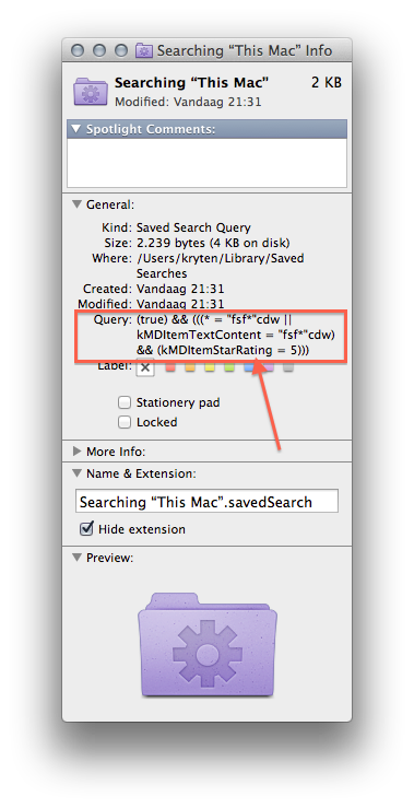

Save your search, get info on your search. Look at the query.

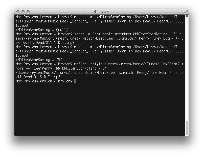

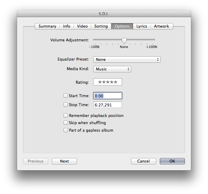

It seems like mdls shows the value of the kMDItemStarRating attribute as (null) when set in iTunes. Don't know if this is a bug or supposed to happen but I noticed this on SL and ML and from what I've read this also occurs on Tiger and Leopard. See the link for the workaround. I suggest you also read some documentation or man pages for the mdls and mdfind command.
Info : http://hints.macworld.com/article.php?story=20110314131100623

Thanks!!!
Your link is what i was looking for.
That page has this long script. Do i need to use it or can i just set rating with that one line script?
Longer script has these "Check for existence of xattr" and "Check for at least two arguments". What these do?
It's up to you to decide what you want to use. "Check for existence of xattr" does exactly what it says. There's no point in continuing the script if xattr isn't there to be used. Try running the script with only one argument eg only the rating argument and no file argument and see what happens. You also might want to read up on shell scripting.
