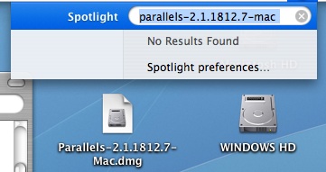

I recently got a MBP 2 GHz. Just today, I tried to use spotlight, and it will only search when the first or last character is space. For other characters, it will not search, but it will display no search found at the end. Also, for a known file (see attachment), it will display no search found after closing spotlight and opening it again. I have tried restarting and repairing permissions, I checked spotlight preferences, everything is normal. Thanks for the help!

In your example, does Spotlight find the DMG if you take the space off the end? Sorry, it's a bit early in the morning and I'm not fully understanding your problem.
Just as a side, if Spotlight plays up and reindexing doesn't help, then maybe deleting a file named com.apple.spotlight.plist and rebooting will help. 🙂
The dmg was an example, and it doesnt work without the space at the end. It doesn't even search with the typical results i normally get (live feedback). I will try trashing the plist and restarting and I'll get back to you.
