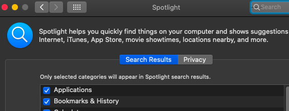

Check in System Preferences - Spotlight for Applications to be enabled
If it is, try do uncheck it and recheck it again.

thanks for the suggestion.
I tried unticking applications, and putting applications into the exclude list and then ticking / removing them again, but it has made no difference :(
