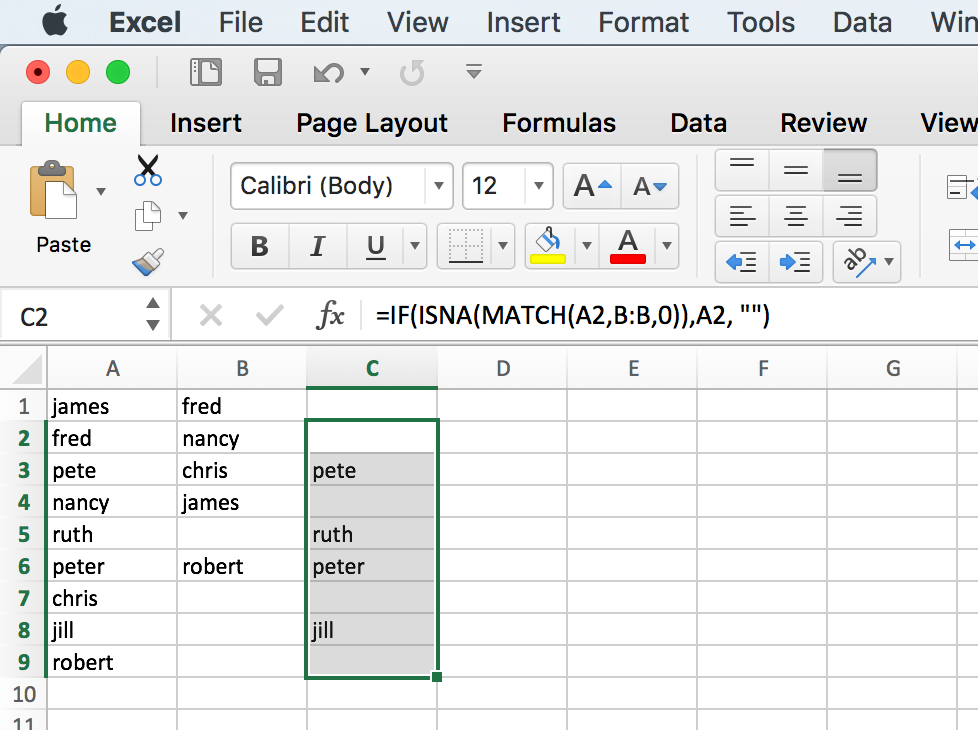

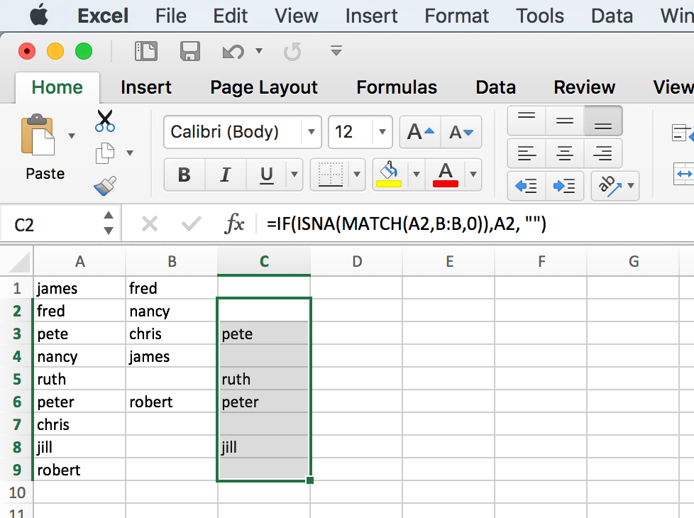

Try this:
=IF(ISNA(MATCH(A1,B:B,0)),A1, "")
More info on both functions here:
https://support.office.com/en-us/ar...0a0-a171-f2d869135665?ui=en-US&rs=en-US&ad=US
https://support.office.com/en-us/article/MATCH-function-e8dffd45-c762-47d6-bf89-533f4a37673a
Both lists and arrays work, it's a simple matter to extract the data you're looking for and strip out the extraneous cells to make a new, contiguous list (if you wish...).
