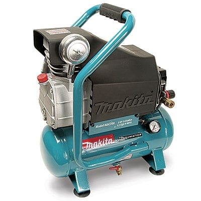

The amount of misinformation in this thread is simply unbelievable .
Do not use consumer vacuums , hair driers or canned aired to clean the insides of electronic devices . There are serious ESD and chemical damage concerns here .
Remove or open the device's chassis . Use a real compressor , preferably with a water trap , at 60 PSI at 6 inches from the items you are cleaning . Do not be alarmed if it does not seem powerful enough , as all loose particulate contamination should blow out . Let the items you are cleaning dry for between 12 and 24 hours before powering up again , as there are trace amounts of moisture in the hose line .
In my electronics shop , I have used a Makita Mac 700 compressor for the last 10 years . I paid $200 for it brand spanking new , delivered , from Amazon and it has been an awesome investment . It works like a charm and clients are favorably impressed with the results as their used computers "look like new !"

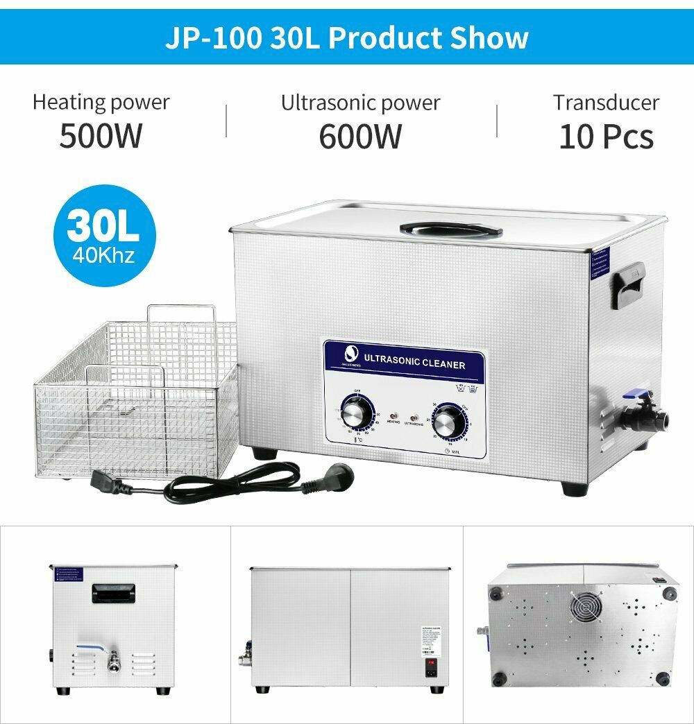

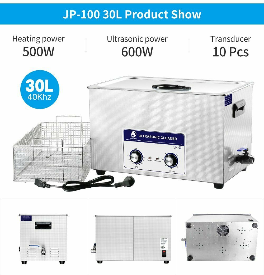

For small articles , an ultrasonic cleaning machine is an excellent choice . You can usually get away with using distilled water instead of expensive detergents . I recommend Skymen brand with the analog control dials . They're twice as expensive as the cheaper ones but Skymen is a real industrial ultrasonic tank manufacturing firm . They make tanks so large , you could practically live in them . They make their own products in house and the build quality is much better than the cheaper brands , so it should be durable .

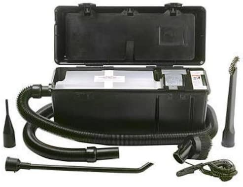

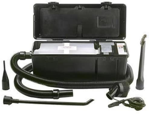

There are some ESD safe vacuums specifically made for the electronics industry , but I don't need to use them . These cost $250 - 350 brand new and are made by 3M / SCS .
Remove or open the device's chassis . Use a real compressor...
There are some ESD safe vacuums specifically made for the electronics industry...

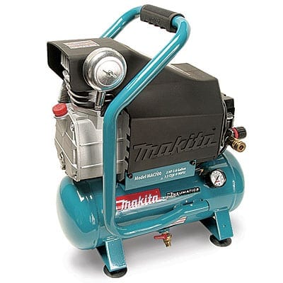

OT but that Makita compressor is the best one I've ever had. it's heavy, though. But quiet and powerful.
There are special vacuum cleaners for cleaning out computers. Don’t ever take a consumer vacuum to a computer. That’s just dumb for a lot of the reasons noted here.

For ESD related components we have DataVac for that purpose. in my opinion DataVac are more appropriate for home cleaning.
