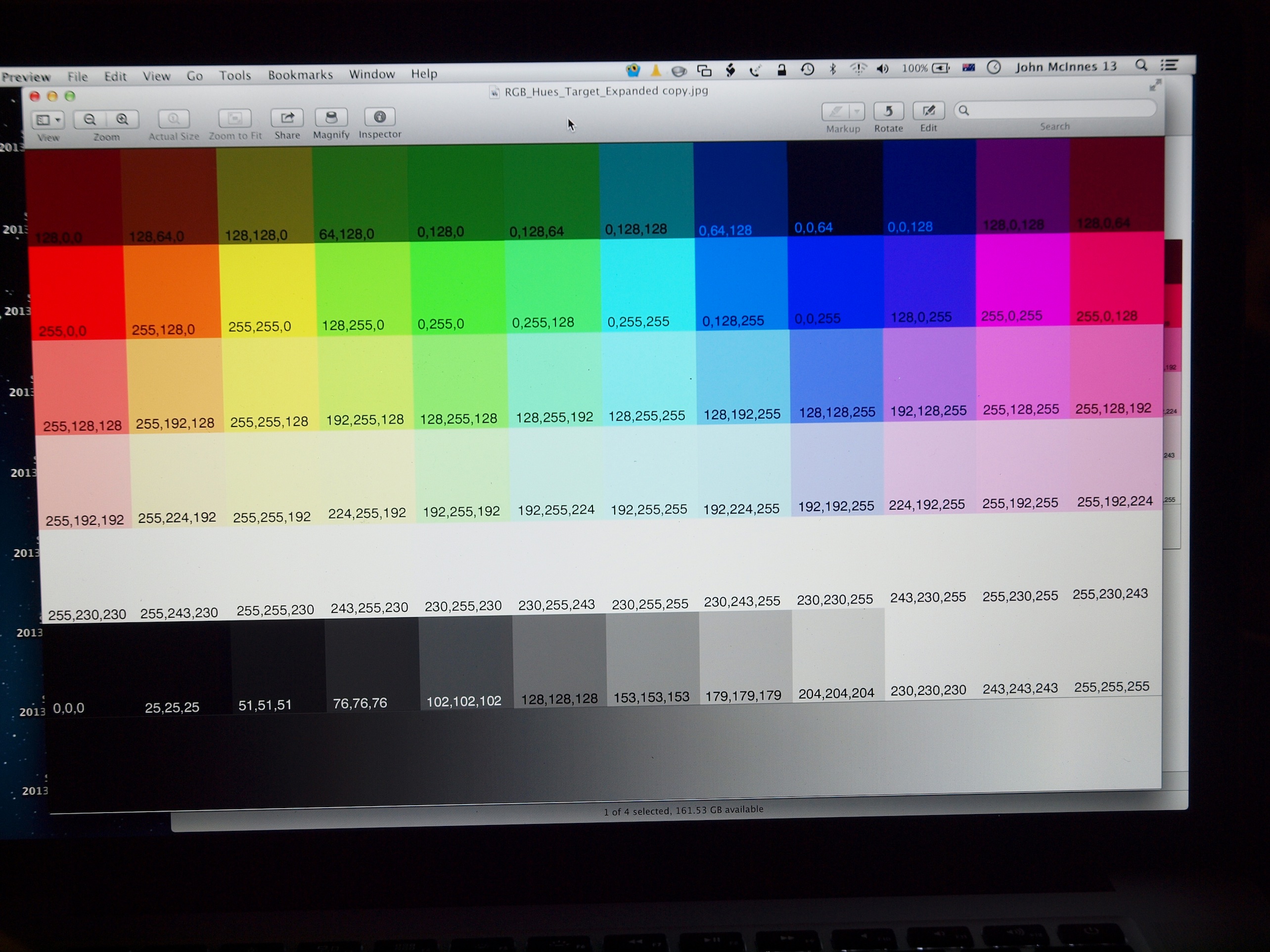

I, and several others, have had issues with the Retina's calibration. I have written about it here
https://discussions.apple.com/thread/4990358 and that post contains links to a couple of similar reports.
The problem seems to me to be with the MBPR display. By default it has very high contrast which clips highlights and blocks up shadows. This isn't a great photo but look at the 5th row from the top, and the whites 230 243 and 255. 20140614_052327E30P6140412.JPG

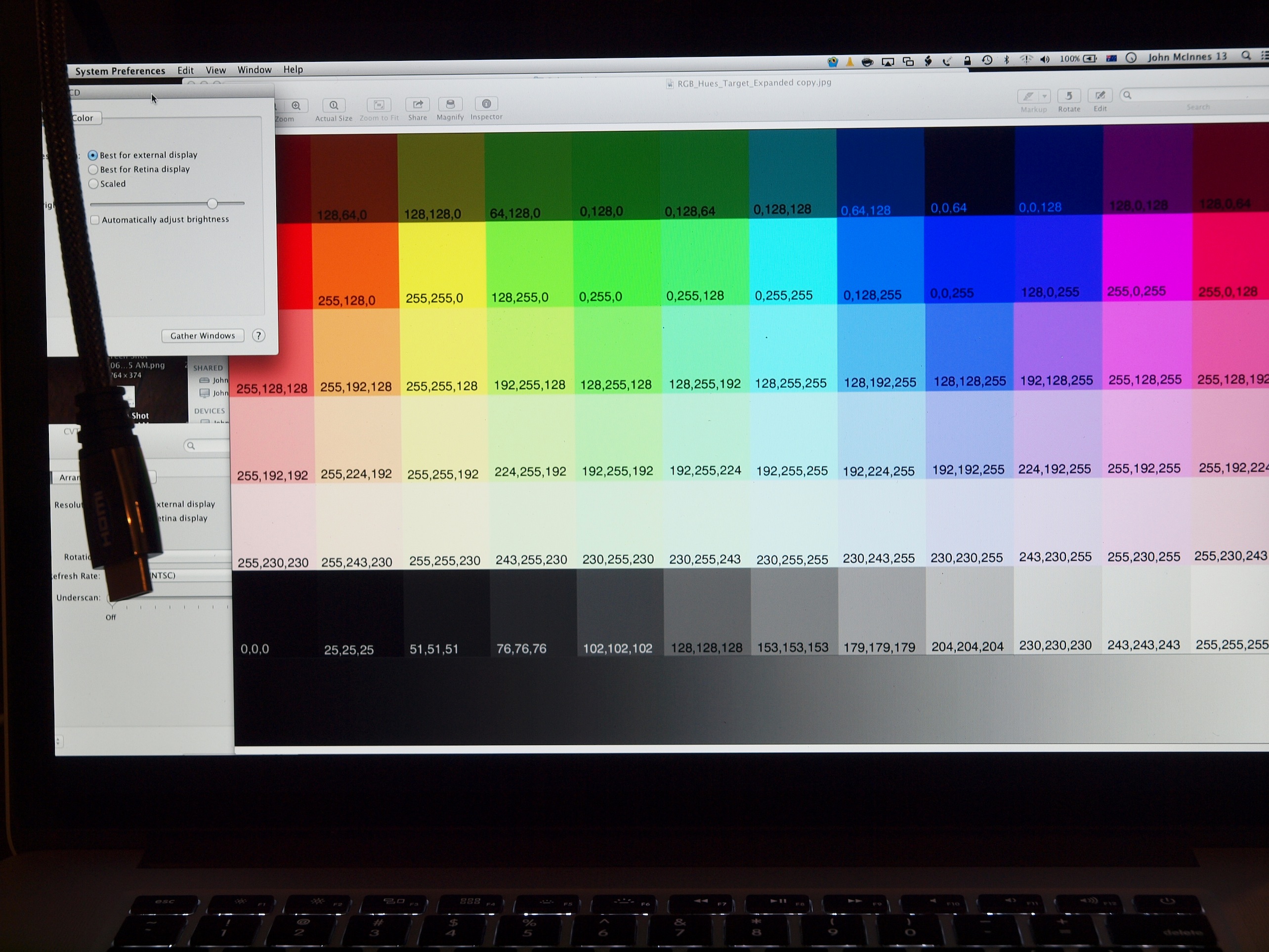

Since I wrote in the above thread I reproduced the behaviour and identified what made my screen come good.
1. I plugged in my TV using HDMI.
2. In System Preferences I selected Displays and then the Colour LCD window [the other one that pops up pertains to the external display]/"Display" tab/"best for external display" radio button.
3. At this point the exaggerated contrast on the MBPR display ceased, and all squares on the colour checker became distinguishable from each other.
4. Even after unplugging the TV the macbook screen retained its newfound normal response.
5. After a restart it went back to its high-contrast chicanery.
6. Repeating 1 to 4 produced the same result as it had before.
