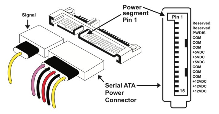

You suggested a HGST drive without the power disable feature. Do they come in different versions or is this a jumper setting on the drive?
power disable is a built in , permanent reset feature of some HDDs . There is no jumper to disable the power disable feature .
The feature utilizes the third pin ( of the 15 pins ) of the power portion of the SATA connector . This is the PWDIS pin .
SATA connectors have 7 data ( signal ) + 15 power pins , for a total of 22 pins .
The power disable feature can be disabled by neutralizing this third power pin , say , by placing a small piece of Kapton tape to cover only this third pin .

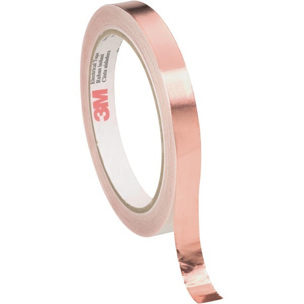

you suggested a Bluetooth upgrade: is this to eliminate the interference when you insert a USB-3 card or for other reasons?
It's nice to have an upgraded wireless System in a cMP , because factory shipping WiFi and BT is ten year old technology . You'll have an ability to connect to modern devices and also have improved performance . You can also get Continuity feature set support and improved signal strength with external antennas .
If you are getting EMI because of an USB card , you might consider some strategically placed copper foil tape and insulate that if necessary to prevent shorting . Apple has been known to install this tape in their Systems . it looks like this :
