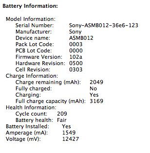

they will ask for your for your full charge capacity, which is located in system profiler under 'power'
this is mine after 9 mths of using? am i eligible for an exchange?
