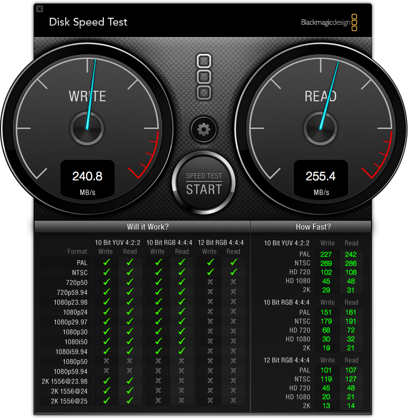

Sounds good to me. I ran Blackmagic Disk Speed Test directly after installation and saved a screenshot. I'll do a comparison in a couple of months.
