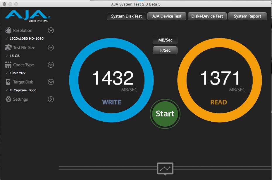

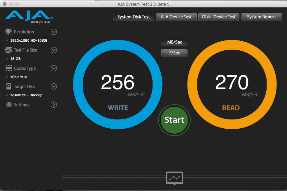

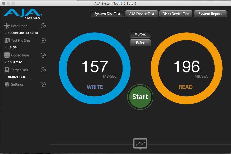

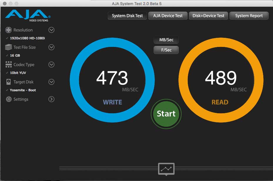

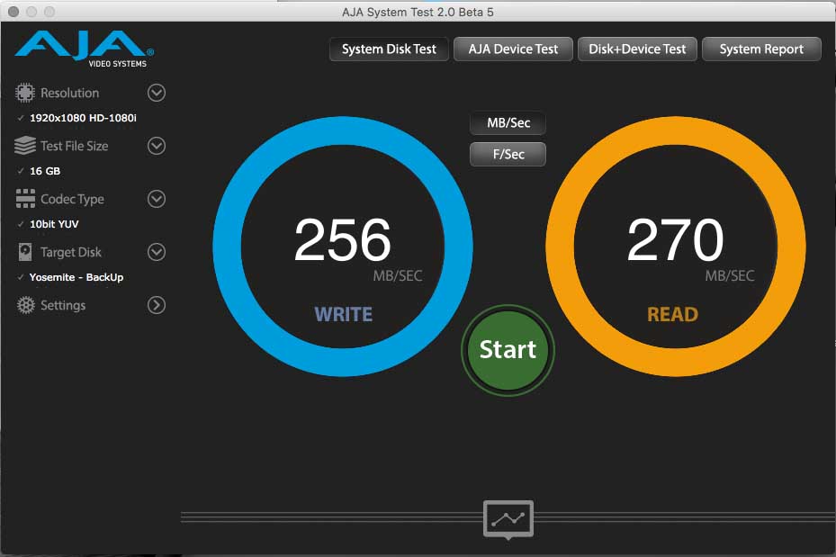

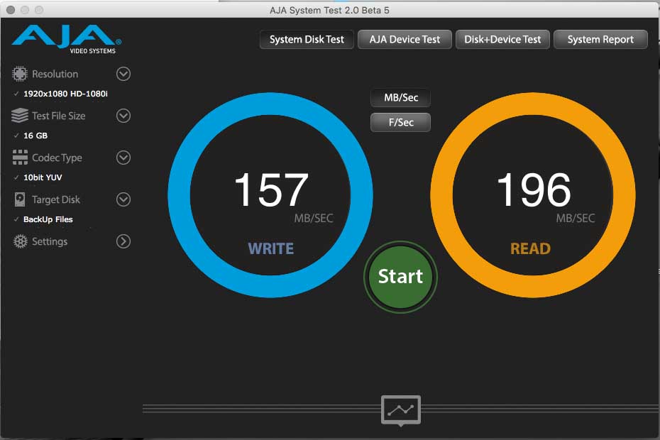

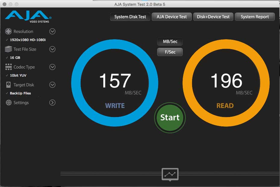

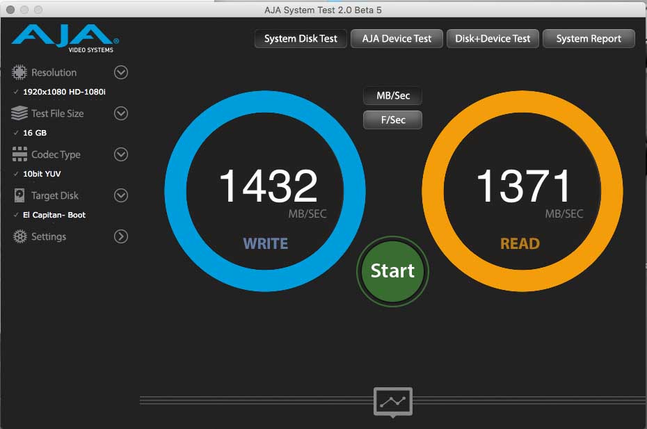

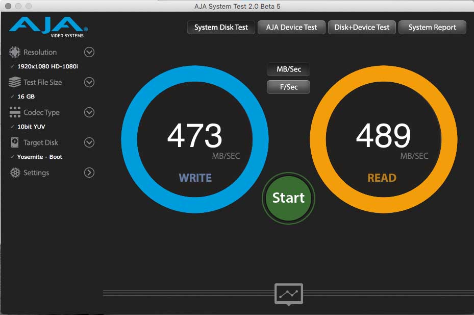

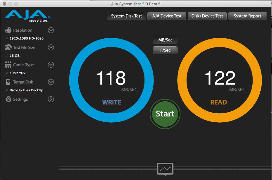

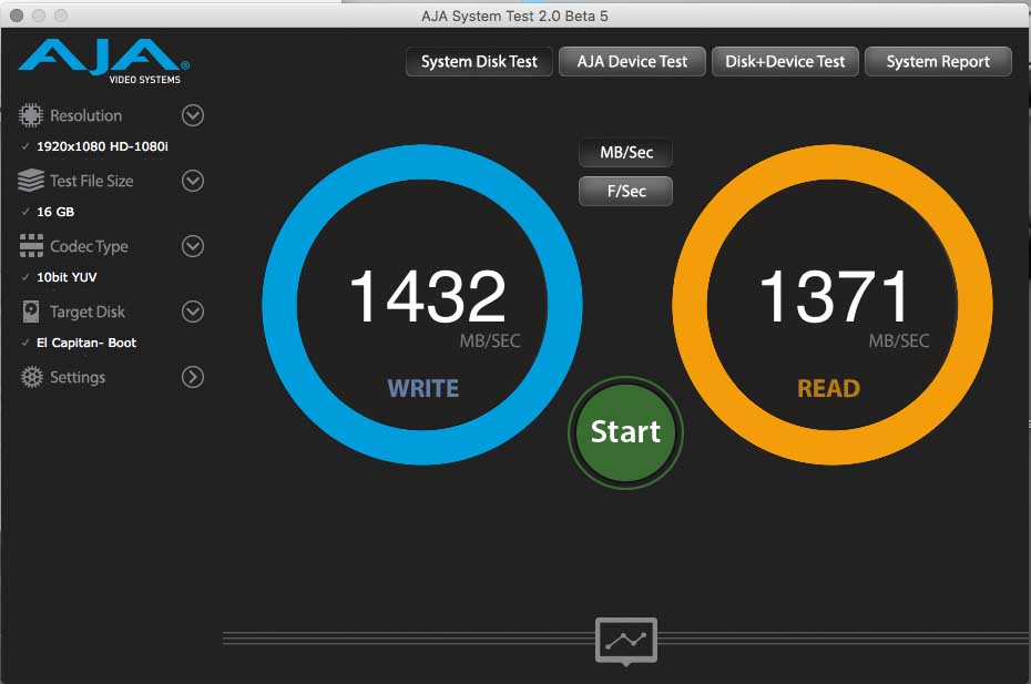

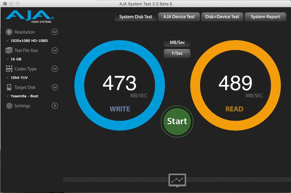

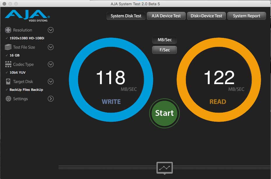

AJA Tests I ran:
1. SM951 on PCIe card
2. 840 Pro on PCIe card
3. 840 EVO in SATA slot
4. Seagate SSHD in SATA slot
5. WD Black HDD in SATA slot
AJA SM951.jpg AJA 840 Pro Duo x2.jpg AJA 840 Evo SATA Slot.jpg AJA Seagate SSDHD.jpg AJA WD Black.jpg

AJA Tests I ran:
View attachment 716108 View attachment 716110 View attachment 716111 View attachment 716112 View attachment 716113
Lou

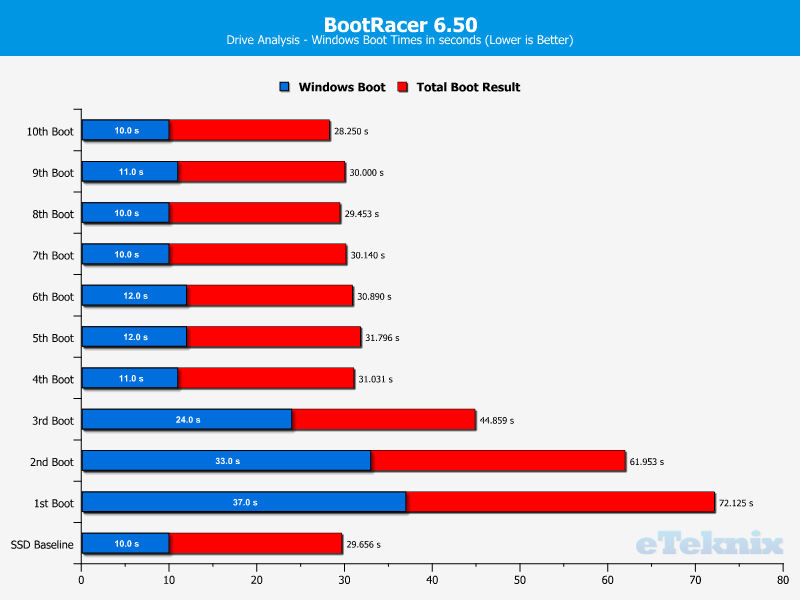

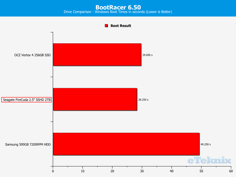

This chart explain more what can happen in real world.
When the data is "new", the SSHD won't perform better than a good HDD. In this case, the SSHD require 72s on the 1st boot. But the reference 7200RPM HDD only need 49s (refer to the chart below). However, when you keep accessing the same data. The firmware will start to copy the frequent accessed data onto the cache (SSD). The end result, after 10 boot, it's boot time reduce to 28s. which is at the SSD level.
So, if you have some regular access user data. Those data most likely will be copied onto the SSHD's cache. And give you SSD like performance. However, the remaining data most likely will perform at HDD level. I recommend the Firecuda 3.5" because it has a 7200 RPM HDD inside. So, apart from 8GB fast data access. The remaining will still perform at a reasonable level. A SSHD like the above example has a 5400 RPM HDD (this is the 2.5" Firecuda, not 3.5"), and you can see, the non-cached performance drops a lot compare to a "good" HDD.
