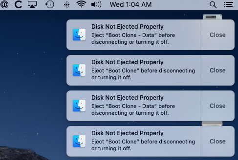

Just installed my J3i about an hour ago with (all new - freshly formatted) 14TB HD, an 8TB HD and this 1TB SSD :
I formatted the SSD as APFS and then had CCC Clone my internal 1TB Startup drive to it. I made a 20 minute run to the grocery store and when I came back the display had gone to sleep. When I woke it up, I had (4) Notifications lined up along the right side of the screen that the drive had ejected improperly, then it quickly showed up on the desktop with the files in-tact. Spinning hard drives - no problem.

Here is what I am getting - just woke up the screen again...
Had the same thing happen with an external Seagate 4T hdd plugged into one of the top two ports. Left it plugged in over night, computer screensaver kicked in, and then the next morning - 10 of those messages listed in a column on the right side of the screen. The hdd was no longer listed in Finder. Disconnecting and reconnecting into the port put all back to normal. No data lost. {It was an old hdd}

• Does not disconnect only when display goes to sleep - had it happen several times tonight while copying files. I usually get (2) alert dialogs at a time.
• Turned Energy Setting "Put Hard Disks to Sleep When Possible" OFF - drive still kept disconnecting.
I also sent a link to this thread to Sonnet Tech Support.
choreo, I bet it is the same thing that happened to me. Replace the adapter and it should go away (Running for days now without any further problems). I also contacted Sonnet, and it is also likely that some SATA cables are defect as well, at least for me my HDDs never gave me this problem.
