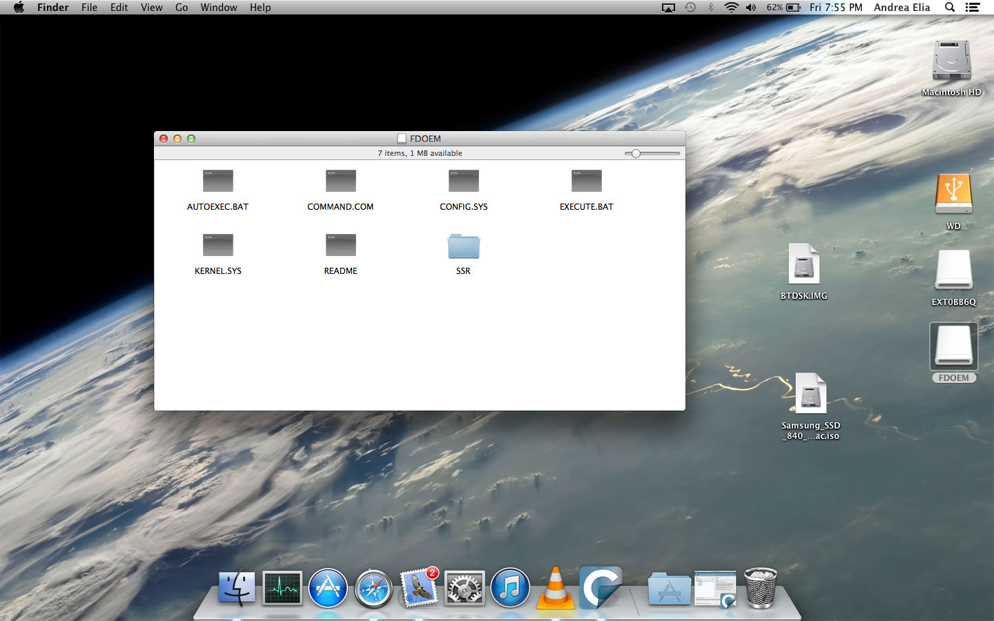

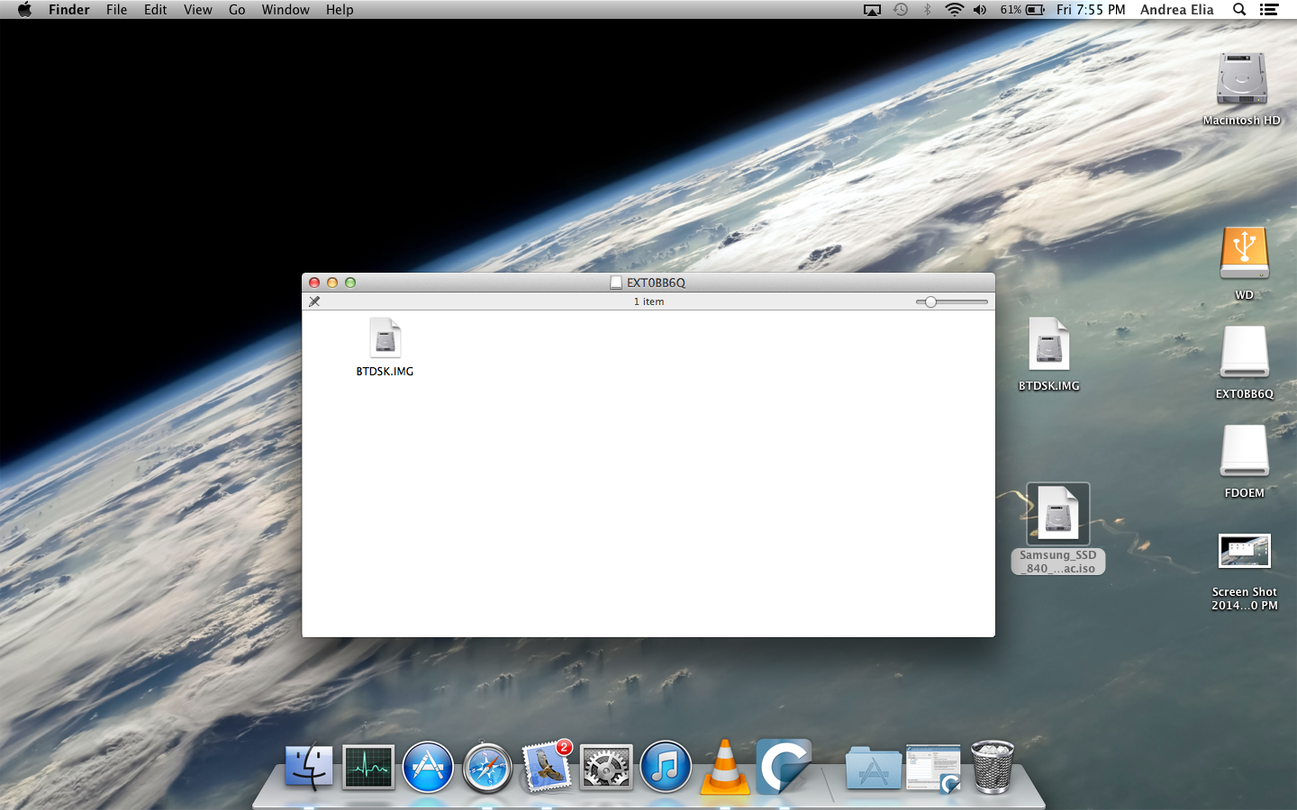

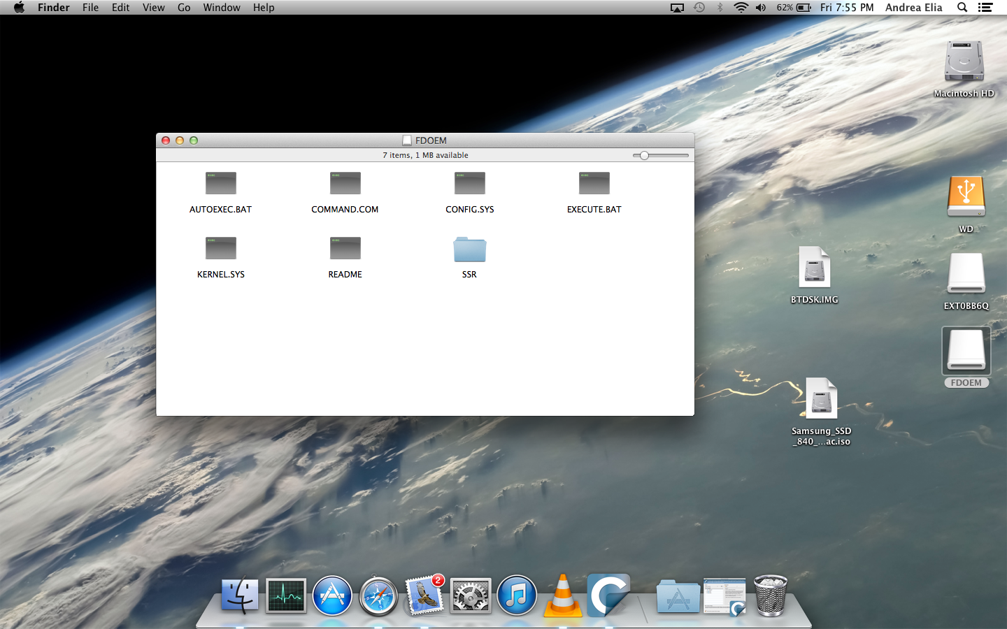

so when I mount the ISO file for the firmware update it show the IMG file

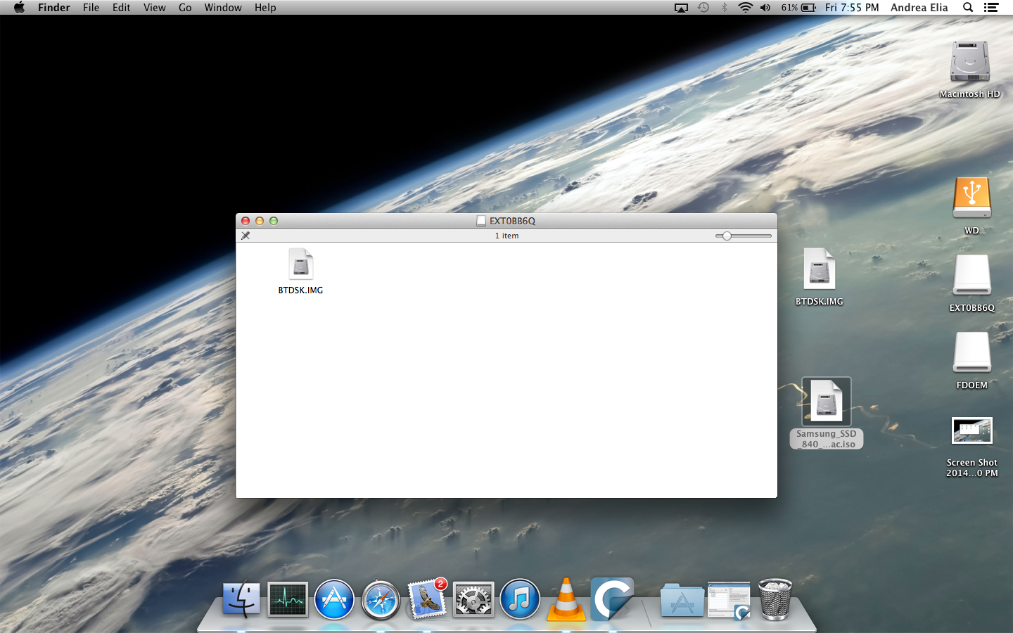

If I mount the IMG file I get more what I expected
I assume I want to use the IMG when making a bootable DVD?

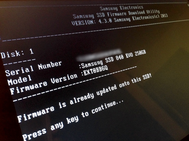

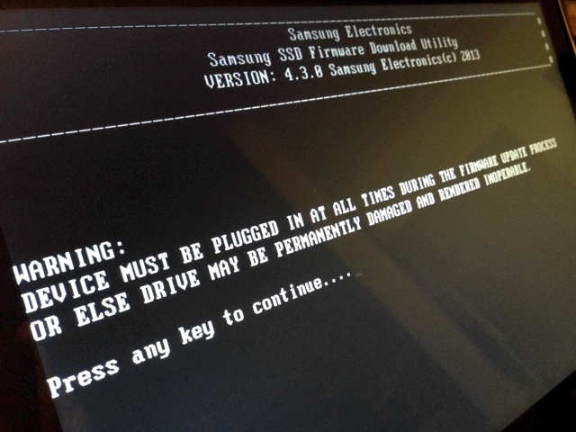

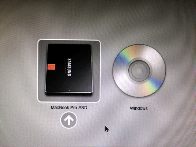

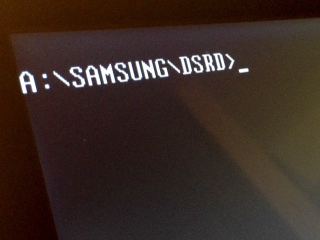

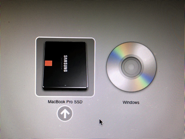

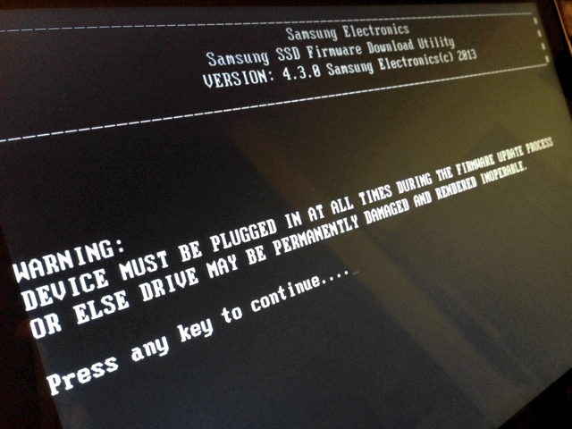

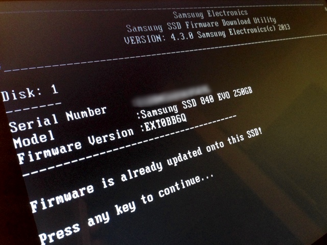

I just checked the one that I used...I think I ran the "PC" one on my MacBook Pro - it generated a disc titled FDOS OEM CD entitled 'isolinux'...if you dig a few more layers deep (there's a few disk images), I eventually come across the MS-DOS-like file structure.
I just went and booted from it - holding down option brings up a disc like any other, and booting throws you into a very straightforward utility - follow the prompts and it updates. Since I already had the firmware, it wouldn't let me do much else. Then, when it was done, it kicks you out to a DOS prompt. From there, I shut down my computer and restarted like normal.
I think what they did here was package an installation of MS/PC-DOS inside a bootable Linux distribution. Either way, it works and isn't horrible.

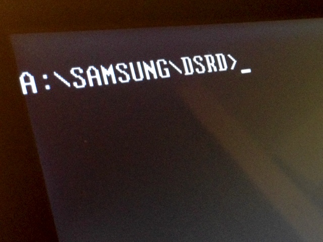

thanks for your help, out of curiosity I tested the first disk I made with that when mounted only showed the IMG file, when I booted off it it gave it the name windows on my boot selection screen, when i ran it it does the DOS utility, it obviously said no SSD found but look like the firmware disc was burned right
how do you exit the dos utility, i just ended up hard powering off, is there a command to type to exit?

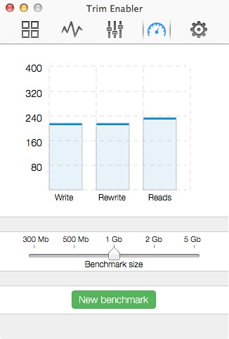

Got a couple of 240GB Crucial M500. I just noticed that the writes wasn't 400MB/s but 230MB/s. 😱

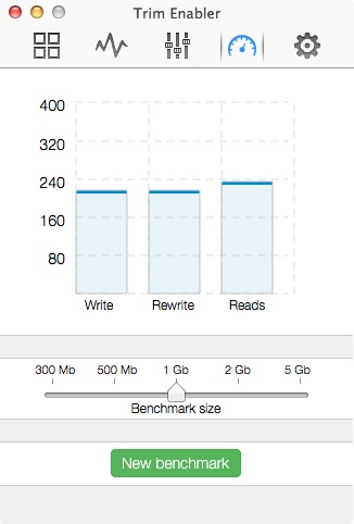

This is the performance I see with the Crucial M500 960GB SSD on a 2009 17" Macbook Pro.
My guess is you have a MacBookPro5,2.
All Macbook Pros from Late 2008-2010 have SATA 3Gb/s (300MB/s) interface.
2011-2013 Macbook Pros without Retina Display have SATA 6Gb/s (600MB/s) interface.

Many thanks. Of course, you are correct. Indeed my machine has a SATA 3Gb/s (300MB/s) interface.

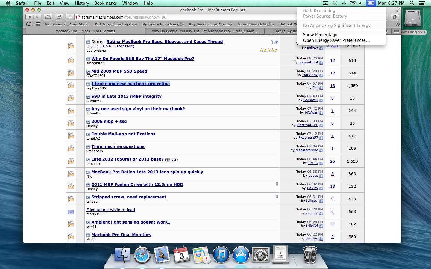

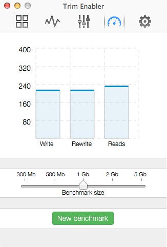

what a difference this SSD is making, boot up is about 10 seconds
battery life shows 8h30m Ive never seen higher than 5h30m
makes me wonder why I took so long so upgrade
