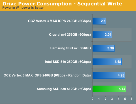

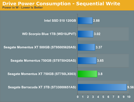

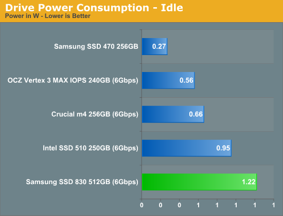

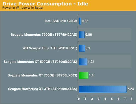

Power consumption is heavily dependent on the controller and NAND configuration. See the graphs below:
Ah, those were the graphs that I was not able to find yesterday.
It's somewhat surprising that the 256 GB intel 510 SSD has three times the idle power consumption and twice the active power consumption of the 120 GB version.
