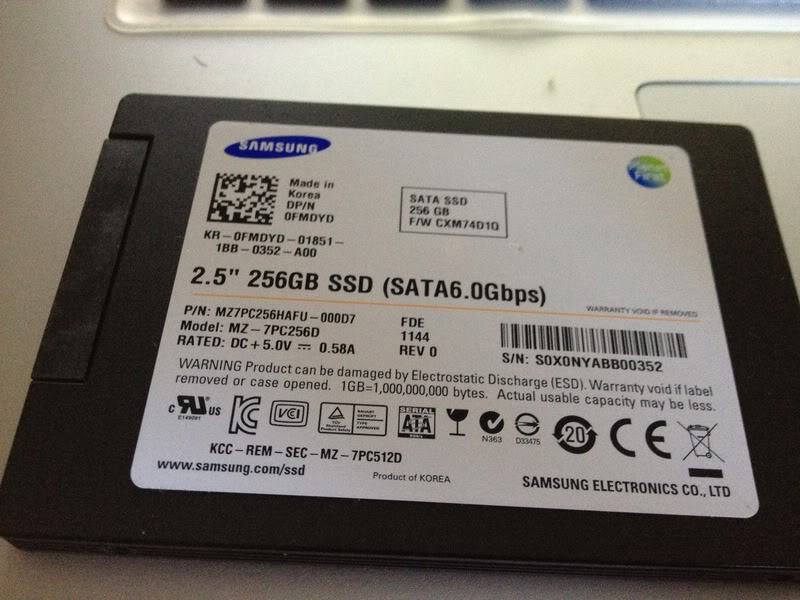

yesterday i bought Samsung 830 256GB. I want to use in MBP early-2011, i put it in the Optibay but when i want to install lion i got error after that i put it in the main hdd bay the lion installer wass fine everything was fine. after that i put it back to optibay and the drive dont boot. mazbe the optibay has something wrong but i van use it with hdd and i used it with ocz vertex 2. or the ssd has issues? i have lastest firmware. thank you and sorry for my english.
and one more question. do i need to enable trim or no?
