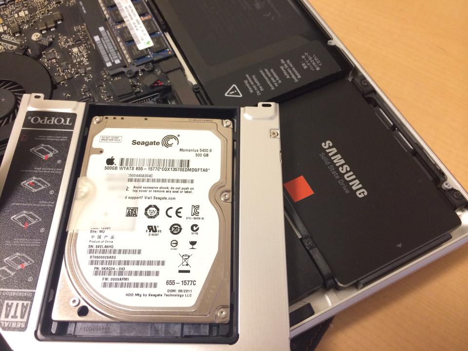

This thread inspired me to upgrade my MBP. I changed my bootup hdd to SSD (128GB) and I removed my CD drive and inserted a hdd caddy and installed the former boot up hdd.
Thank you everyone for the tips.

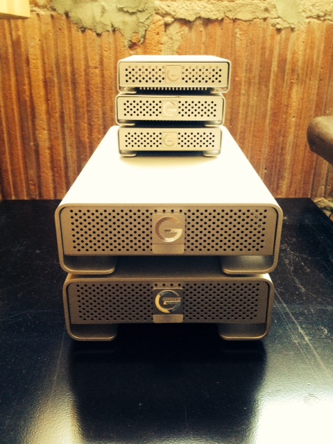

You cannot go wrong with the G Technology drives. I have used them for years and the mini's are durable, travel well and great looking. Here is a shot of my backup system, I pair them up for redundancy and the fifth for Time Machine along with DVD's of RAW files from shoots.
