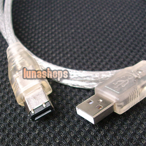

hmm how about a USB to FW400 cable? Does it work then?
