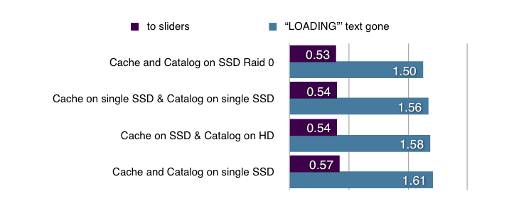

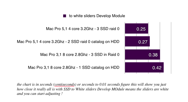

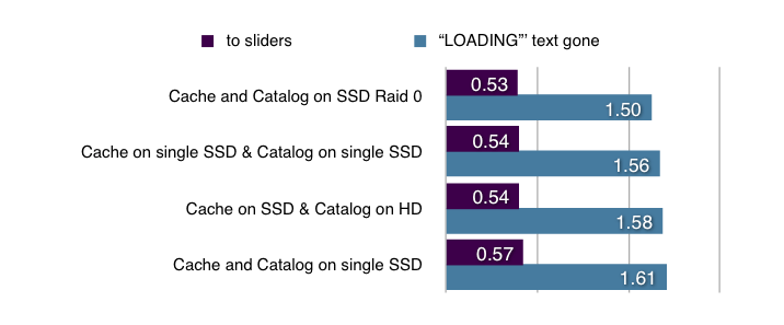

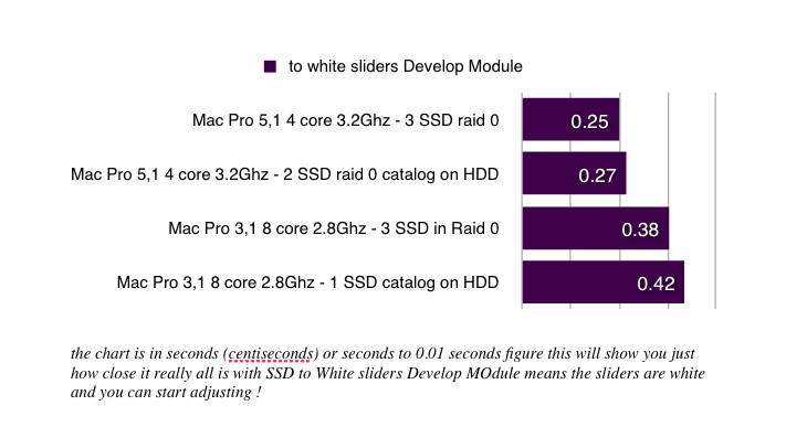

my cache is on 2 40 gigs in raid 0 the catalogs live with the images on my raid
I might post the info here ? but did a huge test with massive configurations and really get the cache on SSD
if you work in Develop module its the standard previews that are used
if you work in Library mode thats the 1:1 previews
if you go back and forth build both !
I would say test it yourself 🙂 I used a movie camera and counted the frames to determine how quick things were
also to note
in one test comparison putting both catalog and cache on a 2 disc raid 0 SSD was quicker than having the cache on one SSD and the catalog on another SSD
also moving the catalog off the raid 0 SSD did not really matter ? again my test was to get through develop module as quick as I could ?
also note using raid 0 the speed increased by about .02 seconds for each SSD in raid 0 ? not much gain
also the second graph was done to try to see how much the new computer helped out ? and I was really shocked to see how much quicker the new machine was over my older 3,1 I did not expect to see that much increase ?
so that .53 of the older chart to my .42 times of the newer chart were after more tweaking configurations and adding more SSD to the boot and such ?
also the times on the 3.2 comparing got quicker on my older machine as I did more testing and found better ways to optimize LR !
I would like to drop say 6 SSD on the Areca controller and see how it does with the cache and catalog and see if that .02 second gain keeps going ?
at least for my workflow and testing the thing to take home is the catalog location is not as critical as the cache ! and the cache on raid 0 is quickest
