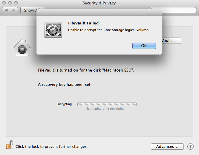

So, I decided to try to encrypt my SSD which is the primary OSX drive installed in the secondary slot (instead of the optical drive).
The FileVault 2 is stuck on Estimating Time Remaining... for 2 days now, so I guess it is not going anywhere.
Any ideas?

Here is a screenshot of what I see:
And here is what happens if I try to turn FileVault off:
After a few restarts, the FileVault is again showing that it is disabled!
