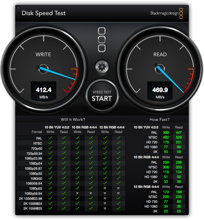

I picked up one of the Crucial M500 960GB drives when they were on holiday sales for $430. It is working great in my Mac Mini and here are the test results for it:
-howard

Very Nice - Bet the Mini is feelin' good 😉

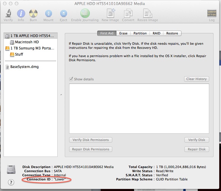

Thanks - that really helps. Only question now is how do you know which bay that sata cable supports? I believe there are two different cables and it depends which logic board connection is currently in use as to which one you will need.
Not 100% sure on that one. Thats the 1st iv heard of that particular issue. What I read was regarding the difficulty of completing the task to where the current drives are placed. Eg if its in the *lower* slot ur supposedly all set to go and its much easier but if its listed as *Upper* its more complicated to complete.
Mine says Lower so hopefully its not gonna be a problem. This is the screen shot of where the info is in Disk Utility:
-howard
Wow that looks mighty impressive!! Good for u man! I know I'm not gonna get quite that good write speeds coz I went with the 120 but jezo nice to see it making a difference!

Same here! I put one in my 2010 Mac Pro, one in the new 2012 15' MBP I bought in November and one in the new 2012 mini I ordered last month. They've been working really great.
The first two came with firmware rev2 and had to be updated in Windows. Fortunately the Mac Pro has a Windows 8.1 boot drive. It performed the updates perfectly without screwing up the Mavericks installs. The last M500 came with firmware rev3.
Yup, mine is in the lower drive as well. A word of caution, this is what the customer service rep told me when I emailed them earlier today. Since I emailed them and before I got a reply, I found the user instructions on their site which implied the cable is for the upper bay but the customer rep says otherwise. With regards to ease, if it is the lower drive and you are just replacing the stock drive then it is a simple process but adding a second drive regardless is more involved as you need to remove the logic board.
Customer rep reply:
"Thank you for your message. The SATA cable in our iFixit Mac Mini Dual Hard Drive Kit will enable you to add a second drive in the lower drive bay of the Mac Mini as the built-in drive sits in the upper bay 99.9 percent of the time. So the SATA cable that comes with the kit is not universal.
