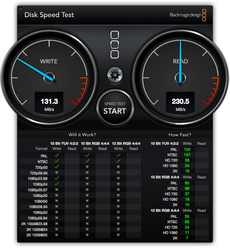

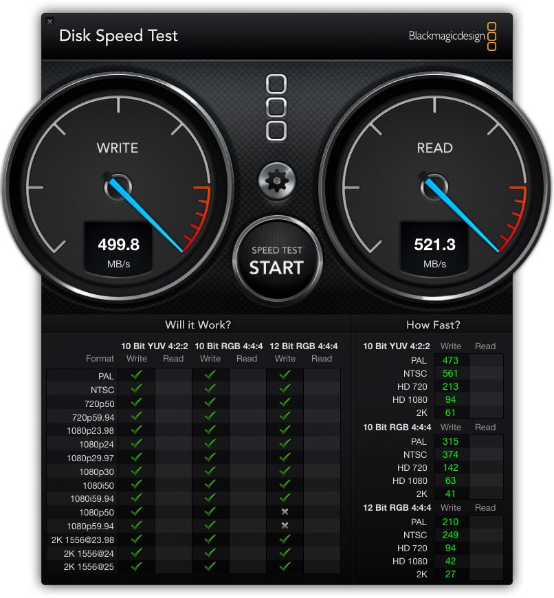

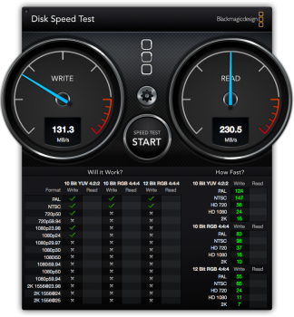

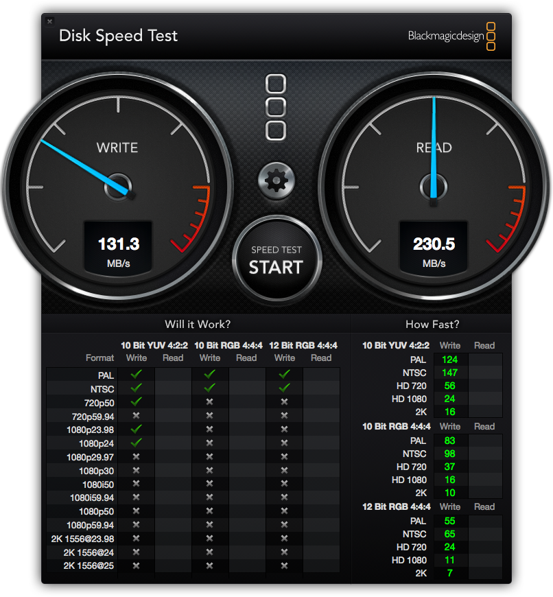

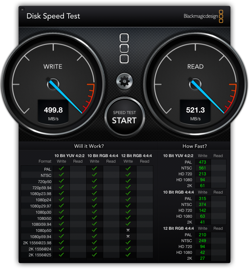

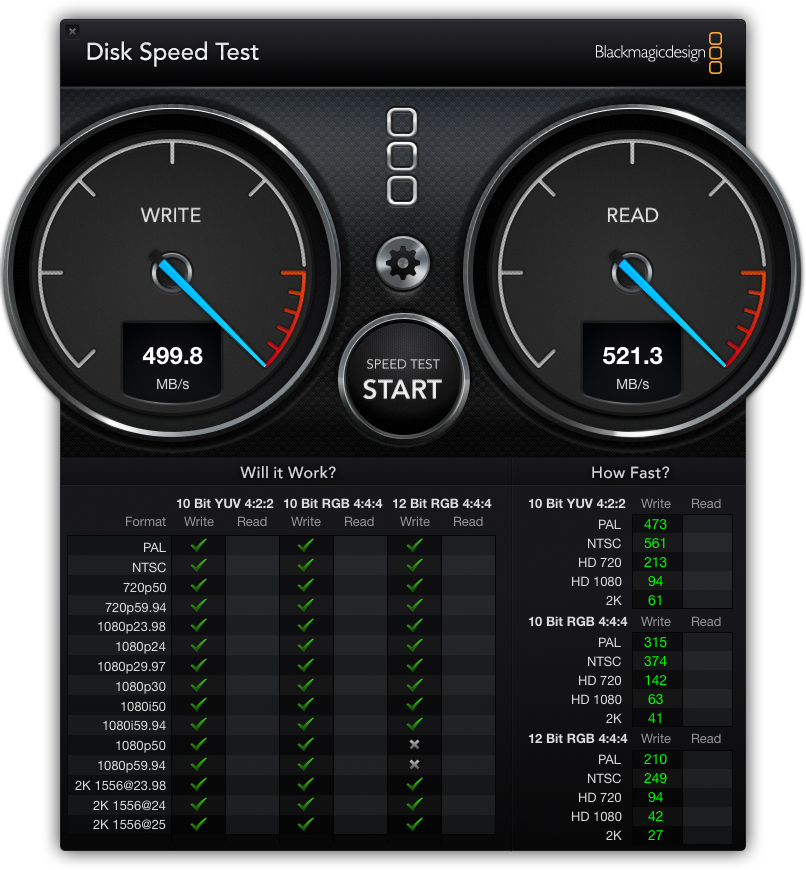

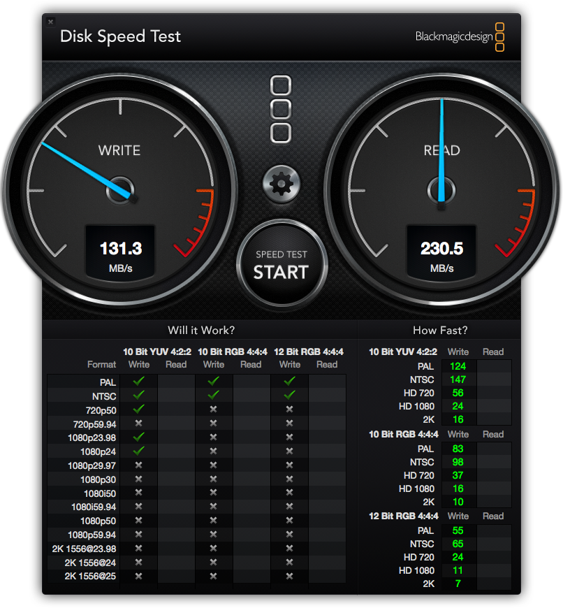

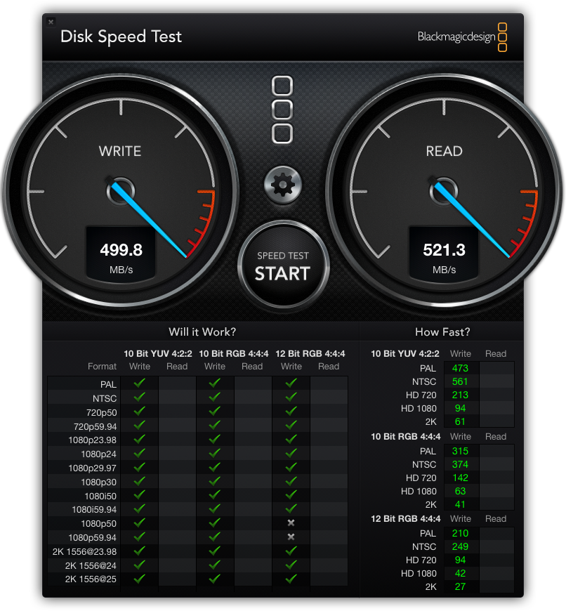

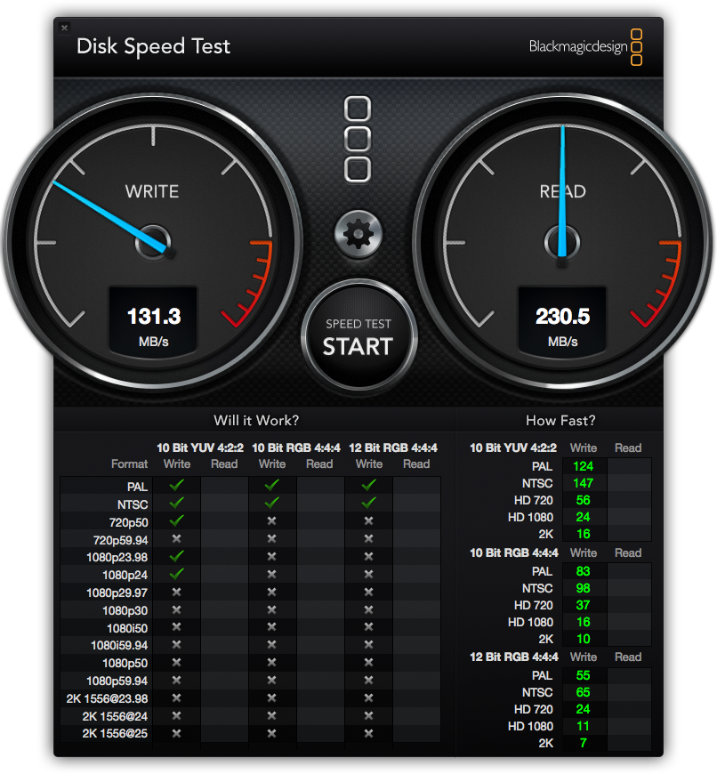

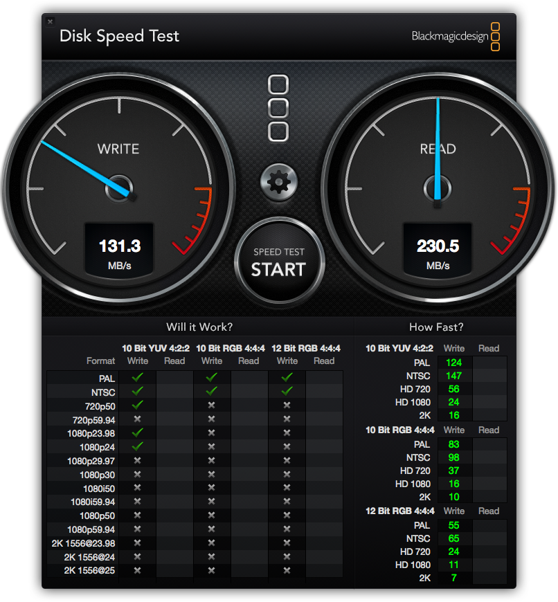

Here's the results, judge for yourself...
1st is the original 120 GB SSD, 2nd is 2 SSD's in a raid0
1st is the orginal 120 GB HDD 2nd is the SSD's
View attachment 681374 View attachment 681375

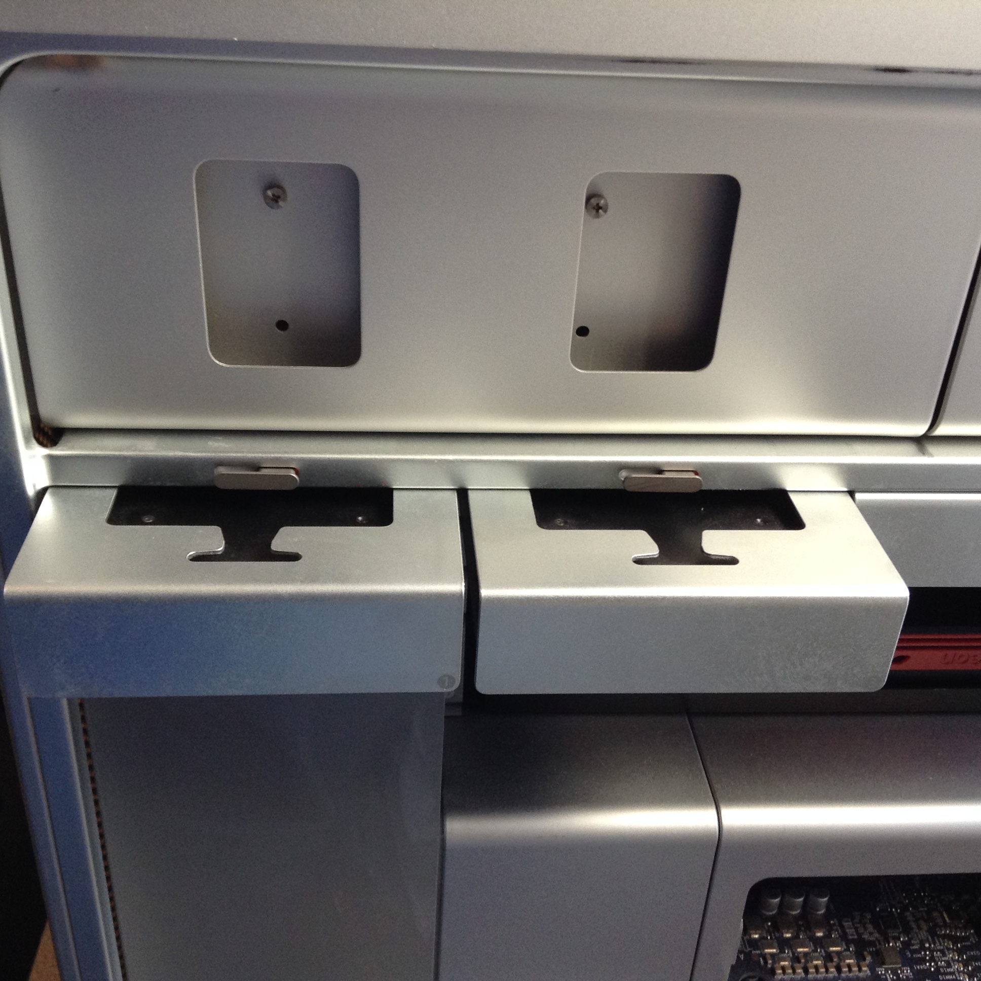

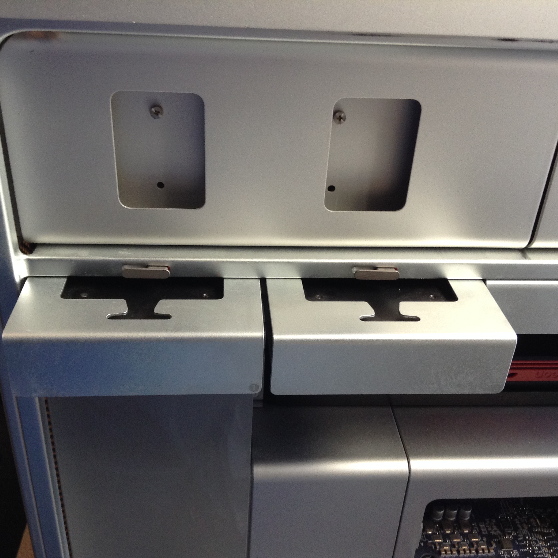

I took a hint on here and moved the optical drive down to the lower bay, so that it could act as a support for an SSD connected to the top bay connector. Cost zero, and no HD bay used.
Stuart
OWC Mercury EXTREME Pro 6G SSD fused with a 640GB WD 3.5" drive giving me a 760GB Fusion Boot Drive on my old 3,1. While the SATA bus is 3G, the 6G SSD is a bit of an overkill... but then getting slower SSD is next to impossible now.
In any event, with 26GB of 800MHz RAM, my Mac boots to the login screen from a dead stop in about 15 seconds and is far faster loading programs than the 2014 Mini I use at work.
The SSD is in an adapter to make it conform to the 3.5" drive slots. These adapters are a dime a dozen these days and i suspect any 2.5 to 3.5 drive adapter would work.

The benchmark program is "Black Magic"
and my SSD results are from 2 samsung SSDs in a raid0 configuration, this is about the fastest you will get on these older Mac Pros Sata2 bus.

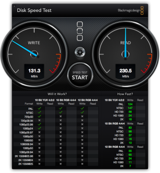

wow - my black magic speed test results are pretty poor - if I'm using the program correctly - I get about 50-60 MB/s read and about 45-50 MB/s write. much less than it should be ... even for traditional spinning drives.
I'm sorry, but I'm skeptical about the RAID result. This would be in a PCI card, I presume, and not two drives in two normal drive bays? Otherwise, I don't see how you are getting such a dramatic (more than 2x) performance increase - that should not be possible.
For the OP: A typical upgrade scenario from normal drive bays would be a PCI-E card. One popular choice has been the "Apricorn Velocity X2" or the "Duo" version (not X1, which is slower). The former holds a single drive, while the latter holds two. They are rather expensive, though, but they could, with fast SSD's, provide up to around 3-4x the speed of a single drive in a single normal drive sled.
I do NOT recommend running RAID 0 for SSDs on one of those cards. Twice the likelihood of everything crashing, and in these systems the modest additional improvement in speed (maybe 50% max) is not worth it. Indeed, it turned out to be a big headache for me and I switched to non-RAID drives with perfectly fine speeds. Beyond some level, it becomes harder to detect subjective improvements other than by using a utility anyway.

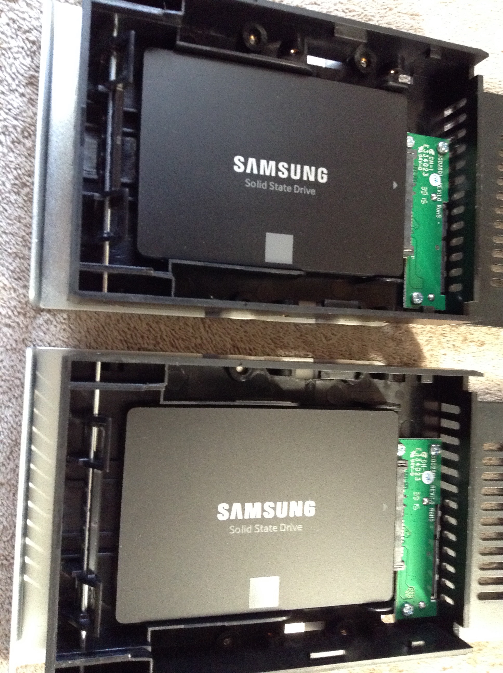

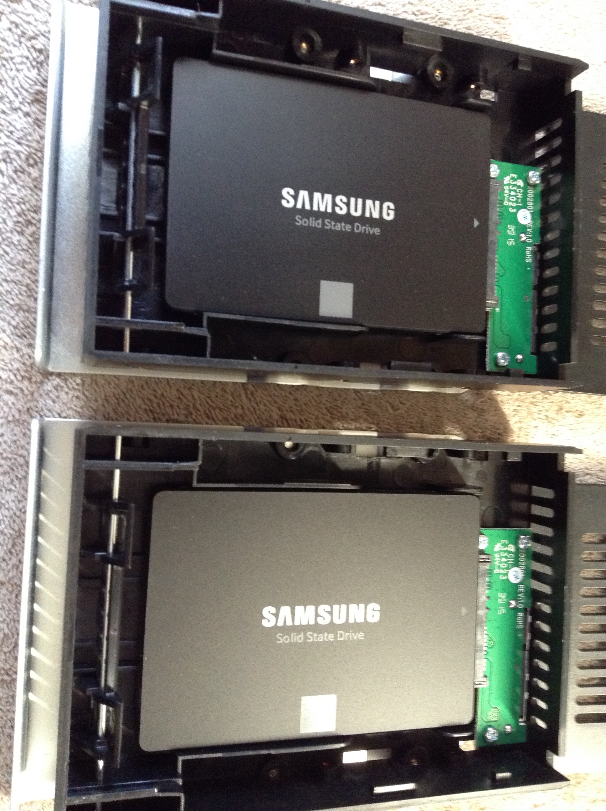

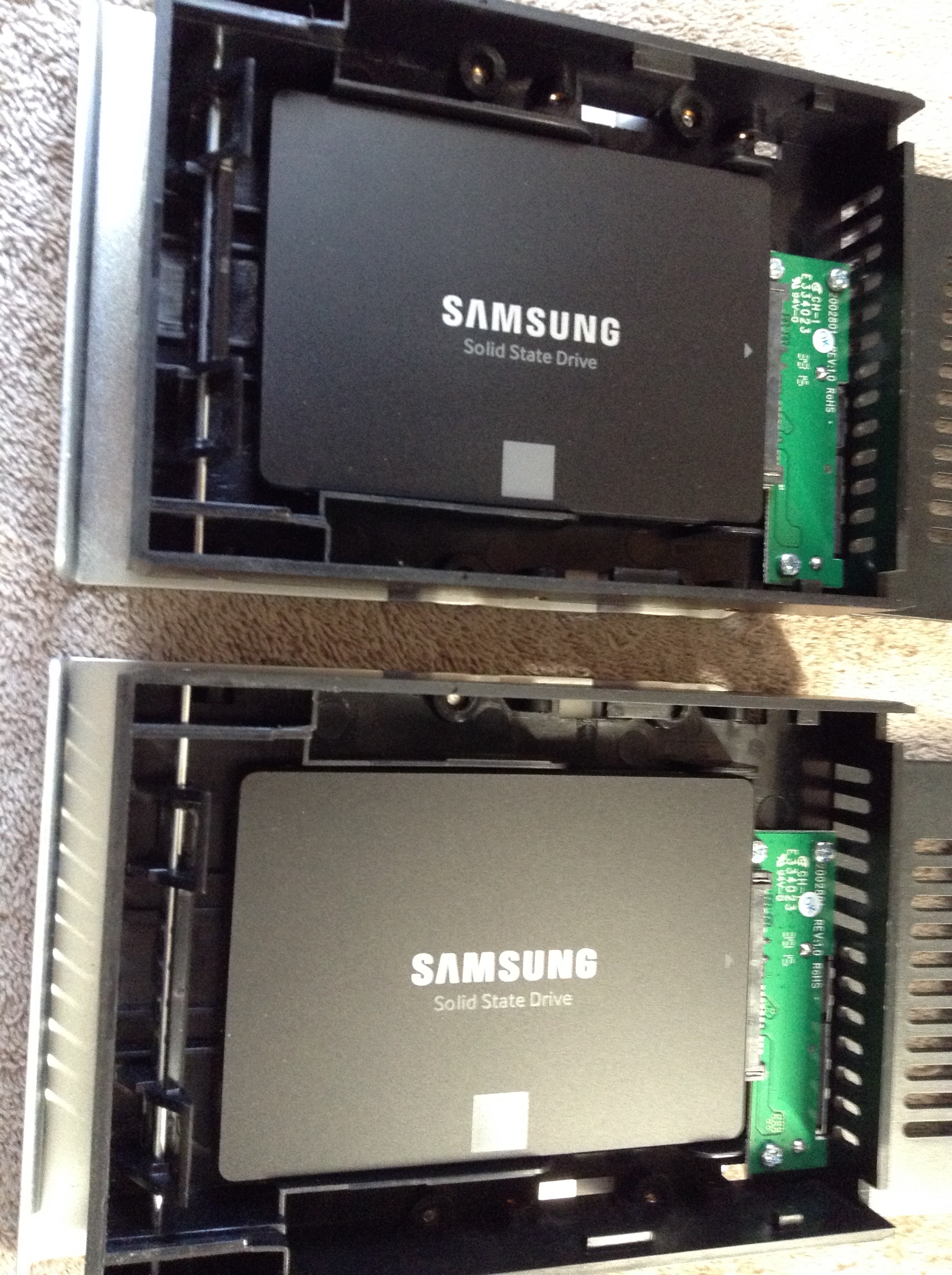

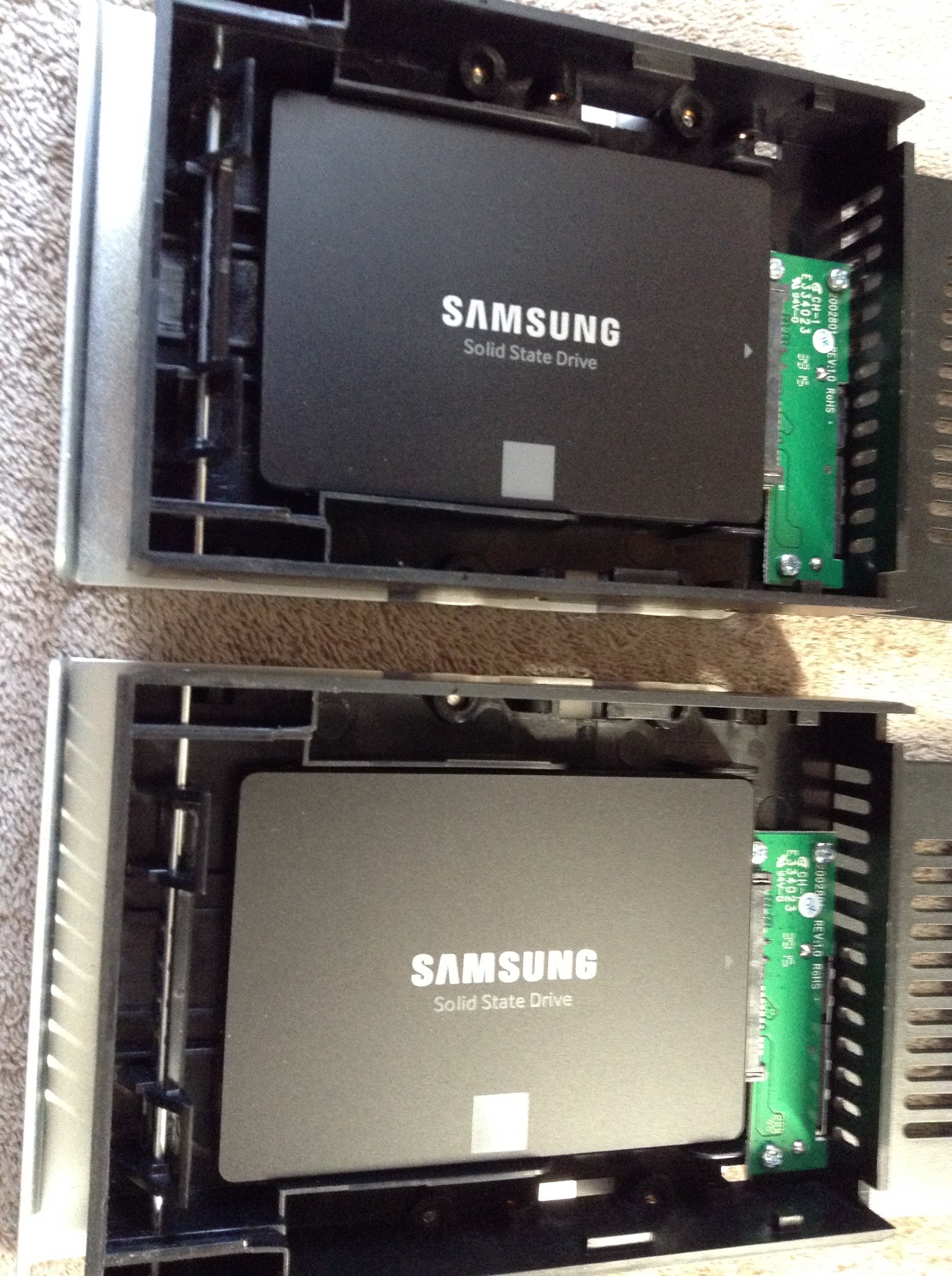

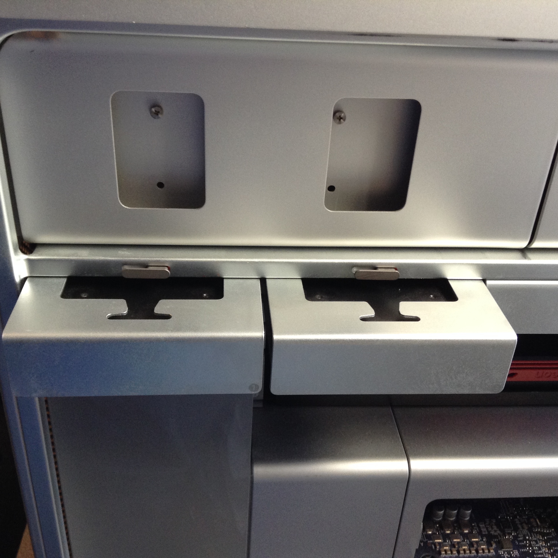

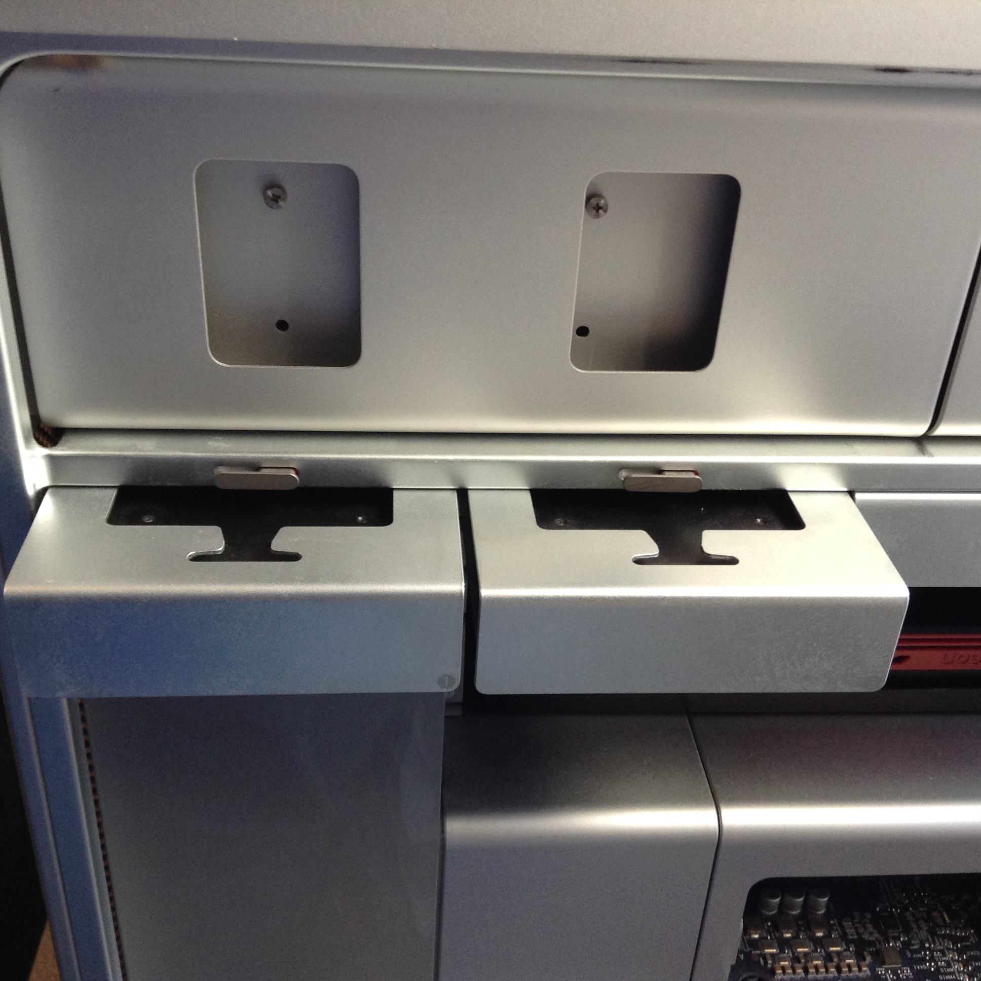

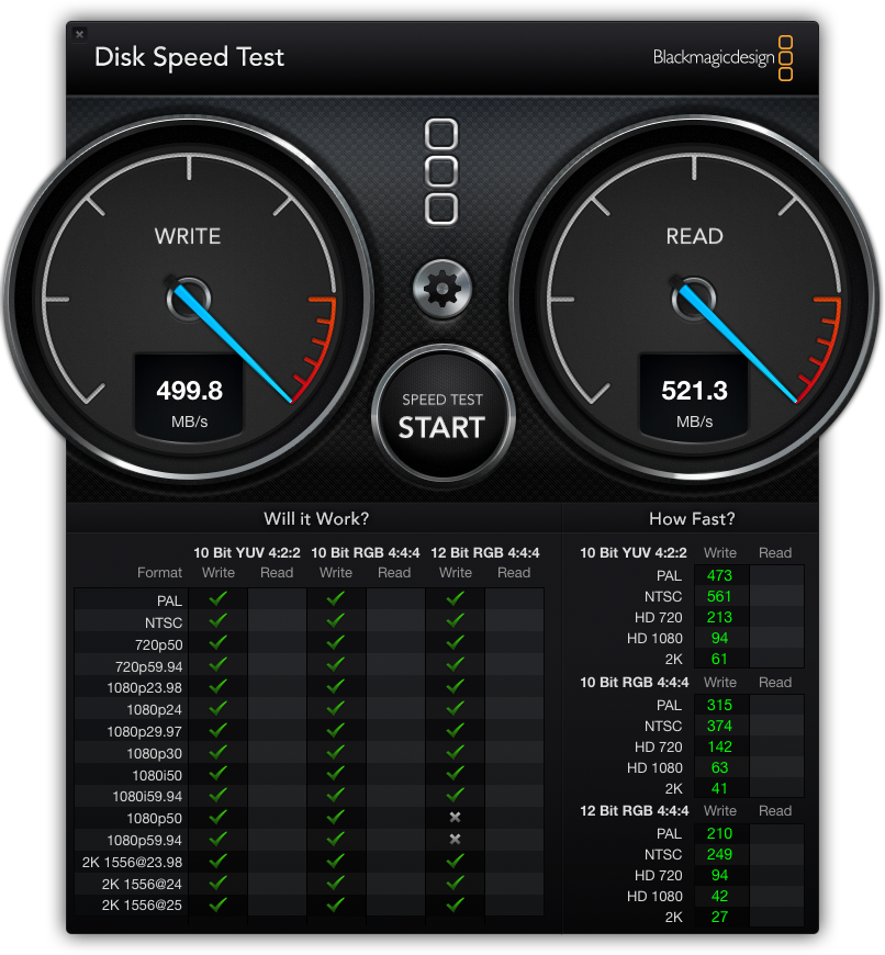

I really sorry that you find it necessary to doubt my integrity.

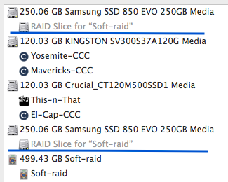

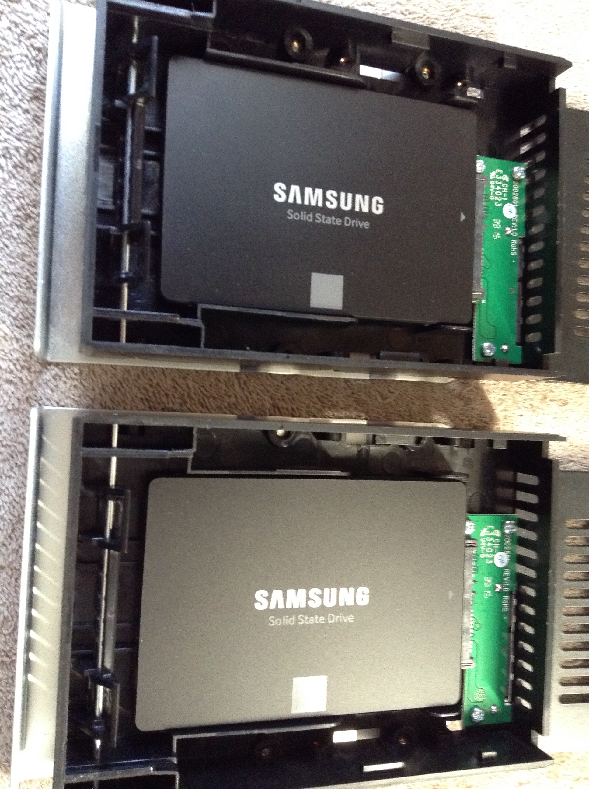

In an effort to try and put your mind to rest I shut down my system, removed the two drives in question and took some photos.
The 2 Samsung SSDs, just as I said are mounted in icy dock adapters installed in Bays 1 and 2 of my 2006 MacPro1,1 as seen in the attached photos.
They are configured as a raid0 using Apple raid software as shown in the photo from Disk Utility.
Other then this I cannot and do not feel the need to further justify my posts to you.

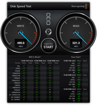

View attachment 681423 View attachment 681424
I was not doubting your integrity, just wondering how the result was achieved, in particular whether it was in sleds vs. on a PCI card, which I didn't see you state (I guess I missed it from an earlier post).
Frankly, I still wonder how it's possible to get up to triple the speeds from 2 disks in Raid 0 vs. one of the same disks. It doesn't sound theoretically possible. But again, I'm not attacking your integrity.
Not the same disks, the 2 SSDs in raid0 Are 250GB SamSung 850 evos and the single was an older 120GB Crucial.
Ah, that explains it. My "300 MB/s" result, in RAID, was also from older, slower disks. I'm not sure I tried my Samsungs in trays. With those speeds, I might not have bothered spending the money on the Apricorn card (which gives me something like 450 MB/s read/write with a single disk, topping out somewhere around 600 in RAID).
