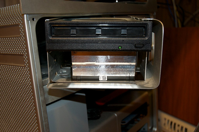

I stuck both of mine in the secondary optical bay and used a 4-pin to twin-SATA power cable to power them. I plugged them into the two ODD SATA ports and affixed them to the bottom of the carrier with metal tape.
That whole area of my Pro is modified a bit though as I previously had two rotational disks there which could only fit with the center stud that catches the carrier removed.

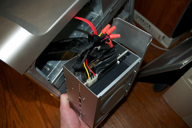

I don't have any photos of the SSD upgrade but here's the previous setup with two rotational disks to give an idea how it works...
I made a power adaptor for the previous setup but when I replaced the SATA disk with two SSDs I used a 4-pin to twin-SATA cable so I could get rid of this:
