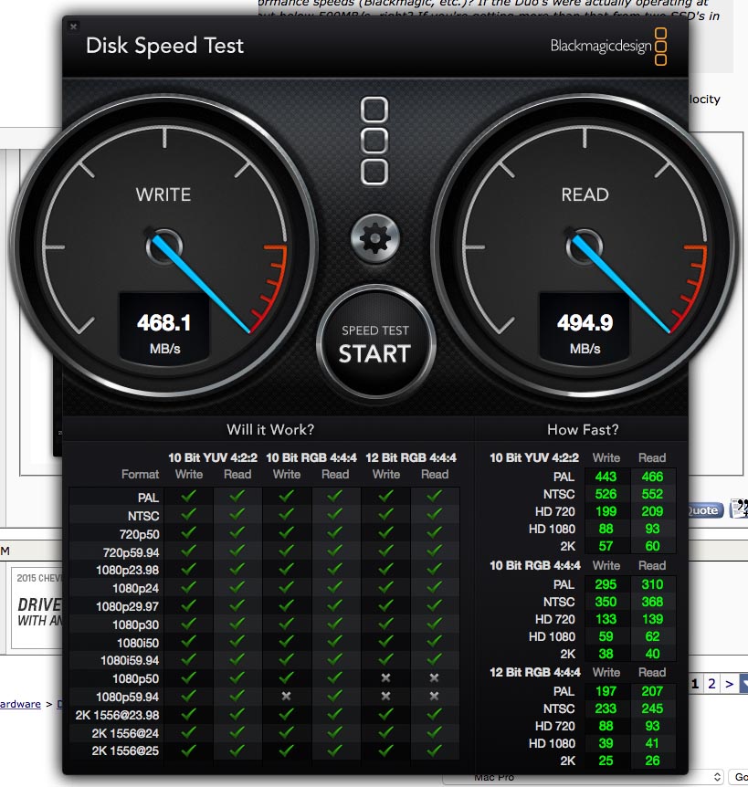

^^^^My Mac is a 2010 5,1 DP Mac Pro that I have upgraded to X5677 CPUs. The specifications of the PCIe slots is the same in a 4,1 or 5,1 Mac Pro. And yes, slots 3 and 4 share bandwidth. My boot drive is on the card in slot 3 and I have not found bandwidth sharing to be an issue. My boot drive is an 840 Pro.
See attached.
Lou
