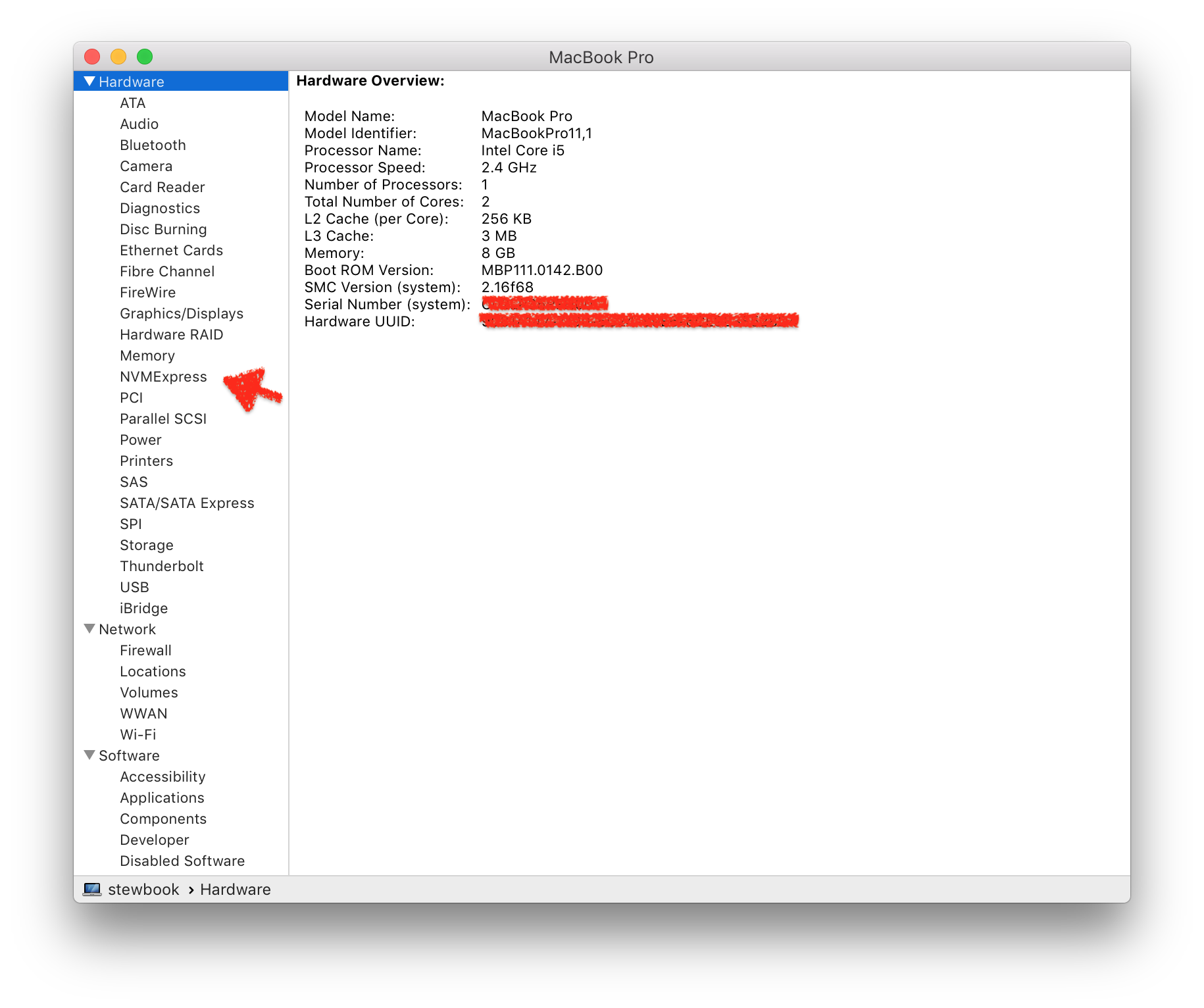

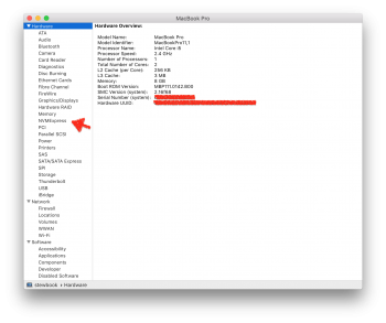

I'm surprised OWC didn't advise you to install High Sierra first (you could have installed it onto an external drive, the point is to get the firmware update flashed to the system). As they say the Aura X is High Sierra-only; I guess they assume anyone installing one will already have a fully updated system. Almost certain that's why it didn't work for you.
[doublepost=1509585518][/doublepost]If you've updated to High Sierra you'll note NVMe is now supported under System Information. I believe APFS was designed with this newer standard in mind.
