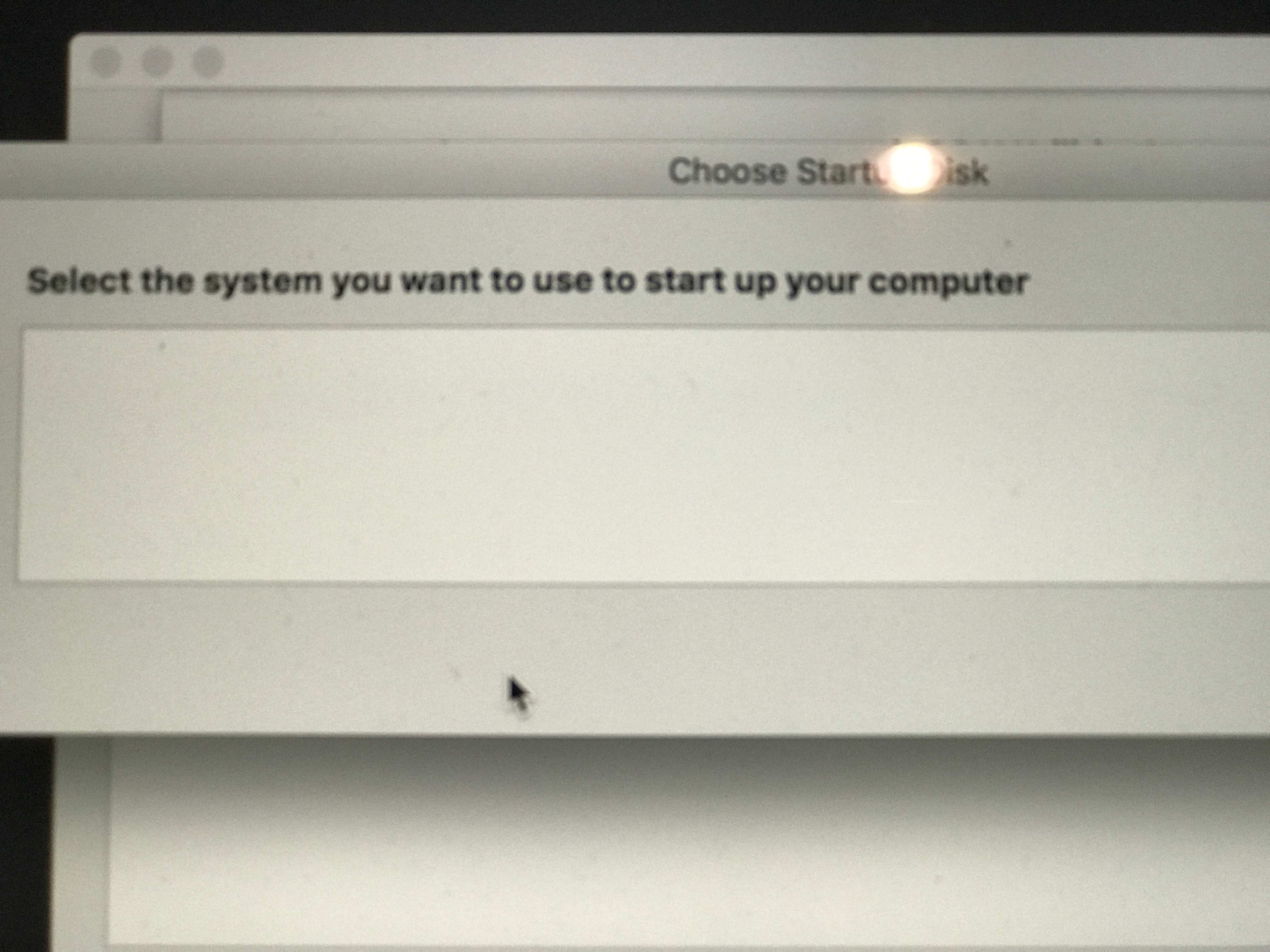

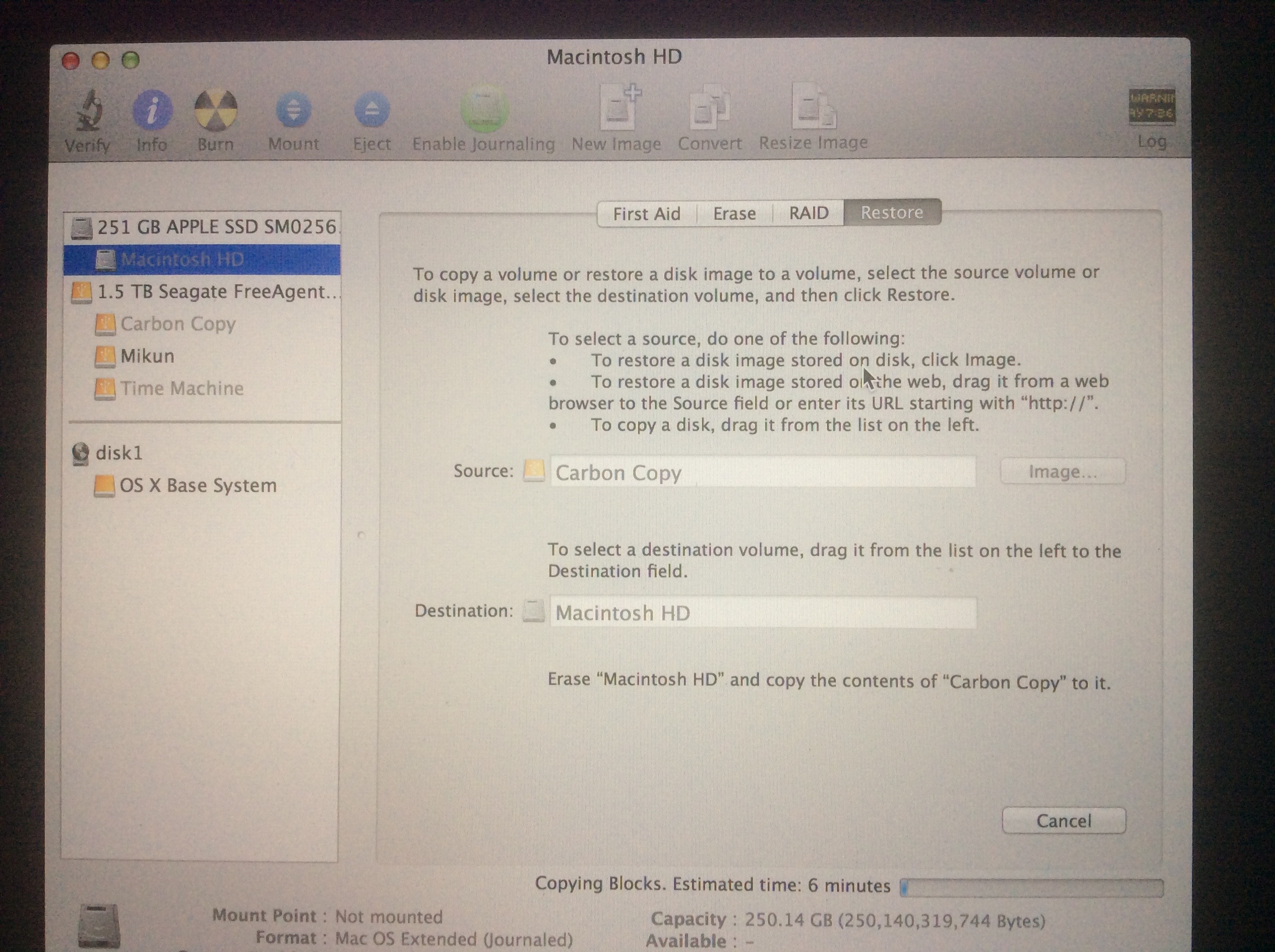

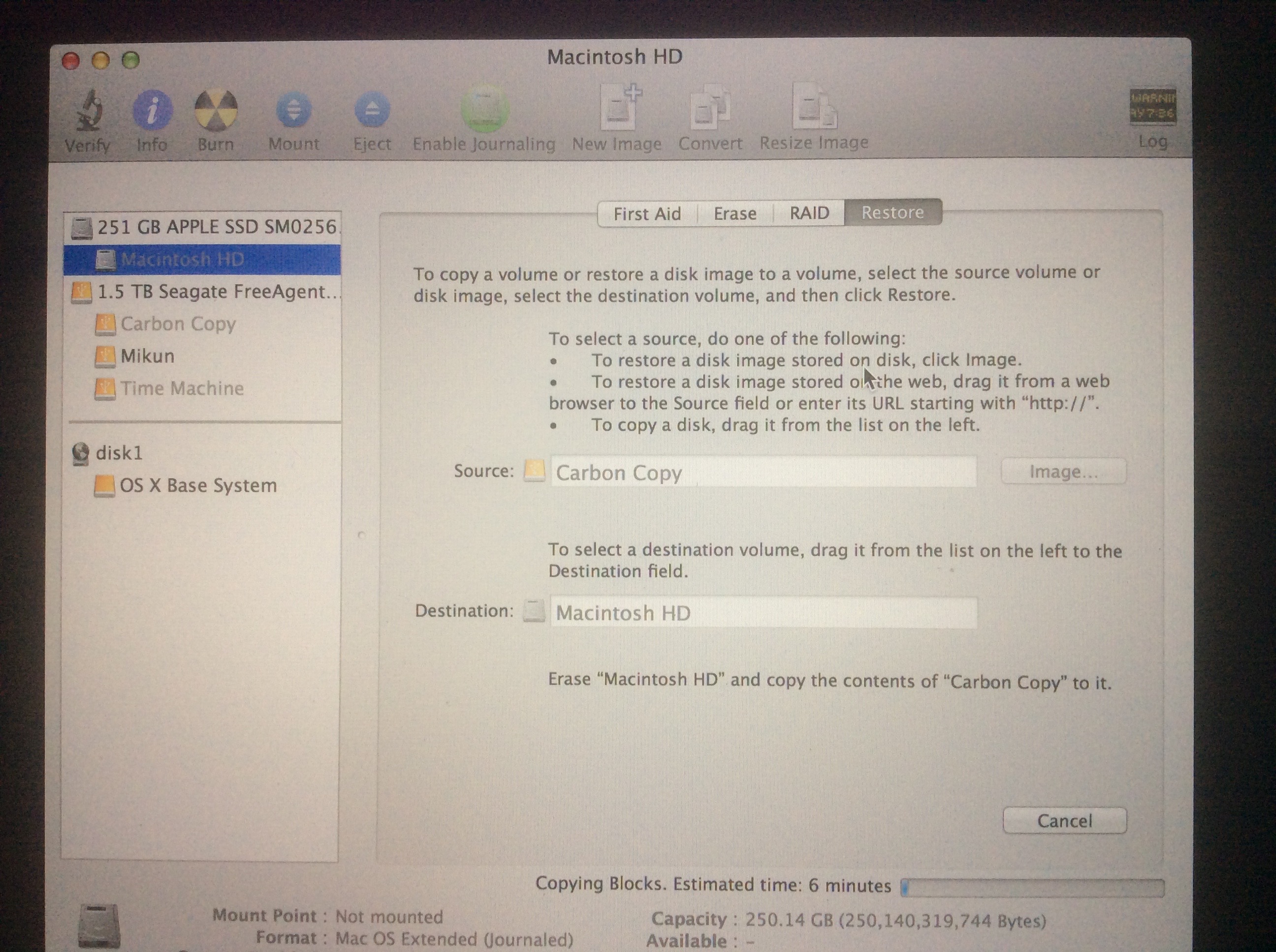

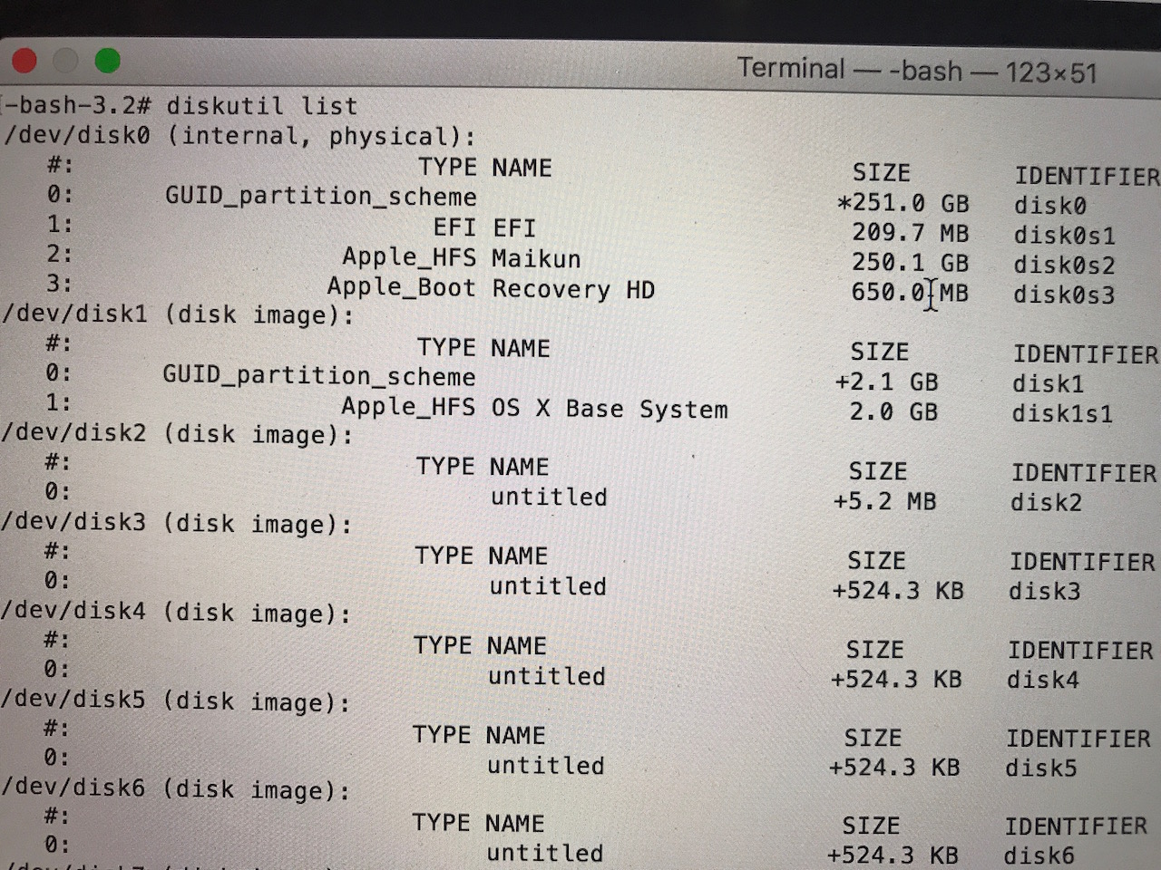

[doublepost=1525584963][/doublepost]Here is a photo of when I was in CMD-R.
The section in the drive you see labeled as Carbon Copy if NOT Carbon Copy application. It was a partition on a large drive that I was going to install CC on, just never got around to it.
Instead I installed El Capitan from internet recovery in that partition and used it externally until I could sort out what to do.
Then, using what you see in the photo I simply transferred from the external drive partition to the MBP SSD internal drive... and it worked for quite a while...then started acting up when I plugged in external drive to use TM.
Strangely now it is working. I am afraid to try anything heavy use as it might freeze up and I have to start all over, but for now I am able to do many functions.

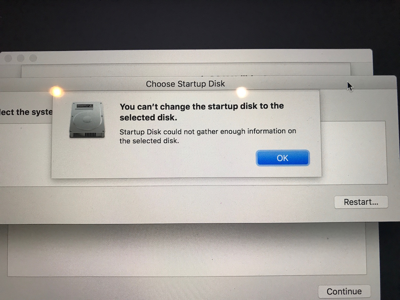

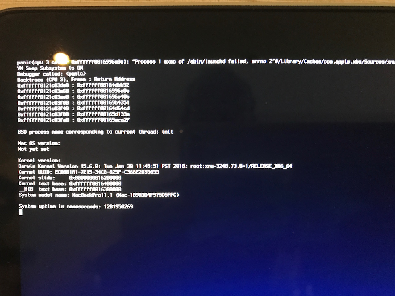

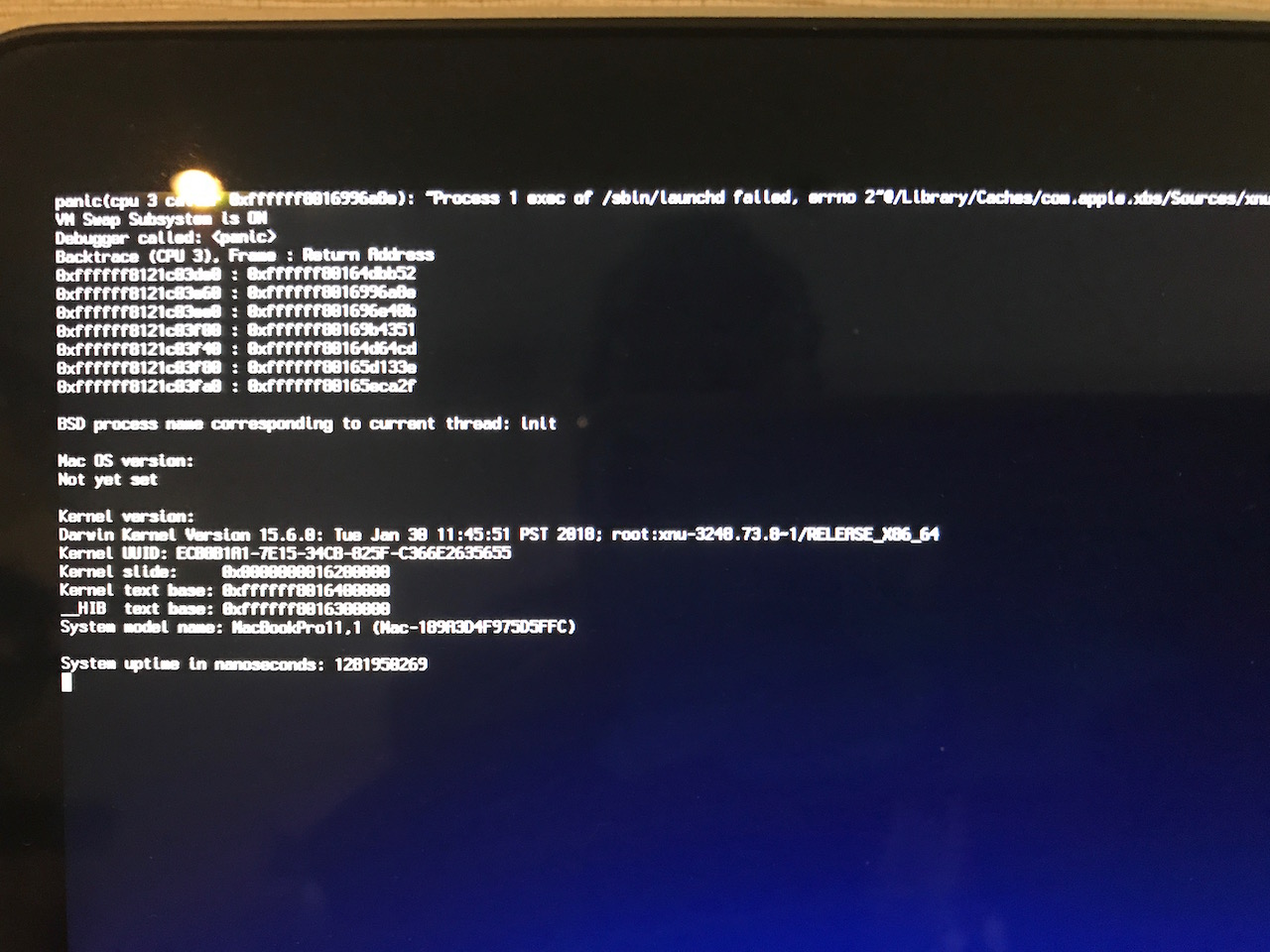

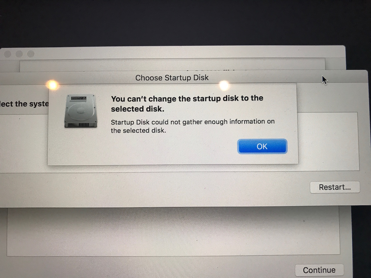

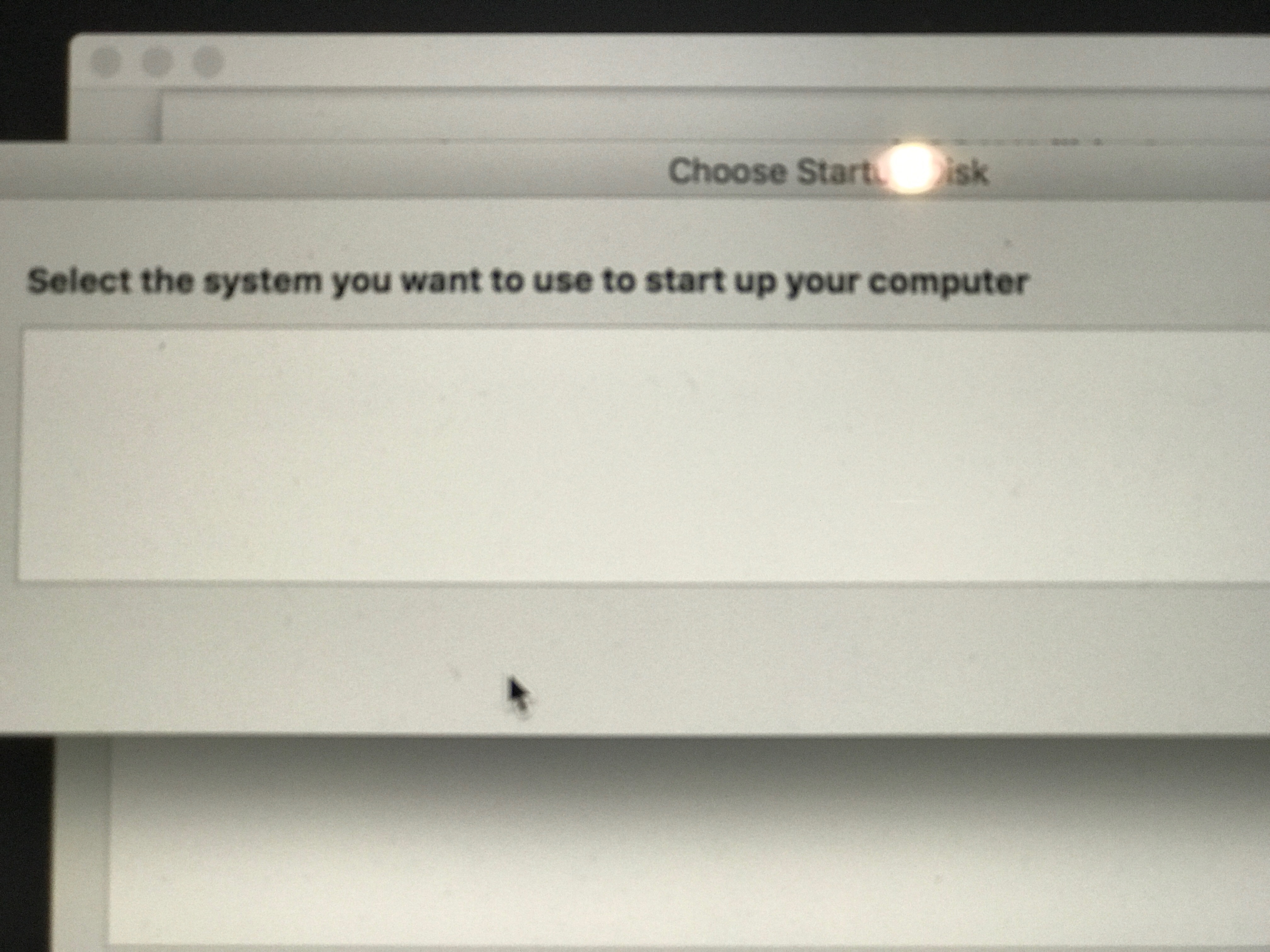

[doublepost=1525585279][/doublepost]Here are a bunch of random photos I took during this process.
[doublepost=1525585524][/doublepost]At the beginning of this, I was trying to install El Capitan on the MBP internal drive and received this screen. The drive was not showing up I think is what was happening. Possibly something I did wrong, not sure.
After doing CMD-R and first aid, at some point it showed back up.
