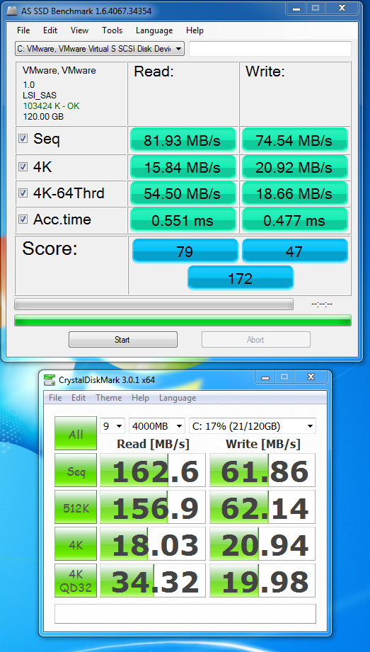

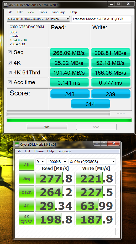

Here are couple of tests of a Crucial C300 256GB SSD.
The 1st benchmark was done under a windows 7 pc in SATA mode.

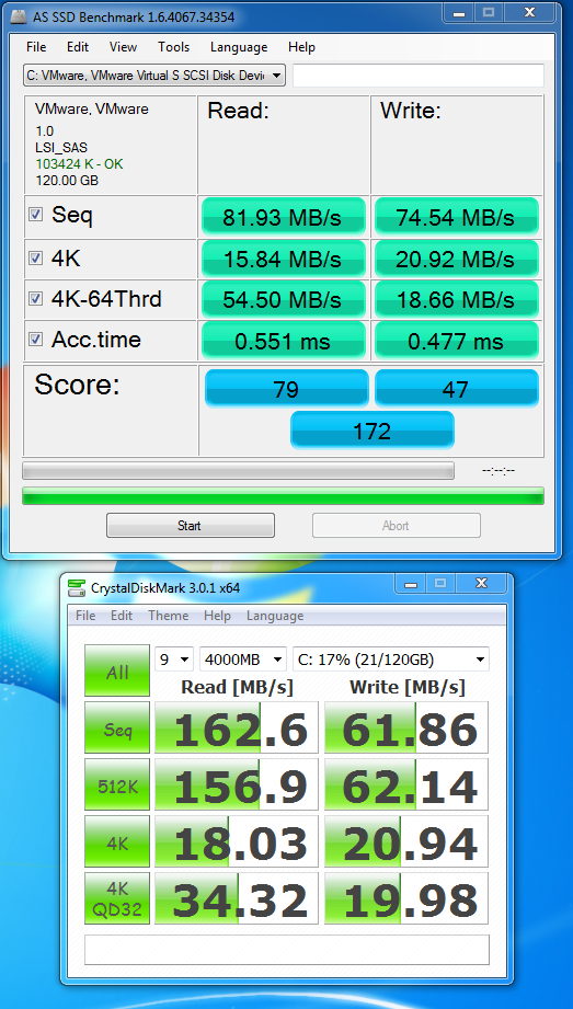

The 2nd benchmark was done under iMac VMware in Fireware 800 mode.
The whole system feels very snappy, also OSX and Windows 7 in VMware starts up very fast.
The only problems are Bootcamp would not install on an external drive and the beach ball appears at the beginning and end of a download.

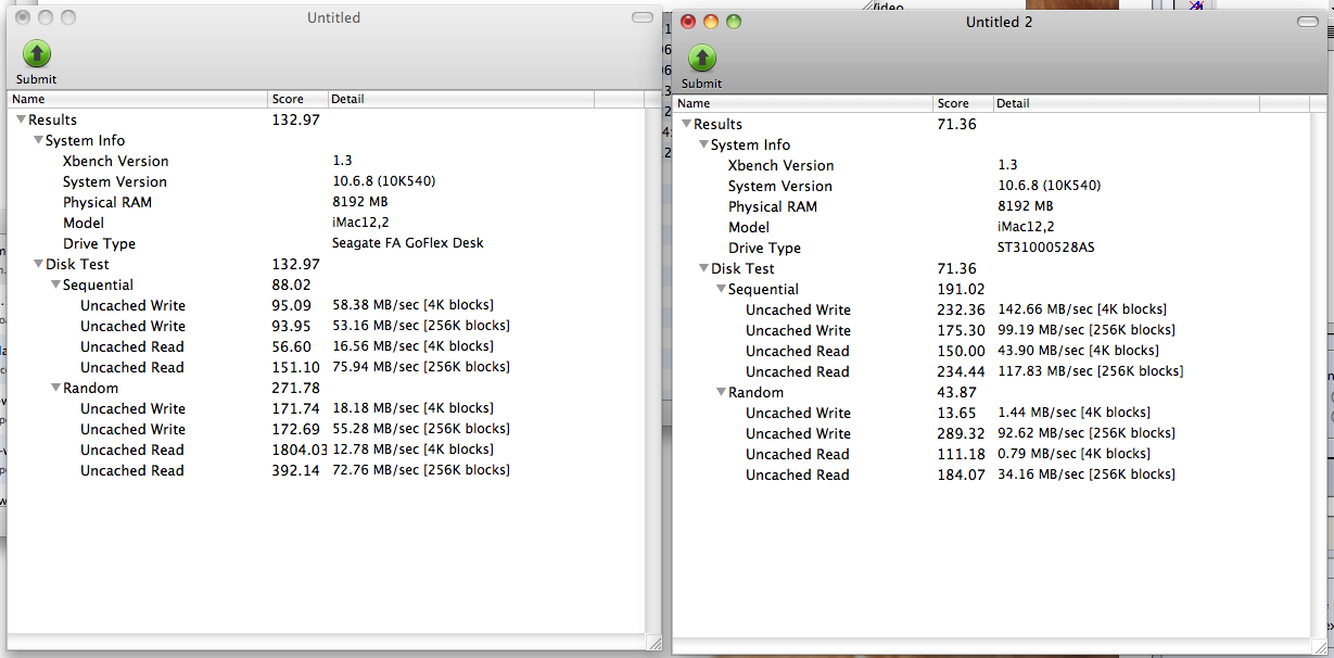

Here is the XBench scores. The left image shows SSD scores and the right image shows the default 1TB HD.

Have you timed the bootup speed on the seagate and compared it to the ssd?
So what do the experts think, how does these results translate into the daily feel of working with an ssd....i'm thinking the 4k and others are greatly improved, whereas other tests are a lot slower. Is it worth it....until we wait for TB?
