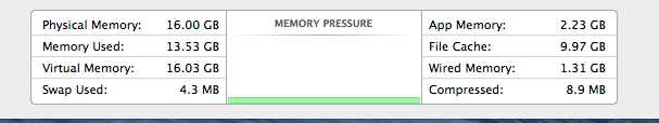

Just checked that out and with no other programs opened, I'm using 13+ GB with "kernal_task" being the biggest user. Now what to do? One question leads to a hundred.
its kind of hard to explain easily but for all basic intents and purposes you can ignore the "memory used" part. if you look carefully, you'll see that all the numbers listed on the right column add up to 13.52 gb... just shy of the 15.3 showing used. OSX uses a variety of cacheing mechanisms to ensure that it has what it needs to get things done, so what you're seeing there is basically the system "reserving" space for tasks (for example file cache in right column) which it will happily give up if the system demands it. Older versions of OSX activity monitor used to call this "Inactive Memory" - showing as reserved but not actually being used. I remember in older OSX like Lion I used to have to force purge this quite often as it was very grabby about memory - something they have greatly improved since then.
the statistic you want to be looking at is the "memory pressure" along with "Swap Used" - and as you said you have nothing running, 4.3mb is probably about normal for that configuration. the best way to really check on that usage is to tab over to Activity Monitor after you've been working for a while in PS and LR and see what those two statistics are telling you.

@glip 4.3mb swap used is fine, kwikdeth linked a relay nice article on it im reading it now 😀 got to say im a tad out of date on this
i think i may have been pushing scratch disc to hard :S i suspect CPU might be the best gain in speed and looks like your ram is fine.
